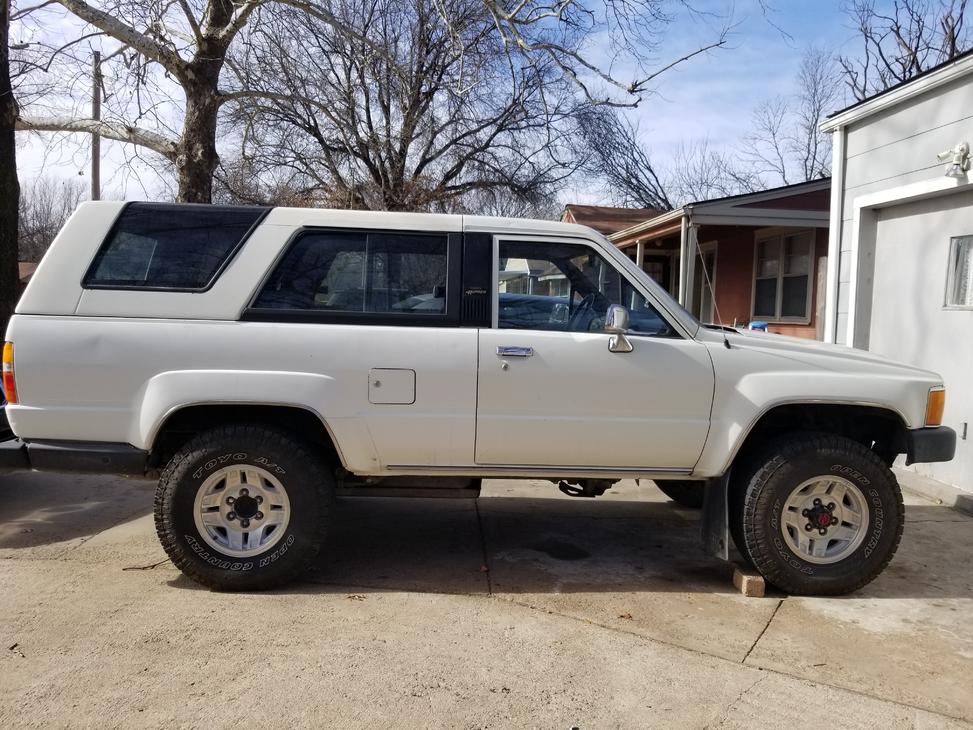

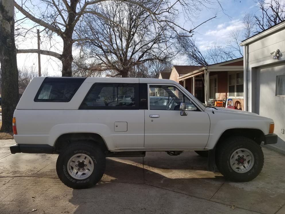

new lift
Followed Joeynational and got me some moog 81043 off amazon. Raised it up pretty high straight from the box. I cut off about 1 1/2 coil off and were sitting pretty good.

...Moog springs from Walmart of all places for $30....

Is it $30 EACH or for the pair?
Is it the one with bigger ID on one end and smaller ID on the other?
Websites say pics are "not actual image of actual parts"
I'd like my rear to be a little bit higher like how Joey National's look s^^^.
Have they settled at all? What are you measurements now? May I ask for rim to lip of wheel-well measurement so it is independent of tire size?
Thanks, guys!
$30 for the pair
Yes to smaller and bigger ends
I paired mine with a "1.5 ball joint spacer in the front and was about perfect. Since then it has settled some but i have not measured. But you can tell the front is slightly higher. I will adjust my torsions to compensate. I can get you some measurements tomorrow
