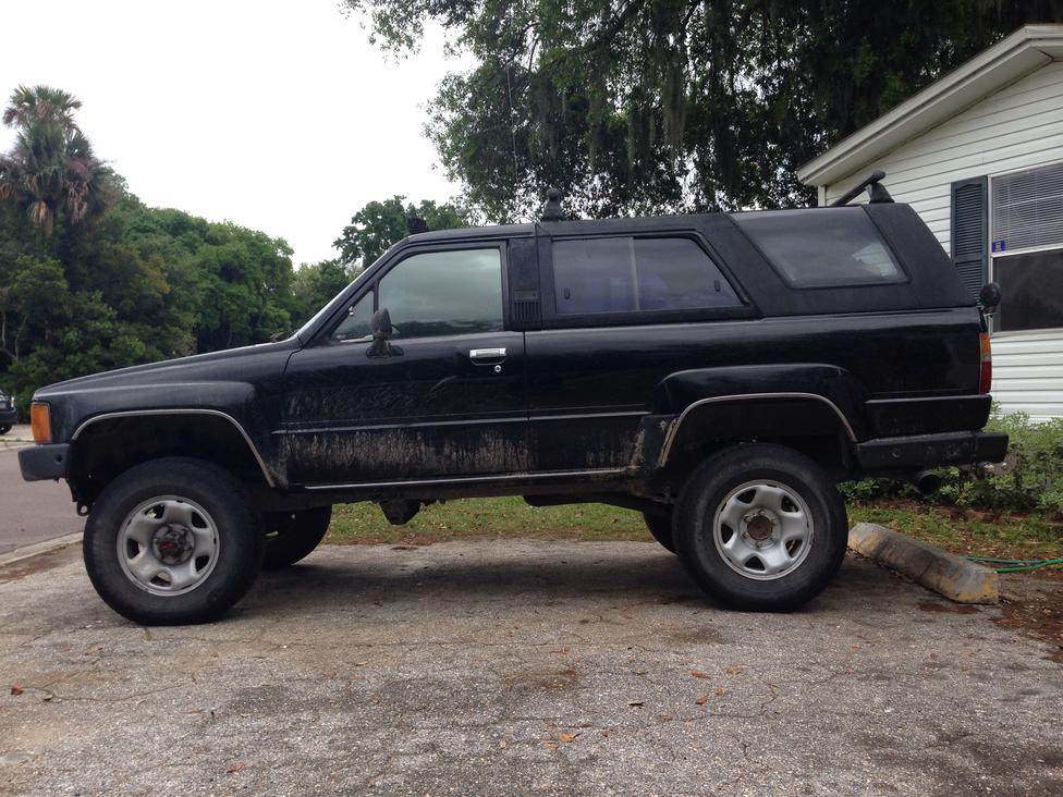

Just did the no cut ZUK on my '89 yesterday. Since I dont have a lift of my own I used an auto skills center. The mechanic there was utterly confused when I told him what I was doing. "Well I've been working on Toyotas forever and I've never heard of this, I think its stupid!" Then wouldnt let me use his spring compressor. So I told him he must know nothing about Toyotas. Any ways I got a good bit of lift, maybe 3"? Used 3rd gen 15" 125# springs. It rides amazing now. Just need a set of 2" BJ spacers now and real shocks all around!

Your truck sits level. Don't be fooled by the smaller rear wheelwells. I bet if u measure the frame height front n rear it would be the same. Spend ur money elsewhere. :biggrin1:
It is sagging. Rim to lip of wheelwell in front should be approx 1.5" more than rim to lip of wheelwell in rear.
