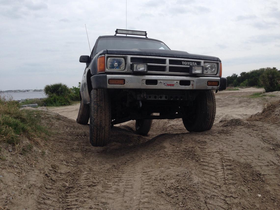

Should I do the ZUK mod? I wanted to see if anybody had any reasons why I shouldn't do it. Horror stories? etc. Also if I were to do it should I do the 12 or 14 inch springs? Do the 14 inch springs raise it too much? more than even?
here is my truck...
No absolutely not. That truck has healthy rear leaf packs. Do not do the ZUK mod. That looks to be normal factory height, very healthy.
Additionally, I don't know why anyone does the zuk mod. A pair of add-a-leafs for our trucks can be had for around $35. That's what I did. I see too many zuk modded rear ends that look so high in the back it's silly. Even more absurd is removing a leaf because your zuk mod made the height too high. Thats a lot of pointless work. Stick a spring between the frame and leaf pack, then remove a leaf? What? Just add a leaf people. Haha.

Most people come to these boards to discuss ideas, you know, trading opinions and weight pros and cons. AAL and Zuk mods are two options that can achieve different things. One reason the Zuk mod is so popular is that you can gain ride height but also a softer spring rate, which means its doesn't ride like a wagon. Most AAL's are a very stiff, very linear spring rate. So if you're old leafs are tired, the entire pack is usually gone.....the soft ones, the stiff ones and adding AAL's only replace the stiff ones. So you've regained height but your ride quality sucks. Zuks with stock replaces are usually progressive springs so you regain that entire range. The linear springs such as the black magic generally are a softer rate gaining height simply by being longer. As far as looks, those are always just an opinion of the viewer. Maybe people overload their runners with gear, so fully loaded, its level. Most trucks actually come stock with that type of rake. So again, there are pros and cons. Obviously you like the easy install of AAL's and the factory stock look, but lets keep things constructive or we'll have to start a thread of things we think look silly on almost stock looking trucks.

What I am saying is, if he sticks a coil in there, odds are he is going to have too much lift. The OP posted a picture of his truck from the side, I assumed him asking "Should I do the ZUK mod?" was in reference to the current stance of the truck. The ride height in that picture is pretty close to factory, I was merely advising him not to do the ZUK, not because it was a bad idea (even though I don't like it), or worse than any other option - but because it will most likely raise the rear end too much.
Now, my intention wasn't to push any buttons, and I happen to find this forum very helpful, but the fact that I haven't stuck a spring over a bump stop between a frame and a leaf pack doesn't disqualify me from a valid opinion.
Some like the idea of a coil, some don't. Maybe I shouldn't of made a comparison to begin with and I did so as a viable option to what the OP might have considered rear end sag. I've seen and worked with these things new, and I have seen new factory style leaf packs installed on 1st gens too, and I still hold to the opinion that his packs are at about factory height and most likely fine, as far as height goes.
To each his own. :)
Mine from his picture sat about the same when I was all stock. The rear end has always bottomed out way to easy ever since I can remember as a kid riding in the back. Even brand new from Toyota there wasn't much room between spring and bump. I bet the spring just soften up over the years and compress way to easy and bottom out. I still think the op should do a mild lift for a better ride. I loved my old bj spacer and zuk mod when I had it not the smoothest but way better than stock. Maybe it's the extra travel before the bumps that helped.
