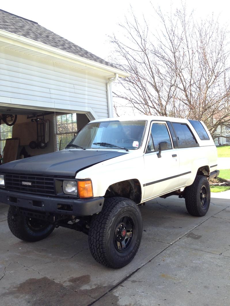

I am also rockin' the updated 3rd gen coil no cut zuk mod
