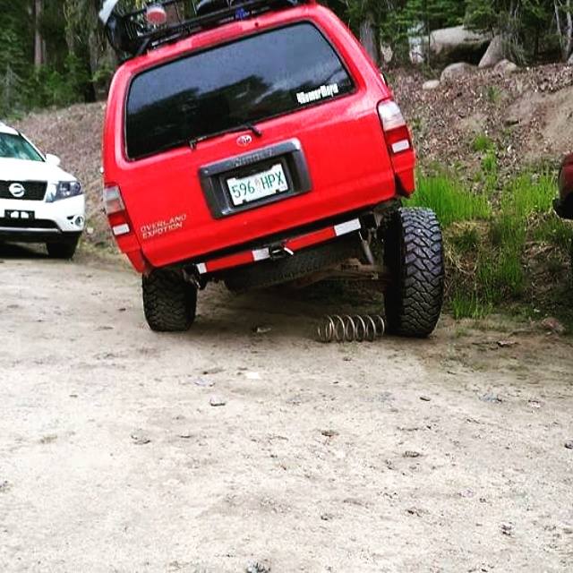

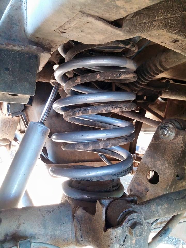

heres my zuk mod, im using 3rd gen coils inside 5th gen coils. it works great, the spring only falls out when i flex.
