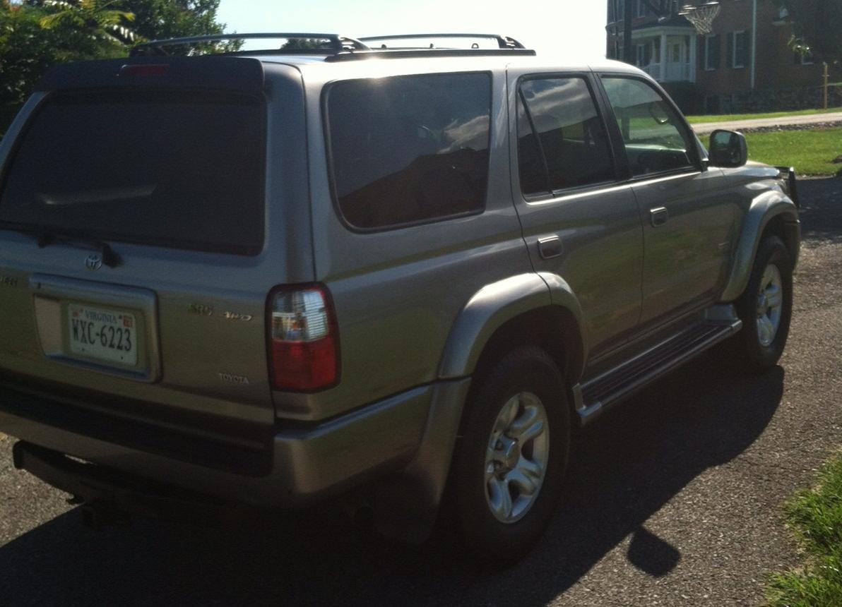

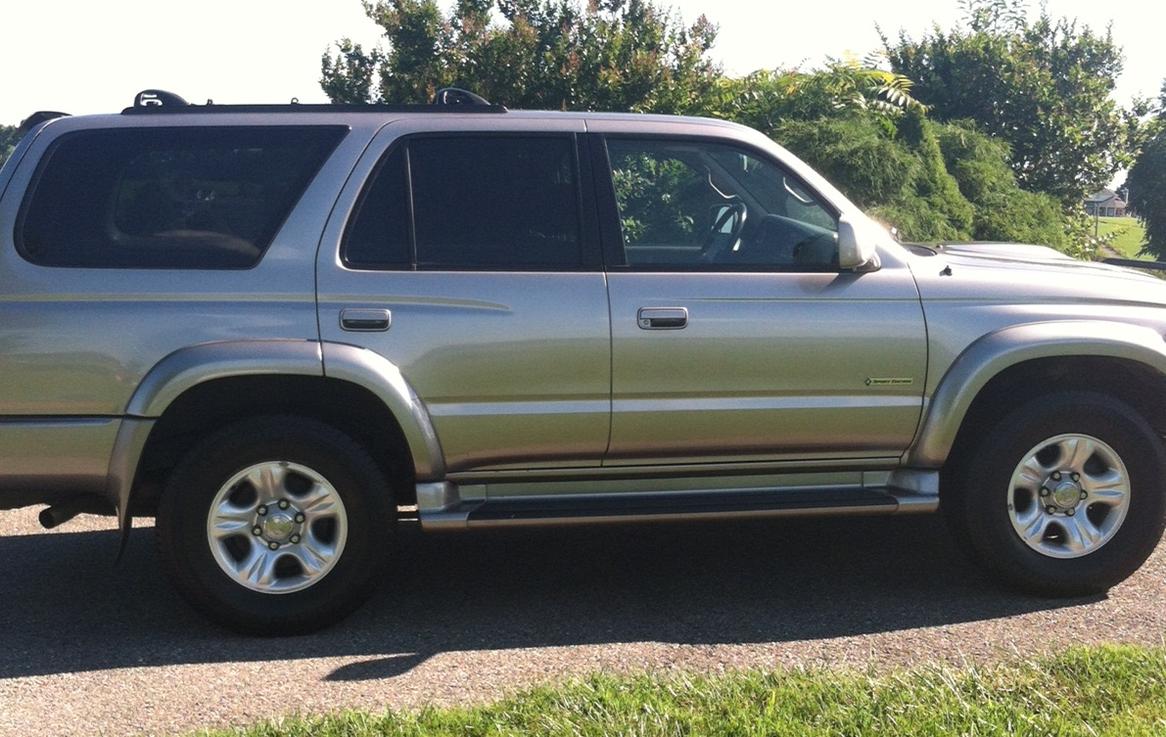

When I bought it:

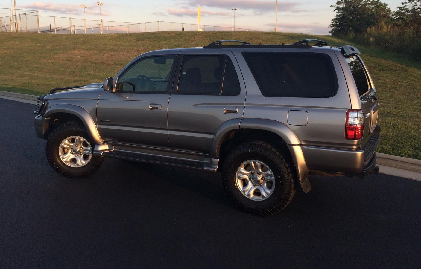

As it Sits Now:

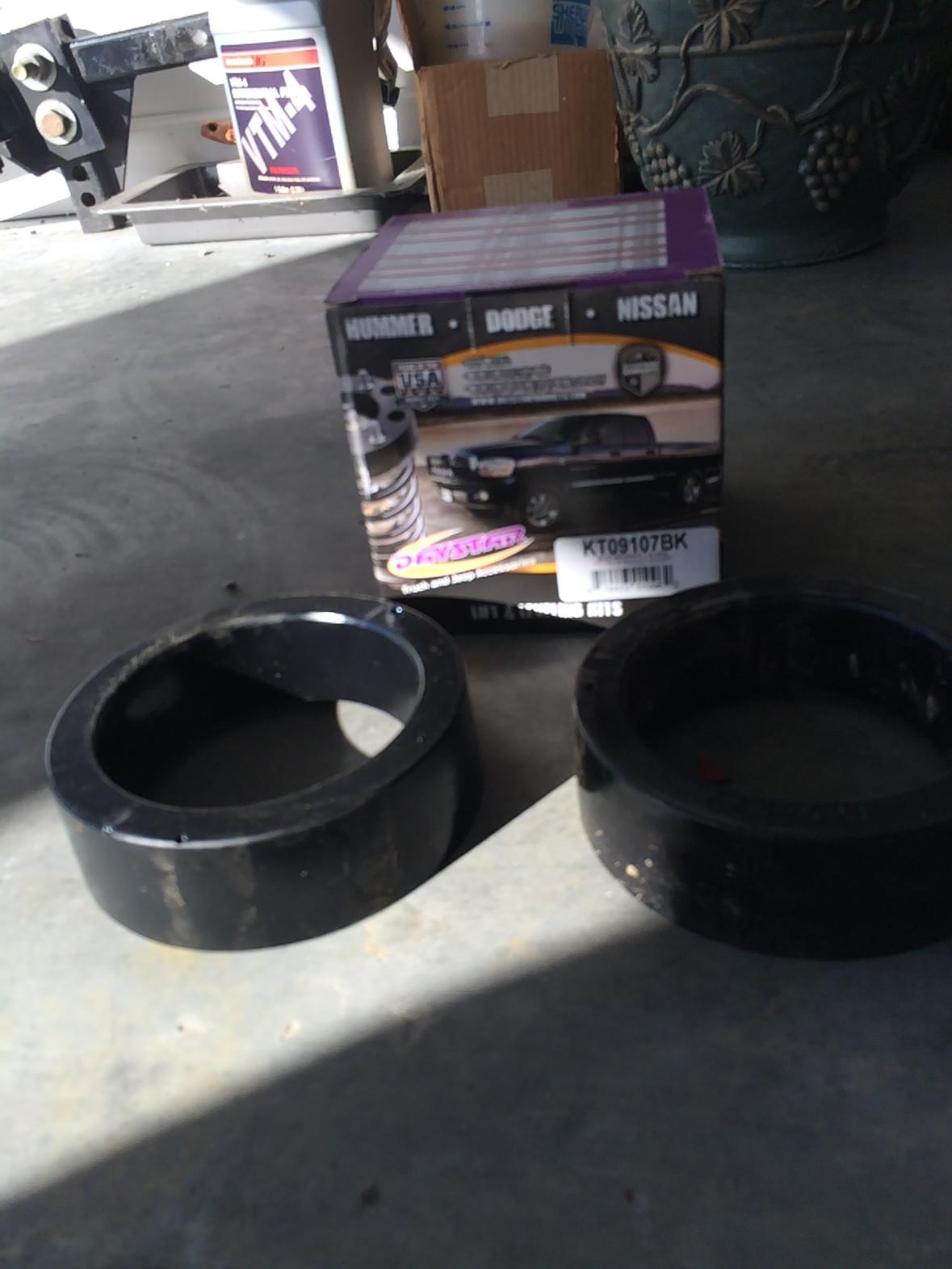

-1.5" Daystar Rear Lift Block

-1" Toytec Diff Drop​

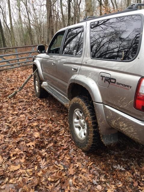

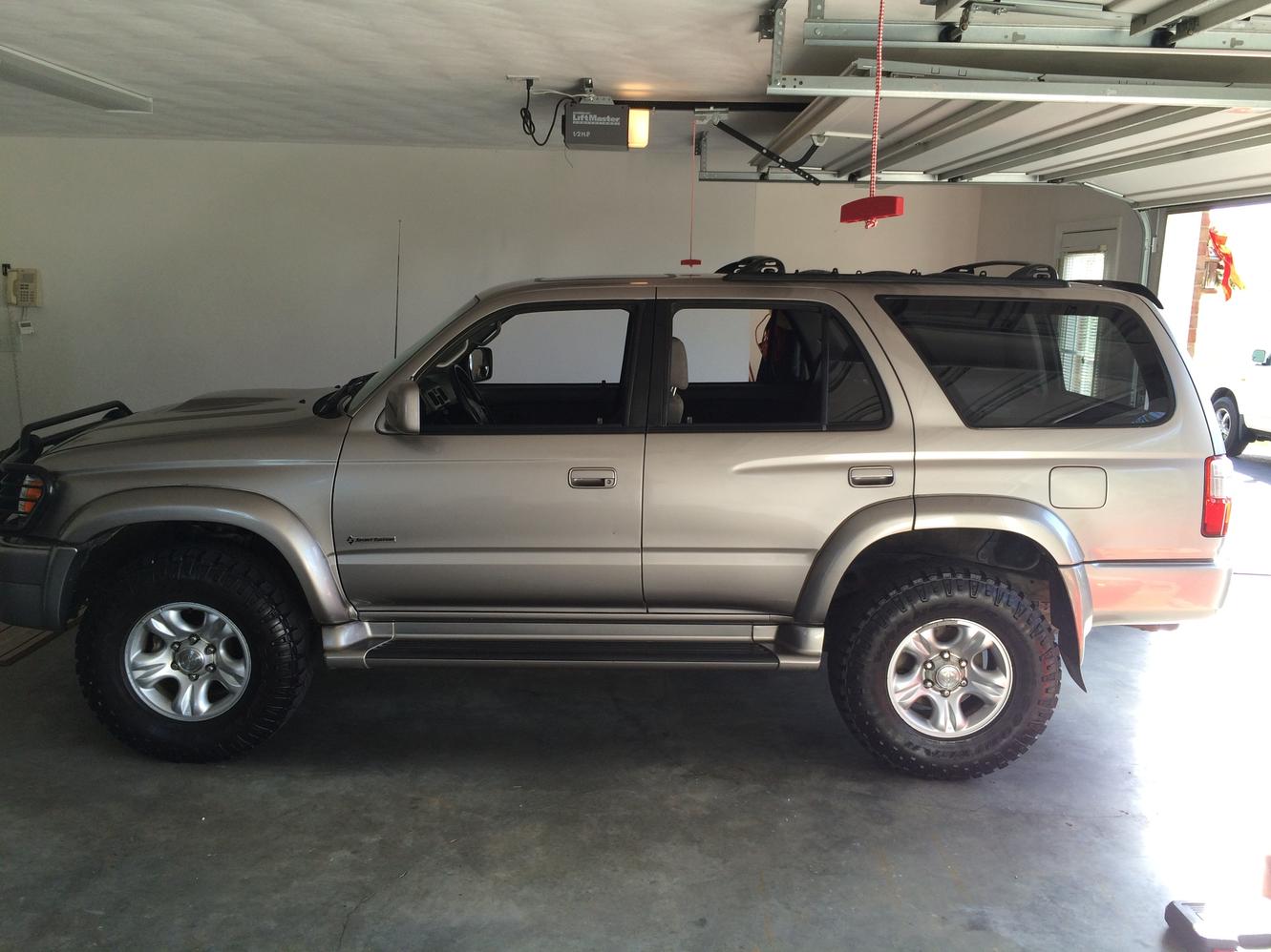

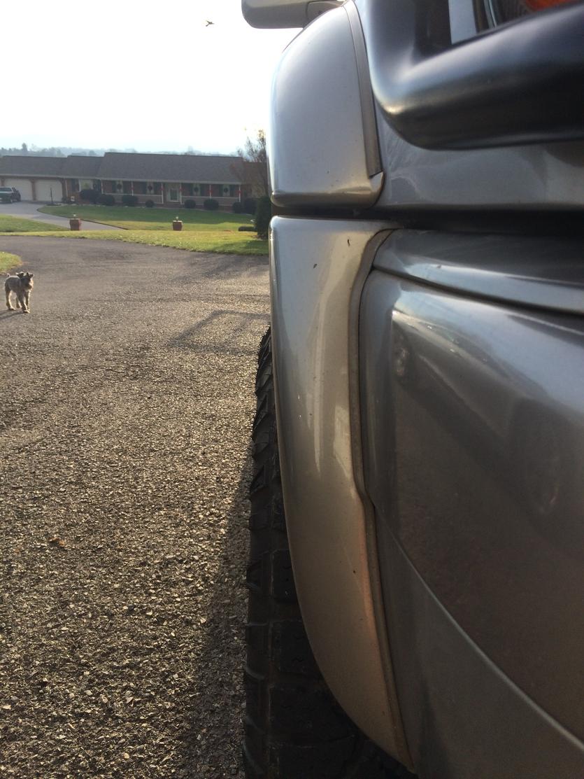

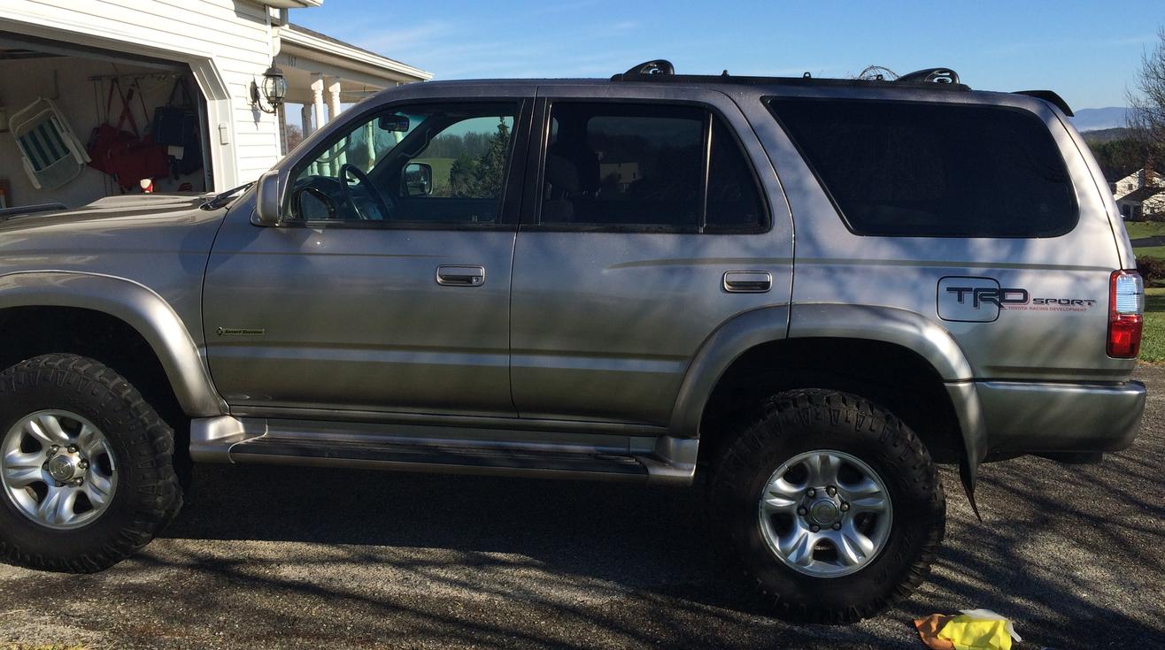

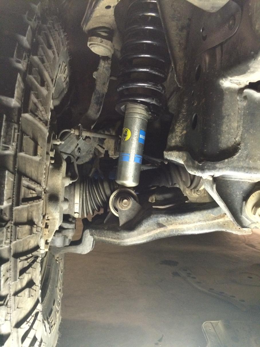

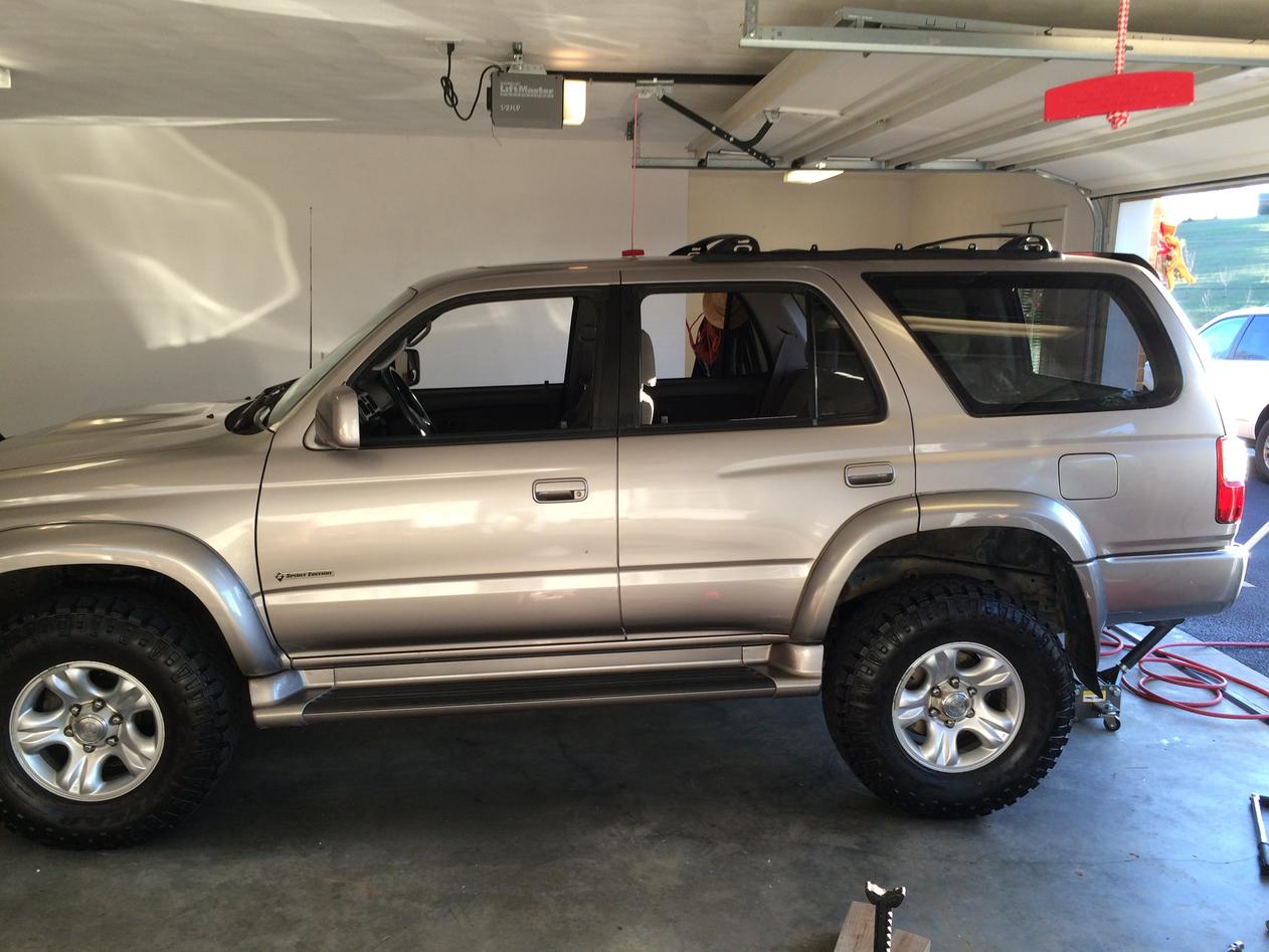

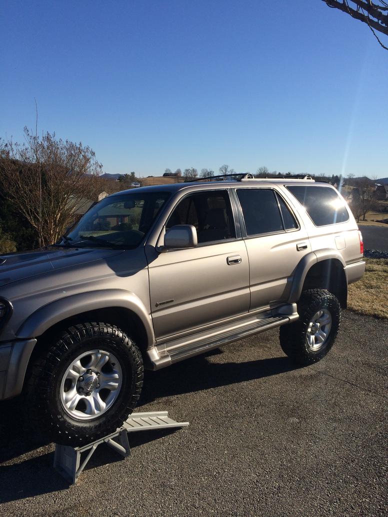

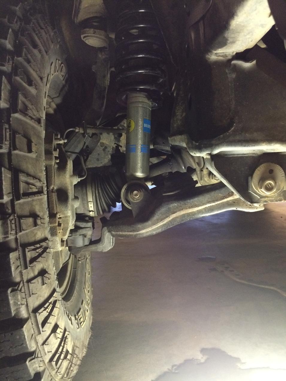

2 in" Lift Installed and tires
OME 881 & 906 Coils w/ Bilstein Shocks also 265/75R16 Duratracs installed
Sorry I don't have many pics of the install I didn't take any

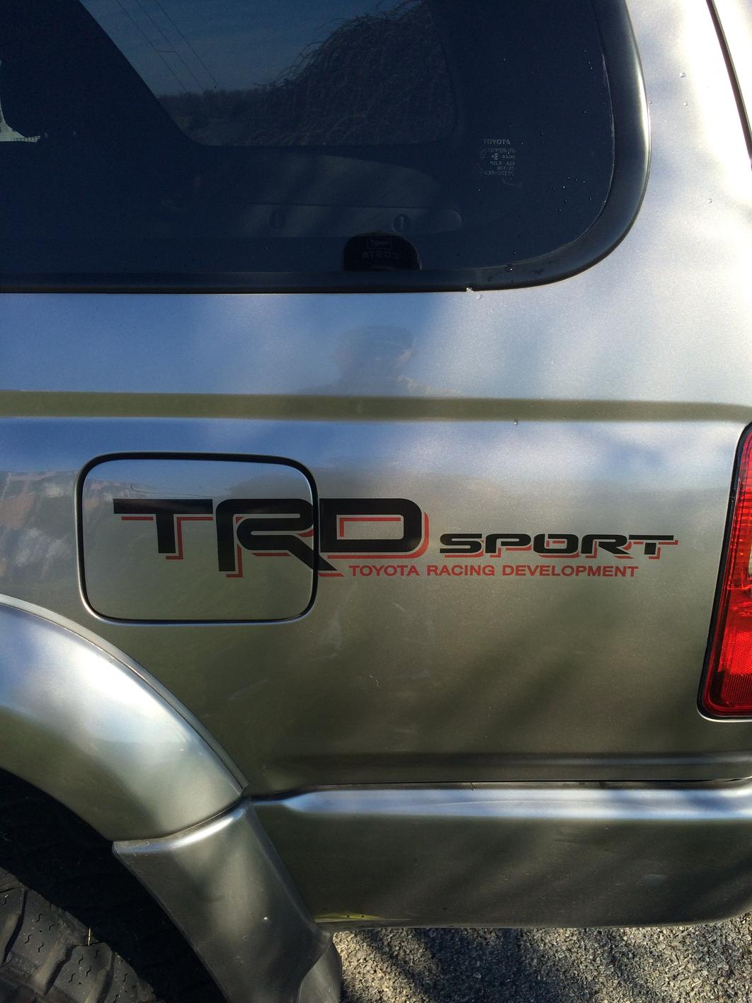

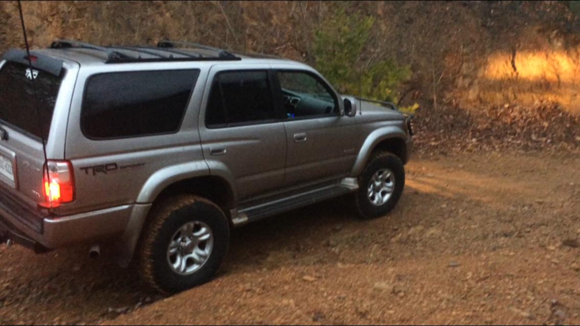

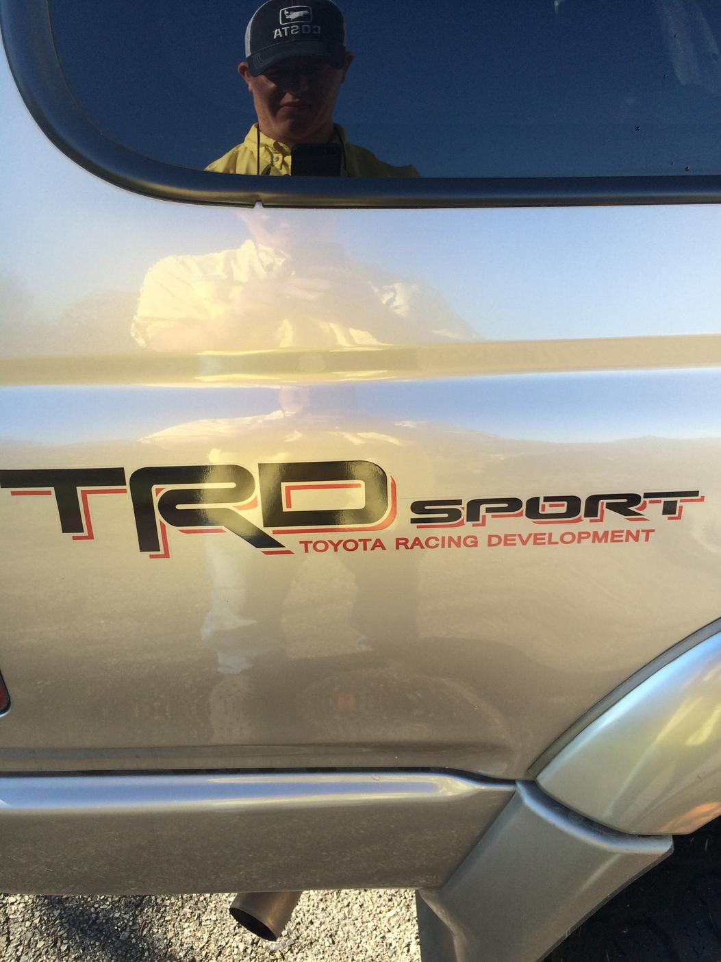

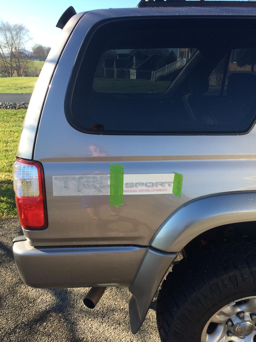

TRD Decals
Toyota should have put these from the factory, they look like they were meant to be there.

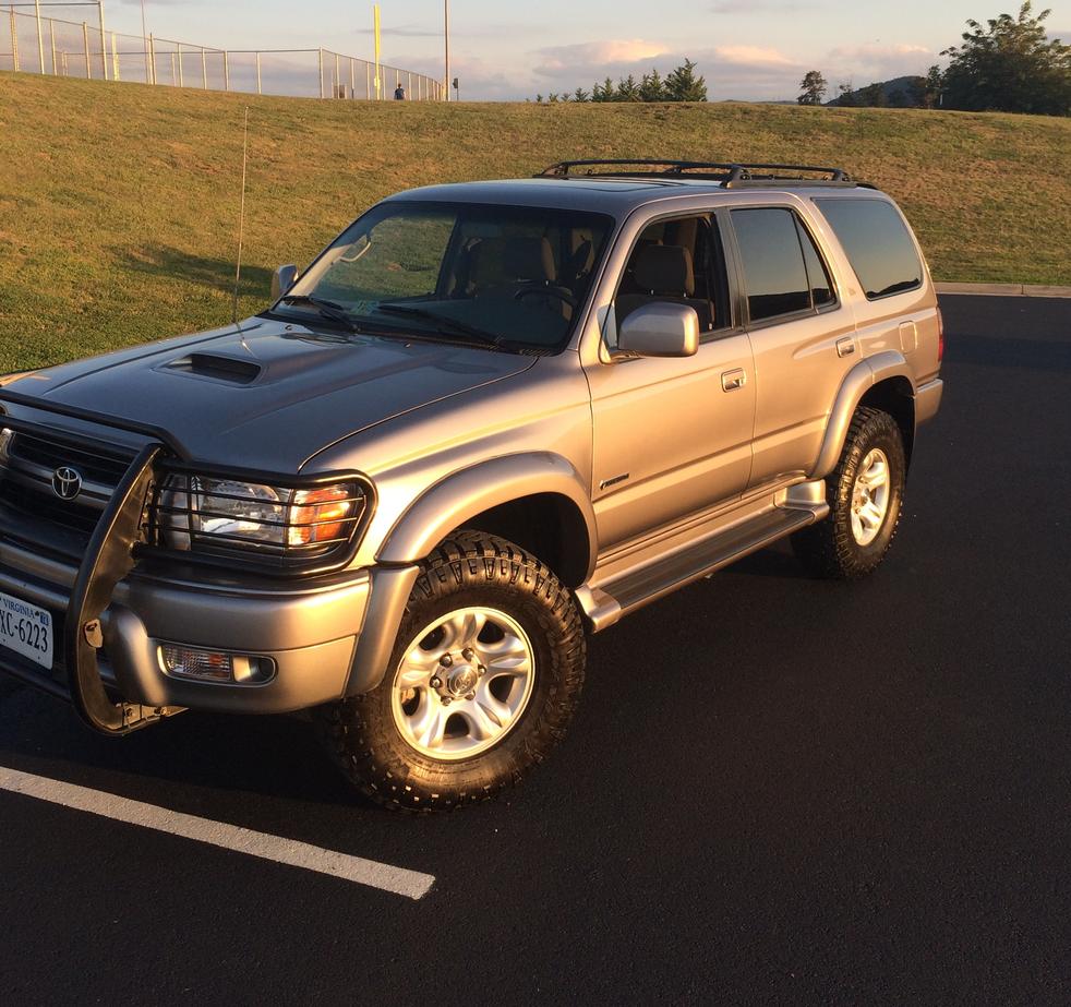

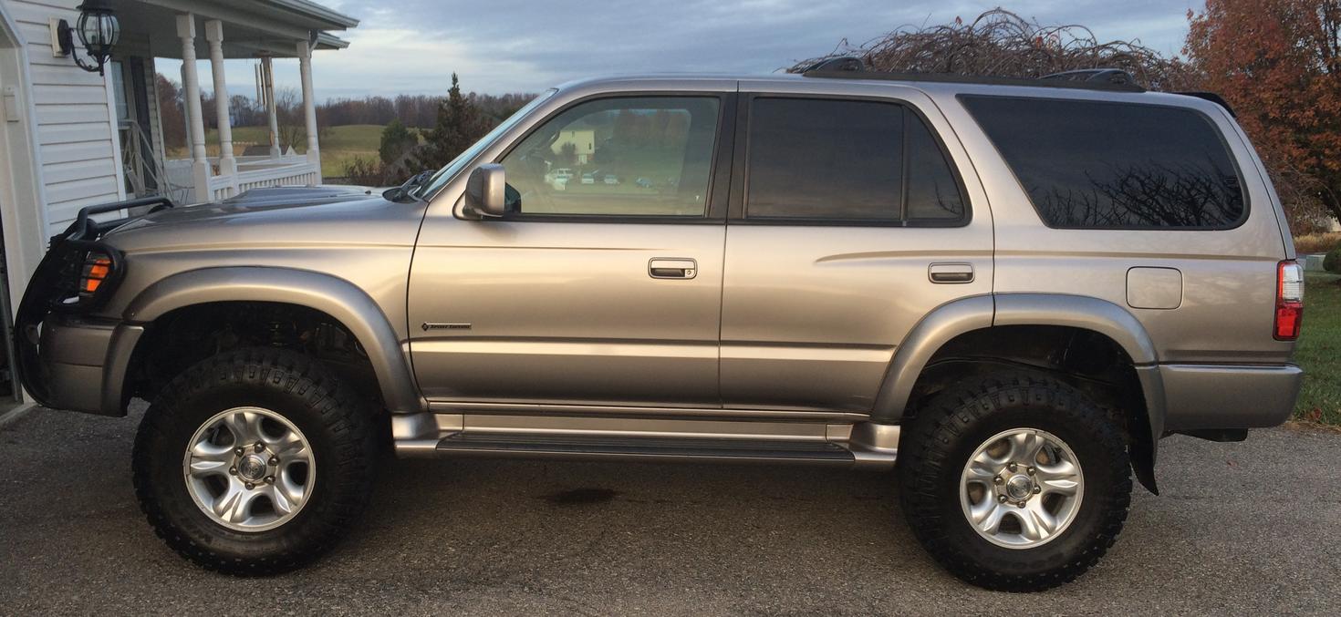

Added more Lift
Sorry, right now I'm a little out of order with my mods, I'm just trying to catch up.
Before Lift:
Bilstien shocks were adjusted to the top notch and 1.5" Rear block lift and Airbags were installed

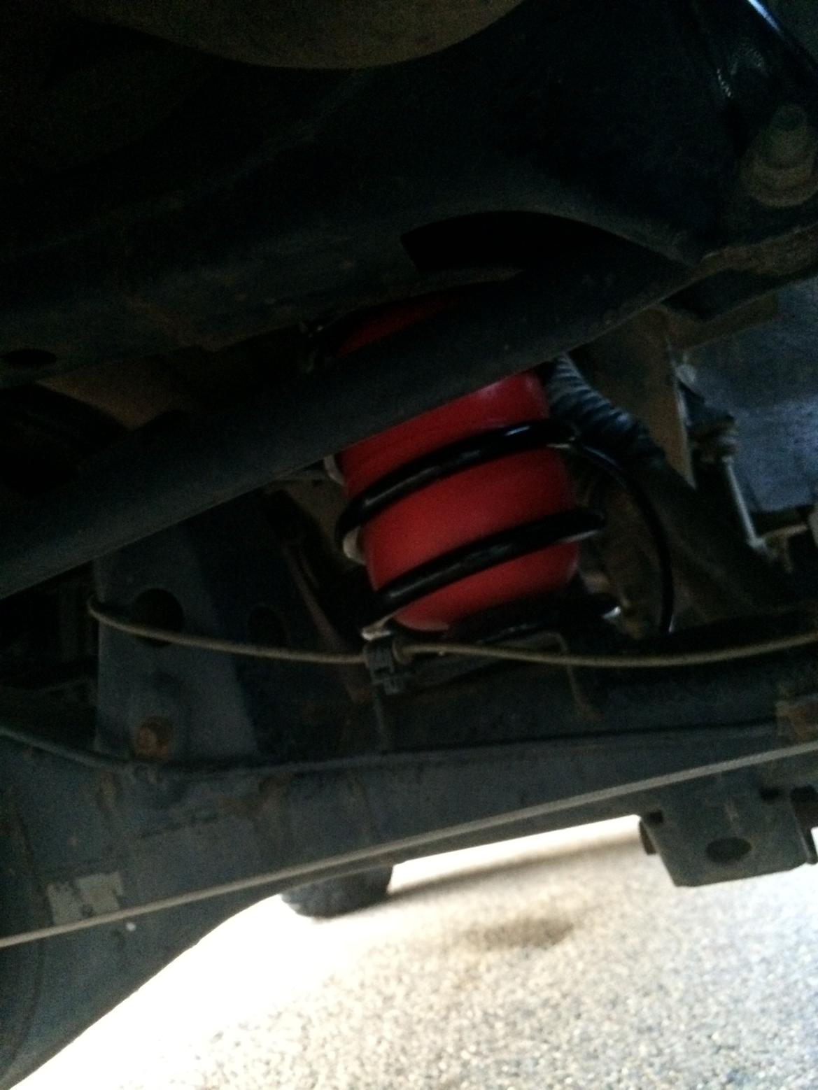

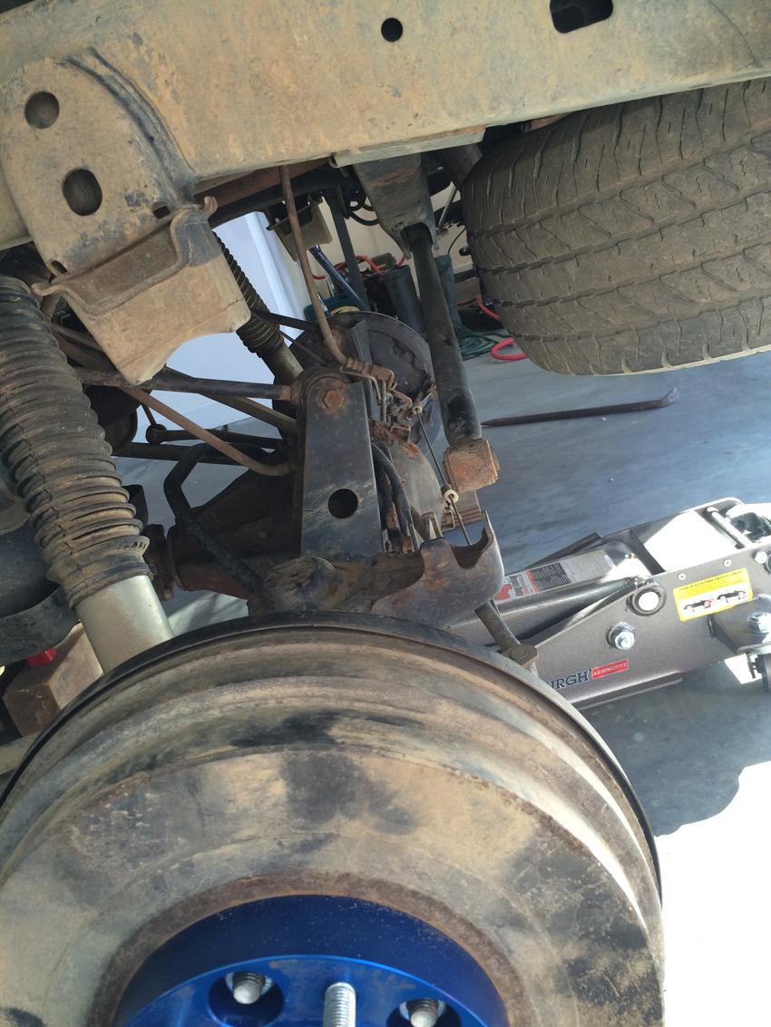

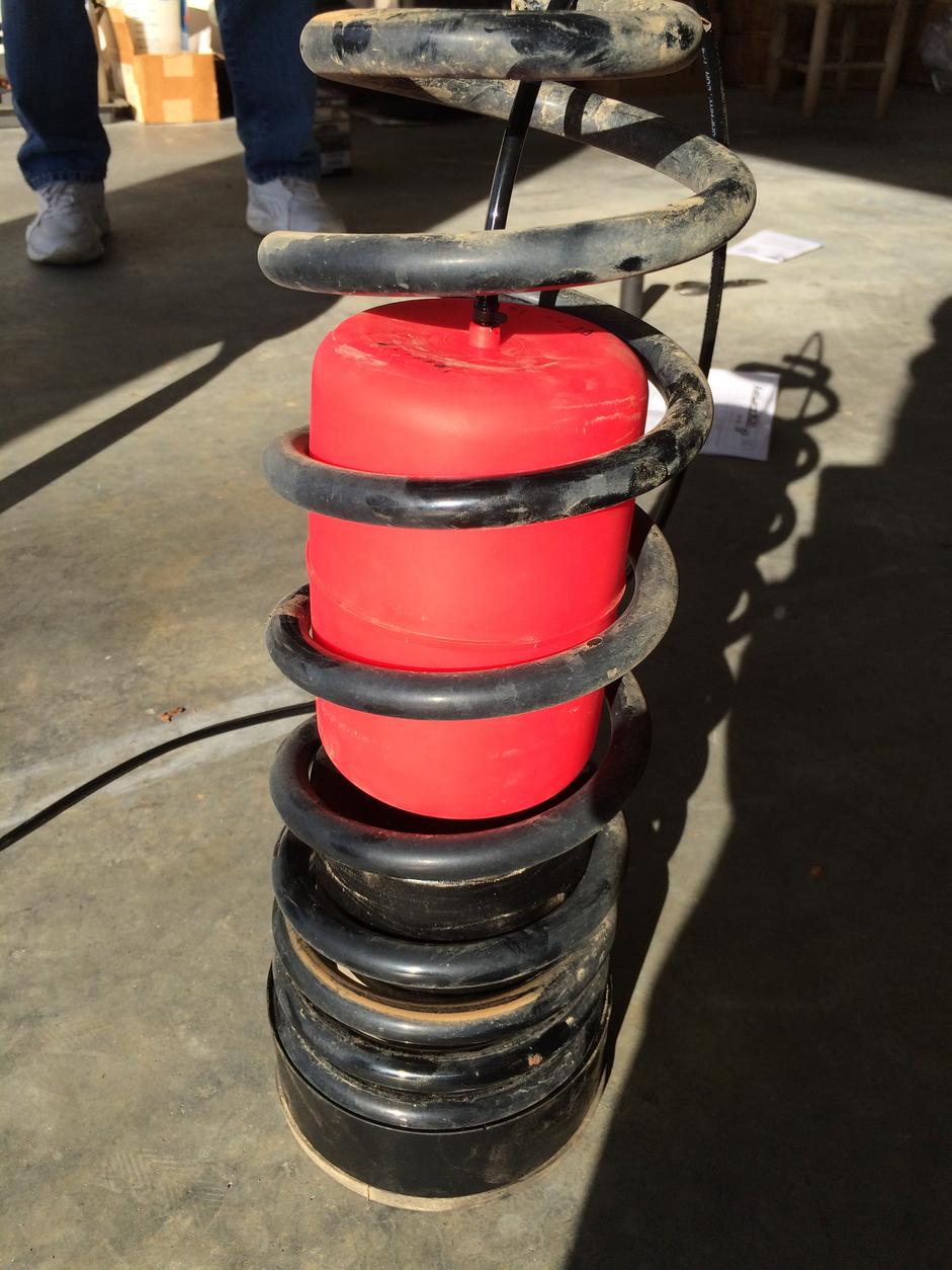

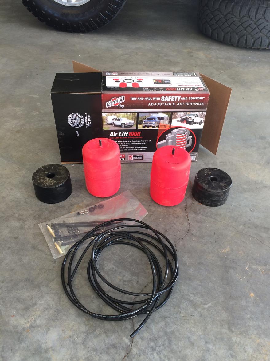

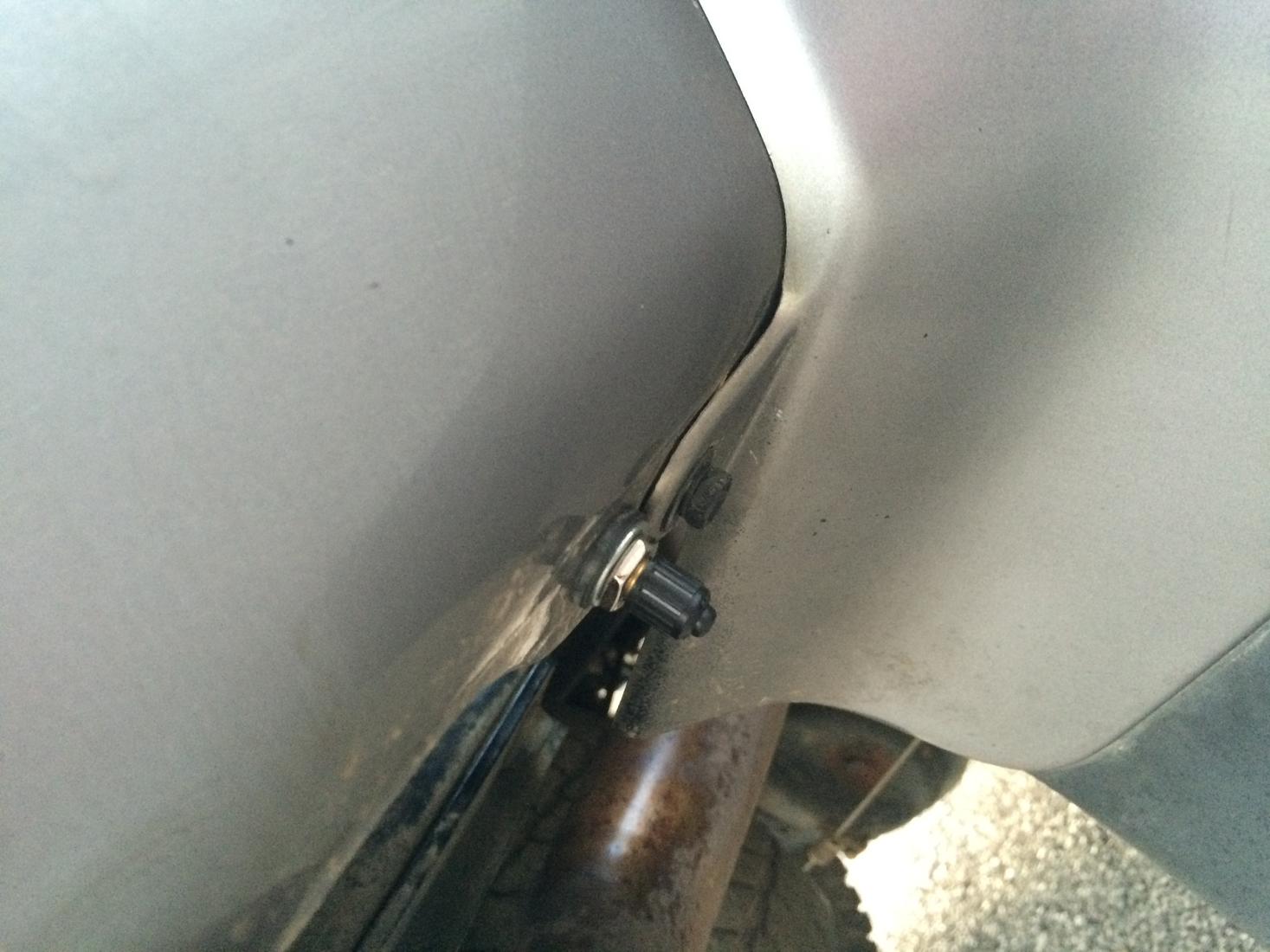

Rear Lift and Airbags
I cut the bump stop off completely and this is how I installed the airbags in the spring
I mounted the air nipples behind each mud flap, I didn't use a T connector because i wanted to be able to adjust each air bag in case a load was heaver to one side

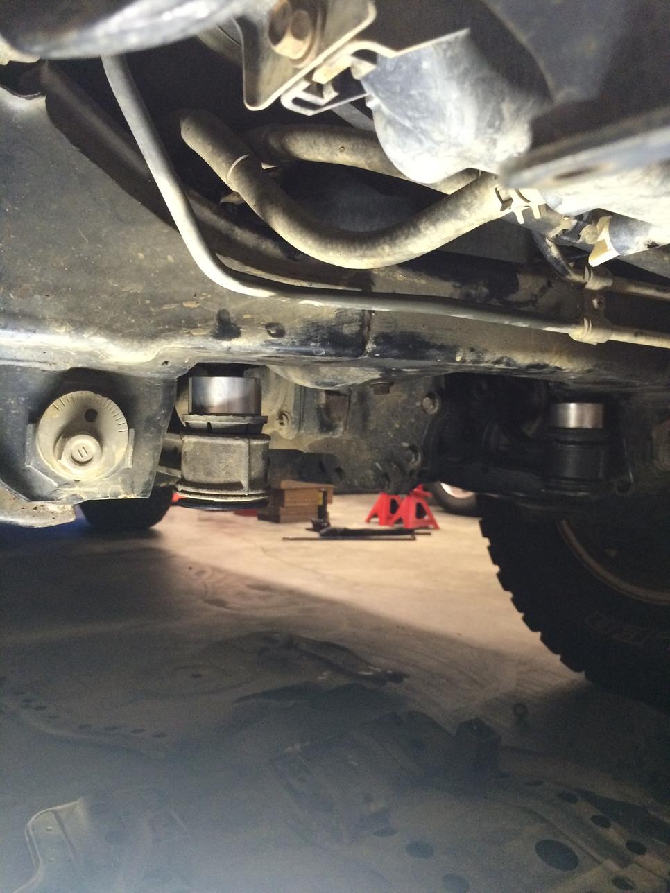

1" Toytec Diff Drop Installed
Before:
After:

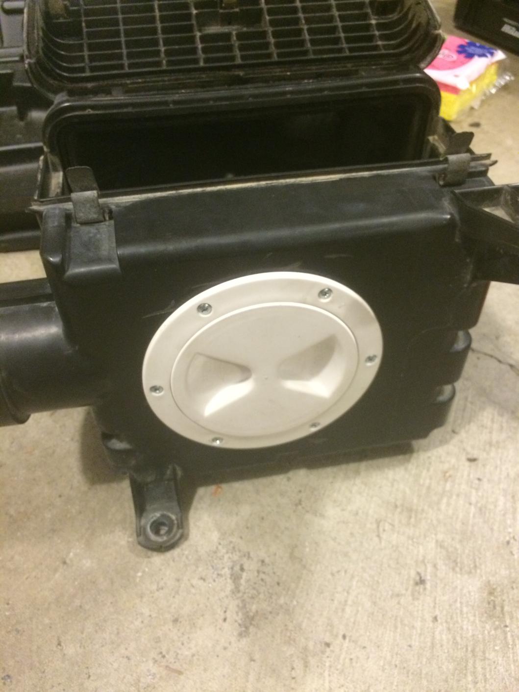

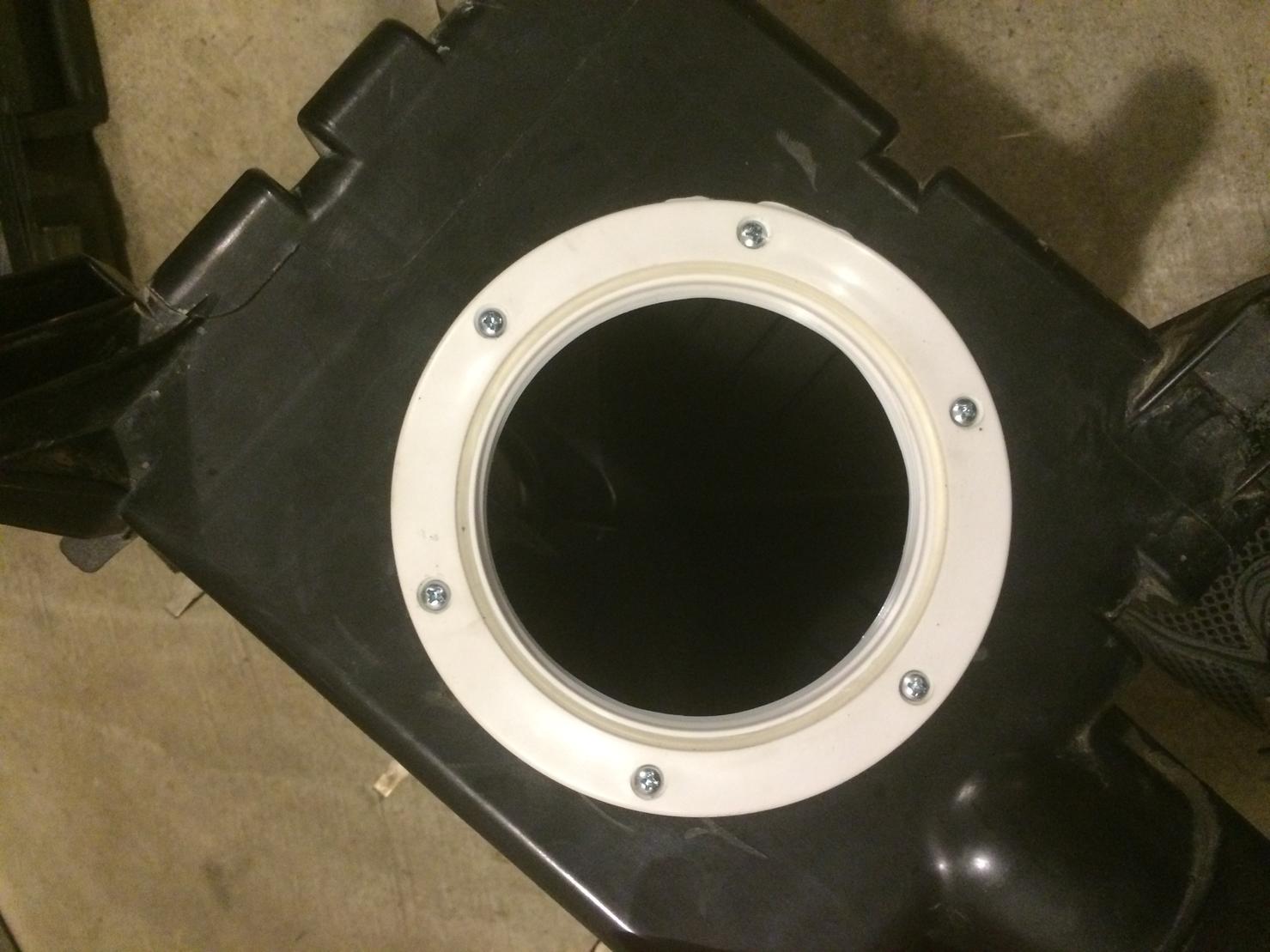

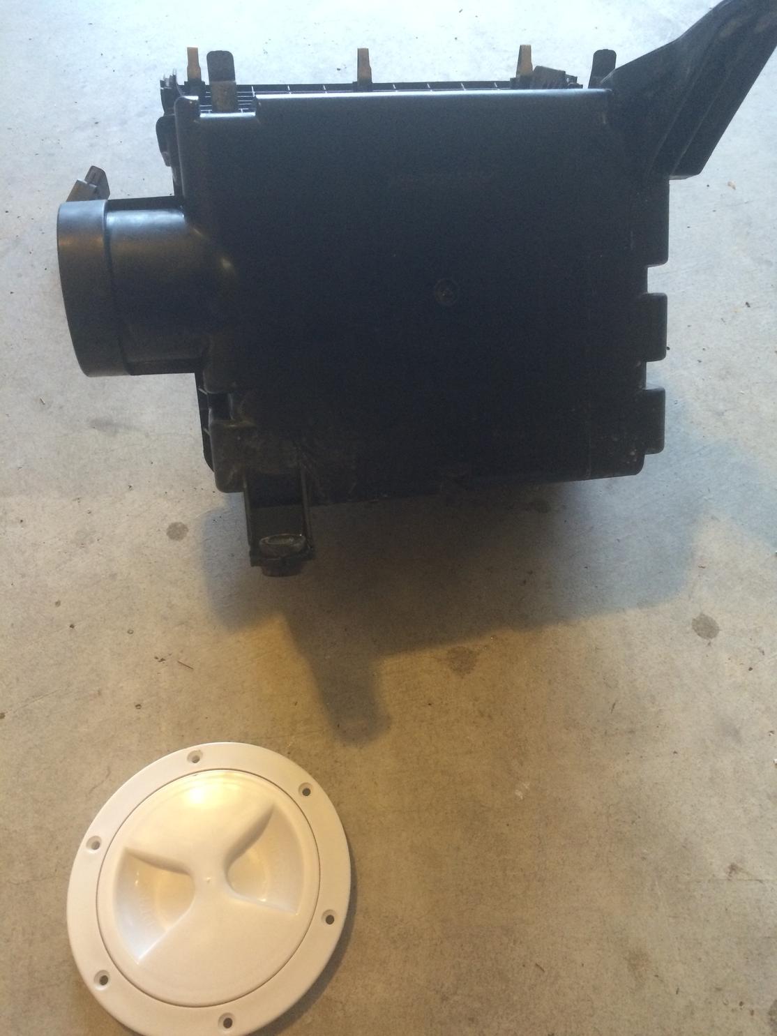

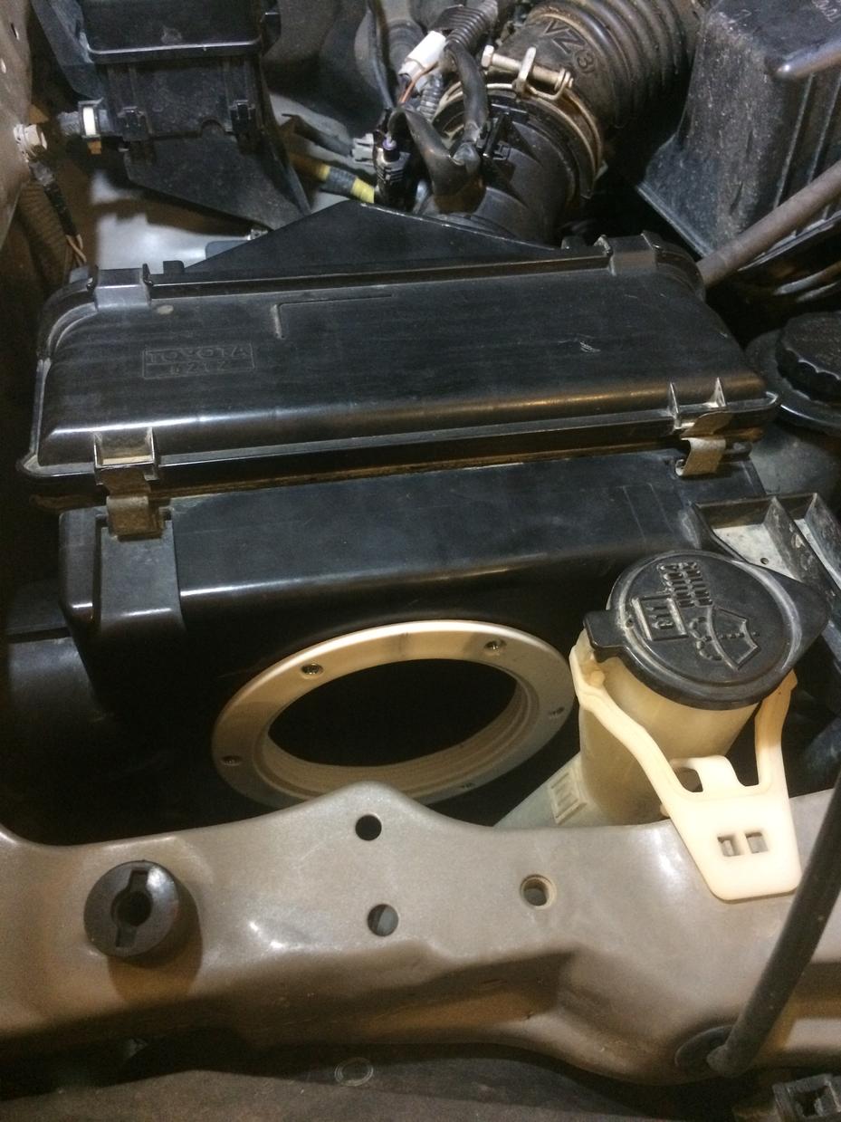

Deckplate Mod
Deckplate

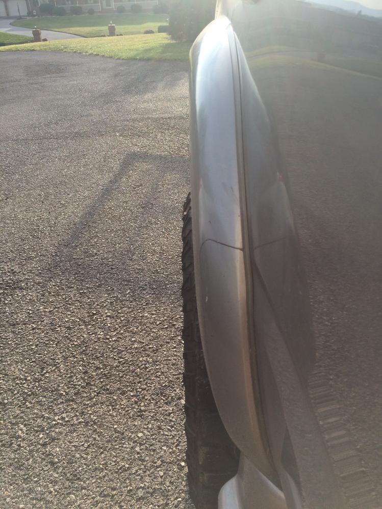

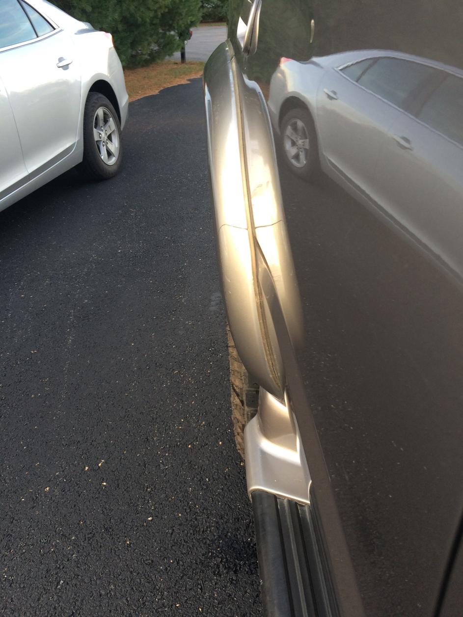

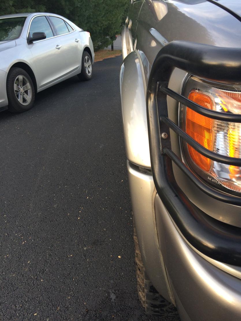

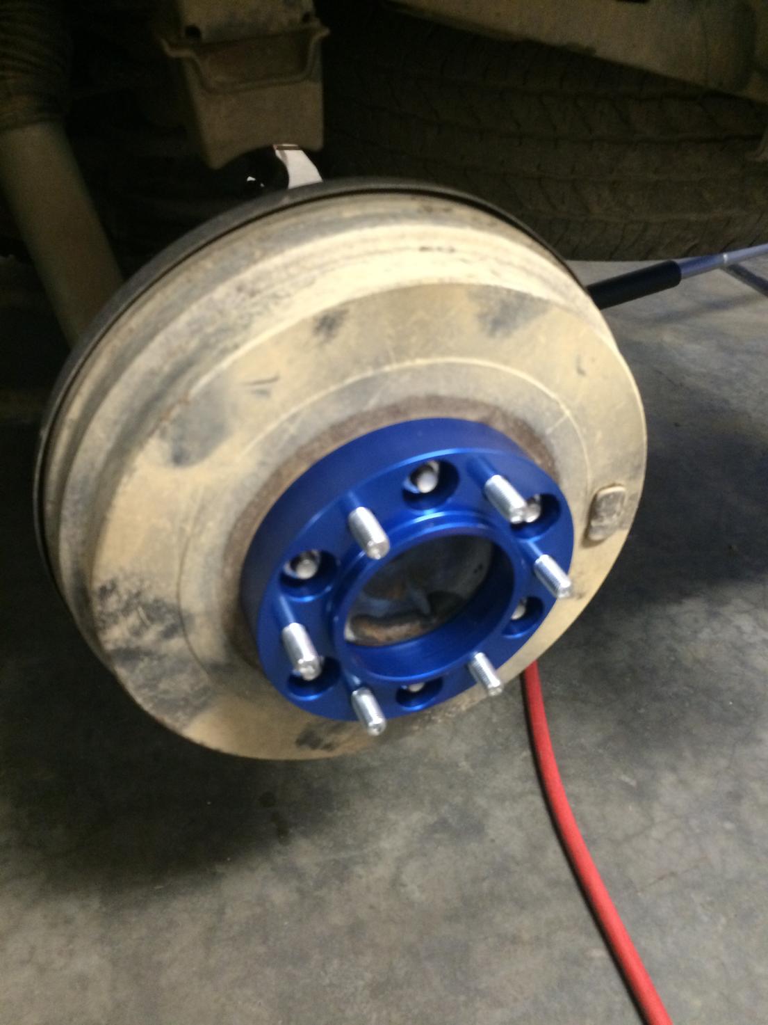

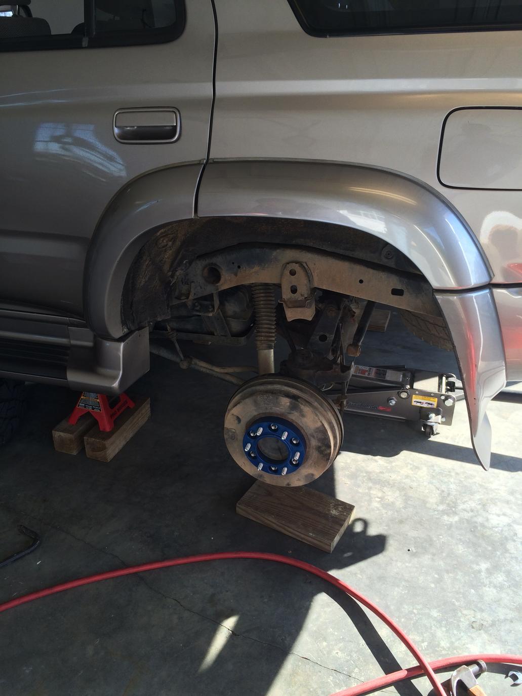

Installed 1.25" Spidertrax
Before:
After:

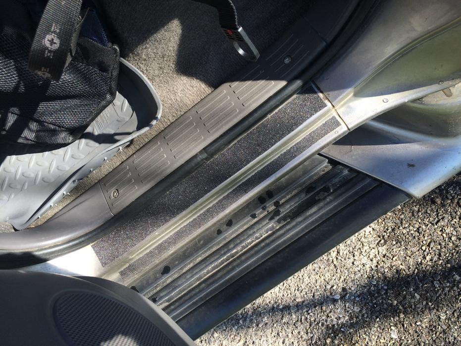

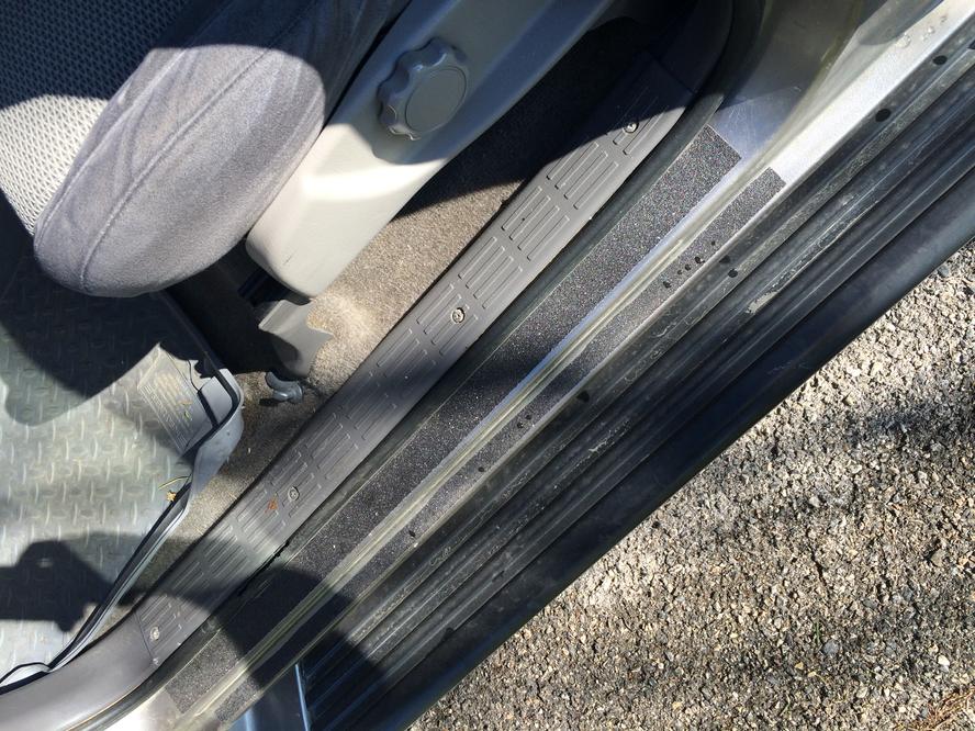

Installed Grip Tape
I had some grip tape laying around so I said why not :biggrin2:

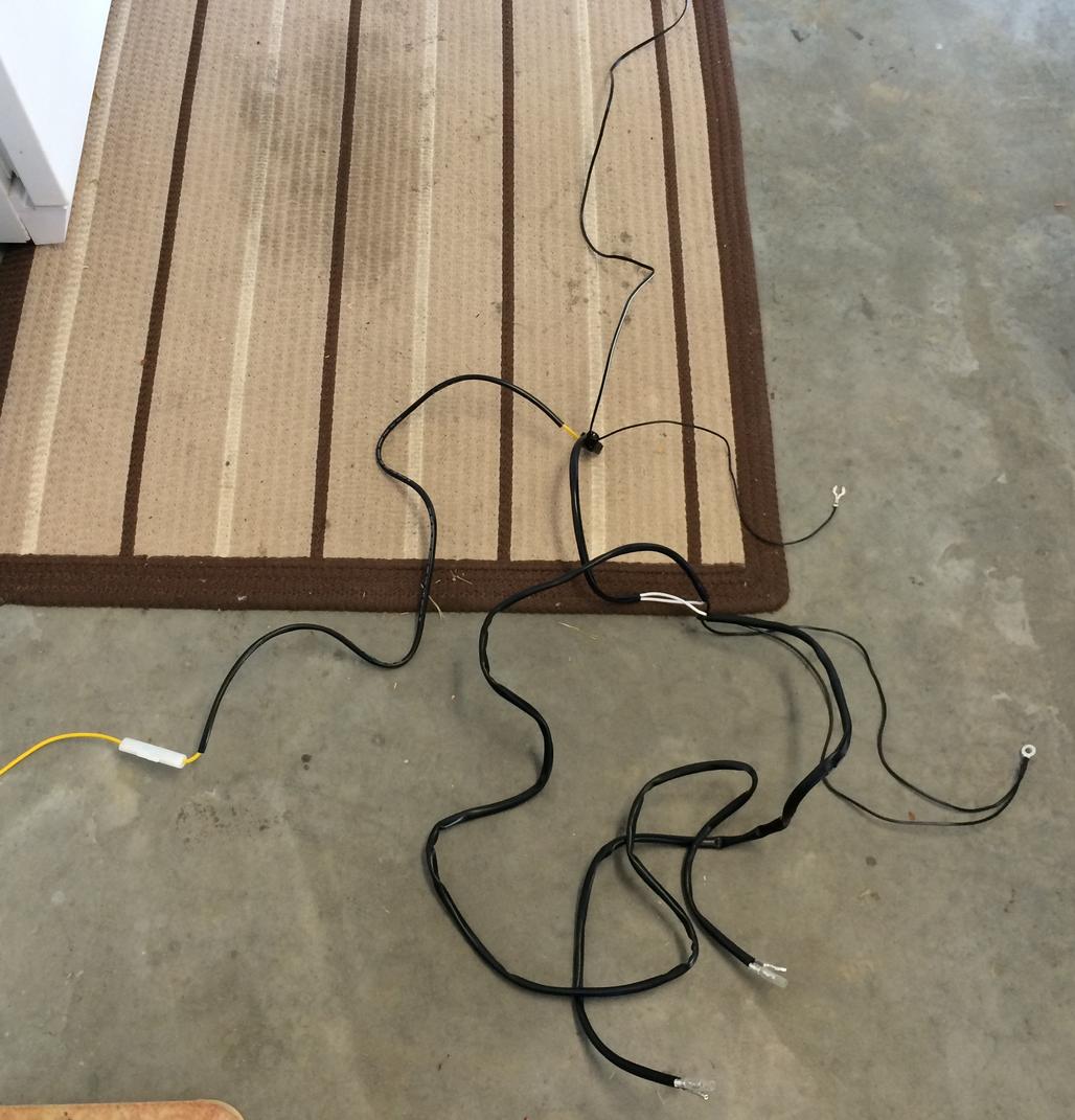

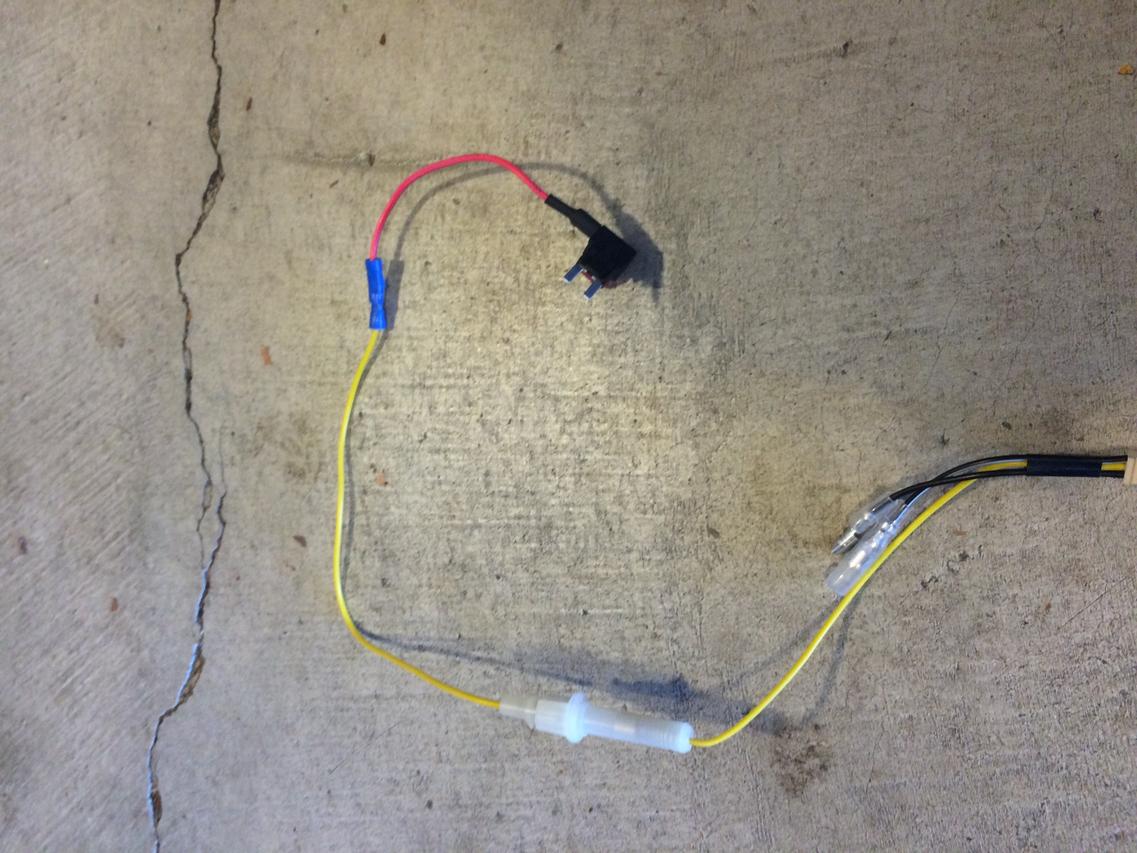

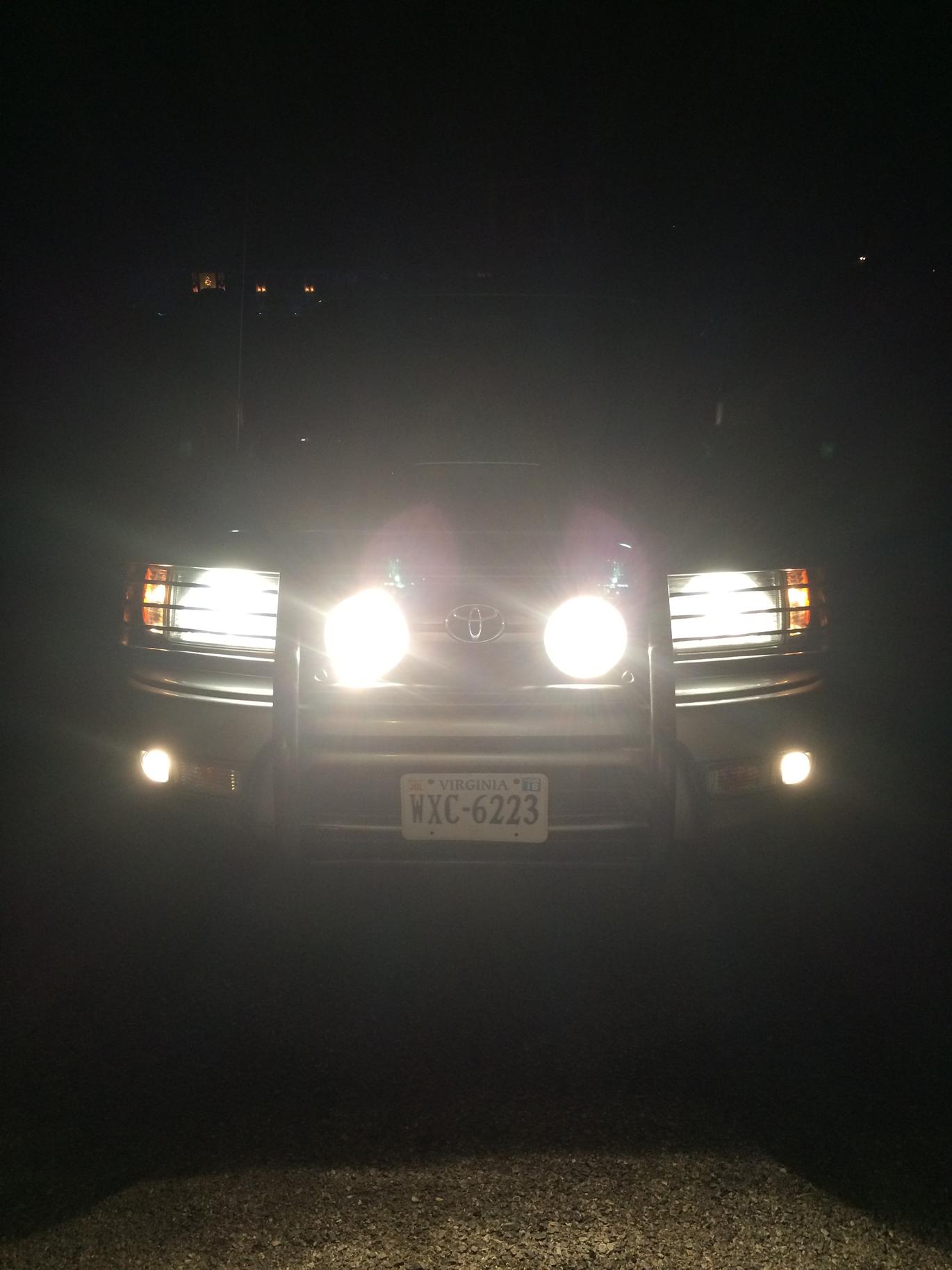

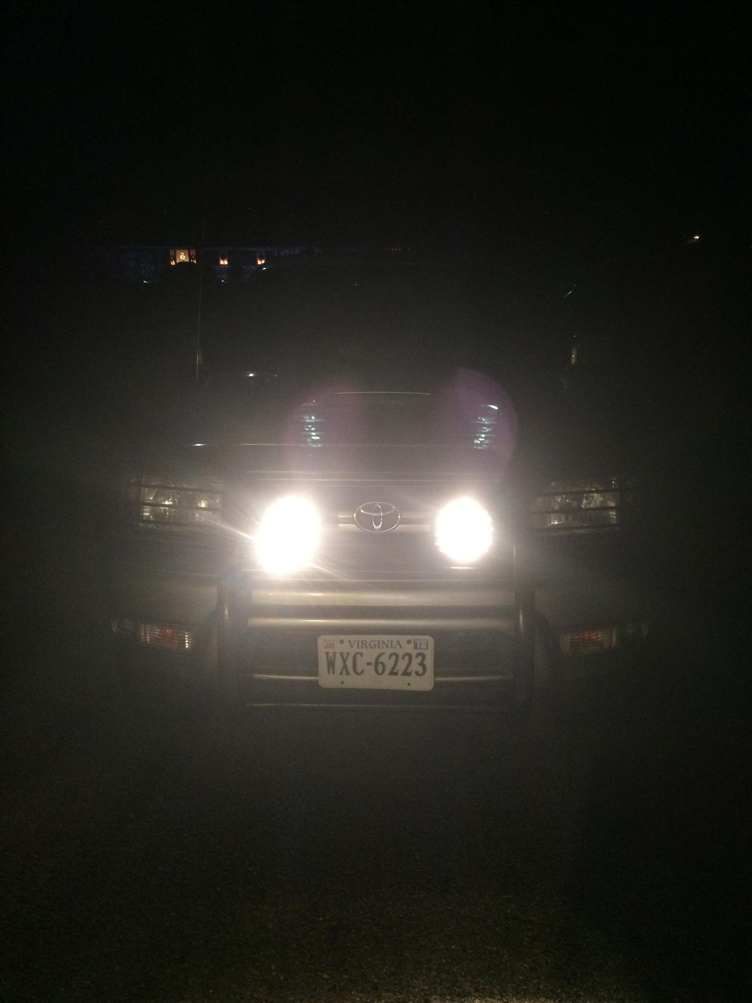

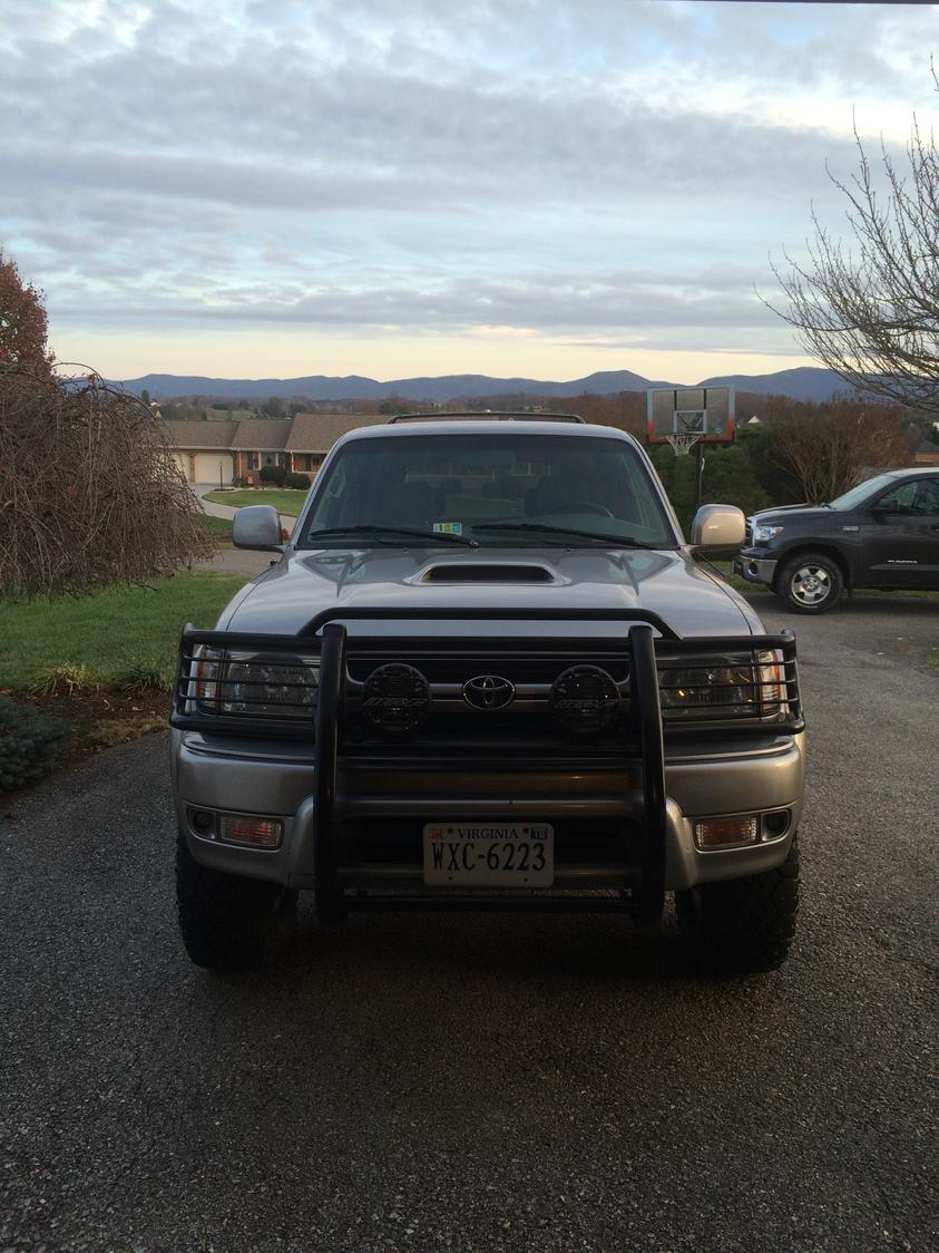

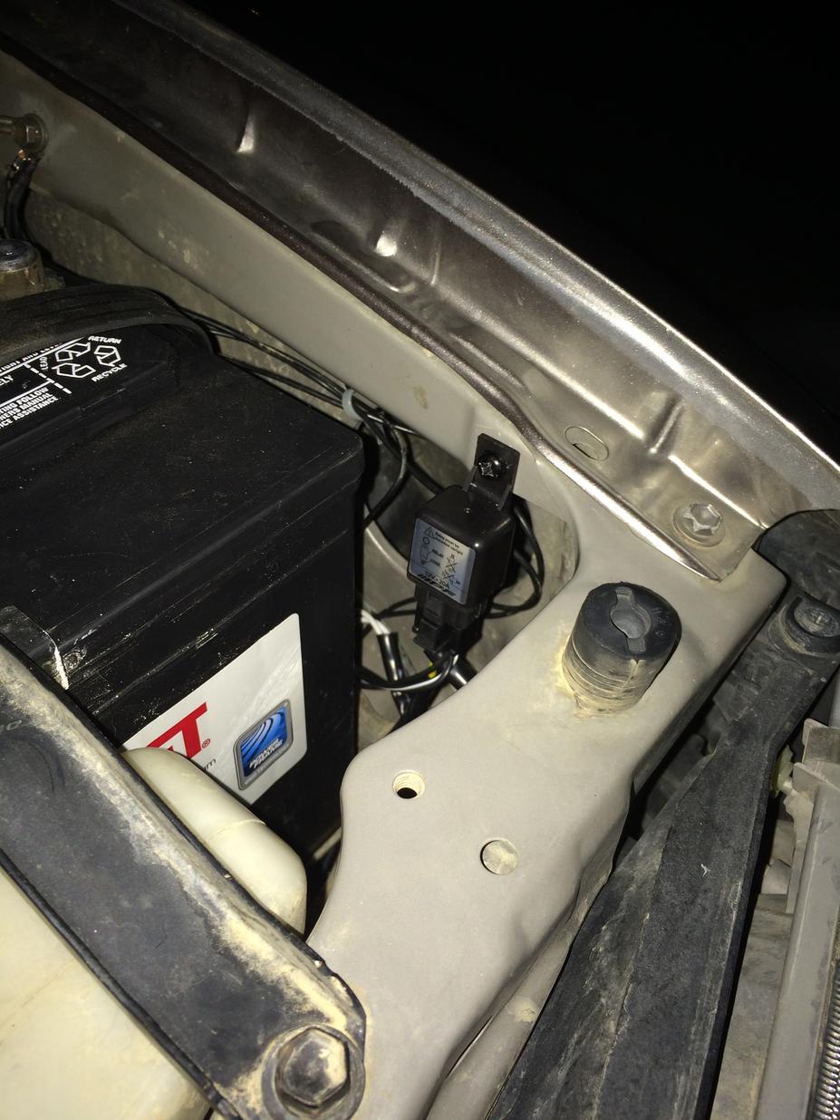

Off Road Lights Install
So I installed the 6" IPF Off Road lights on the Brush Guard
the harness that came with the lights was a plug and play harness:
I mounted the relay next to the battery for easy access:

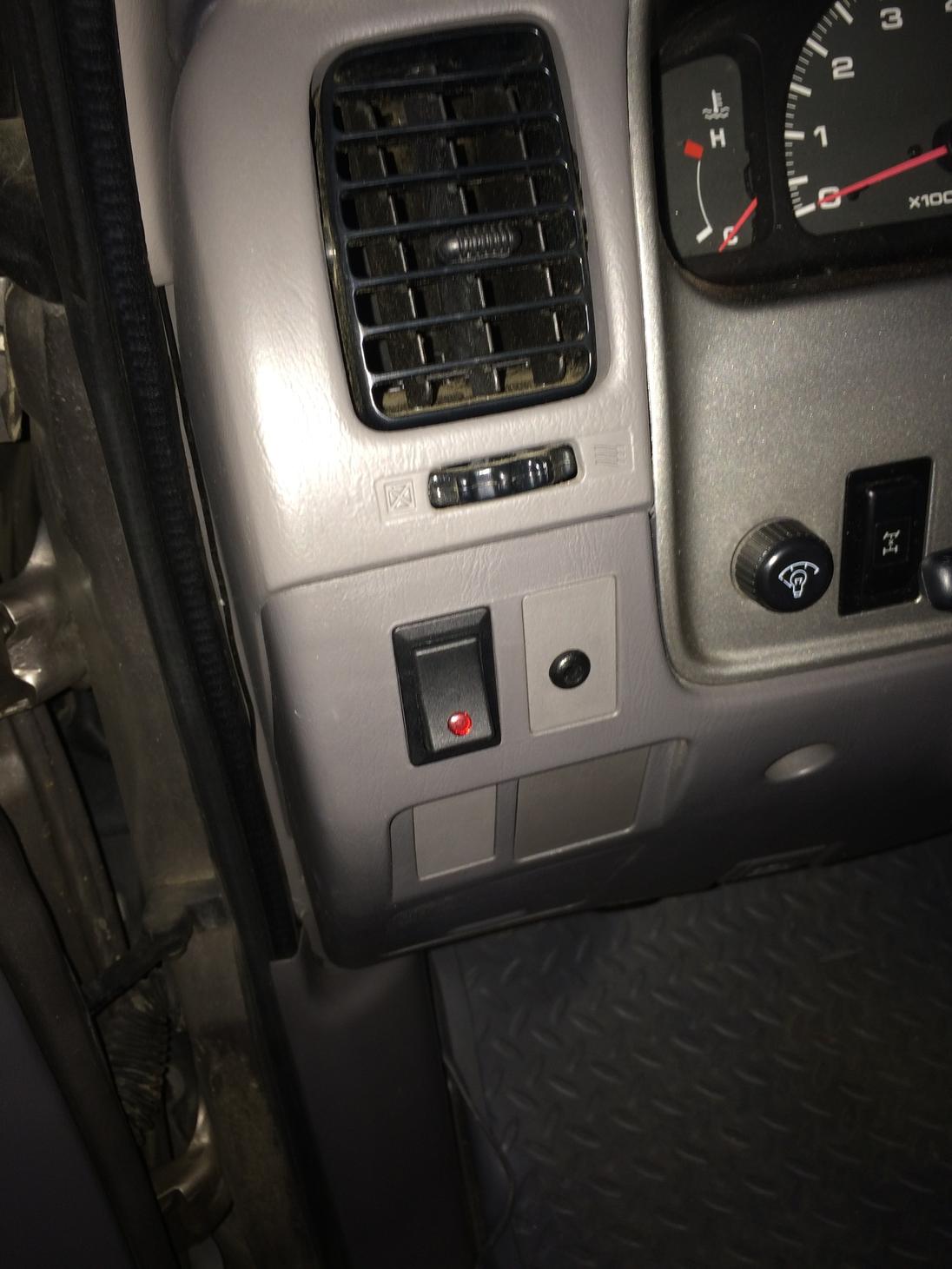

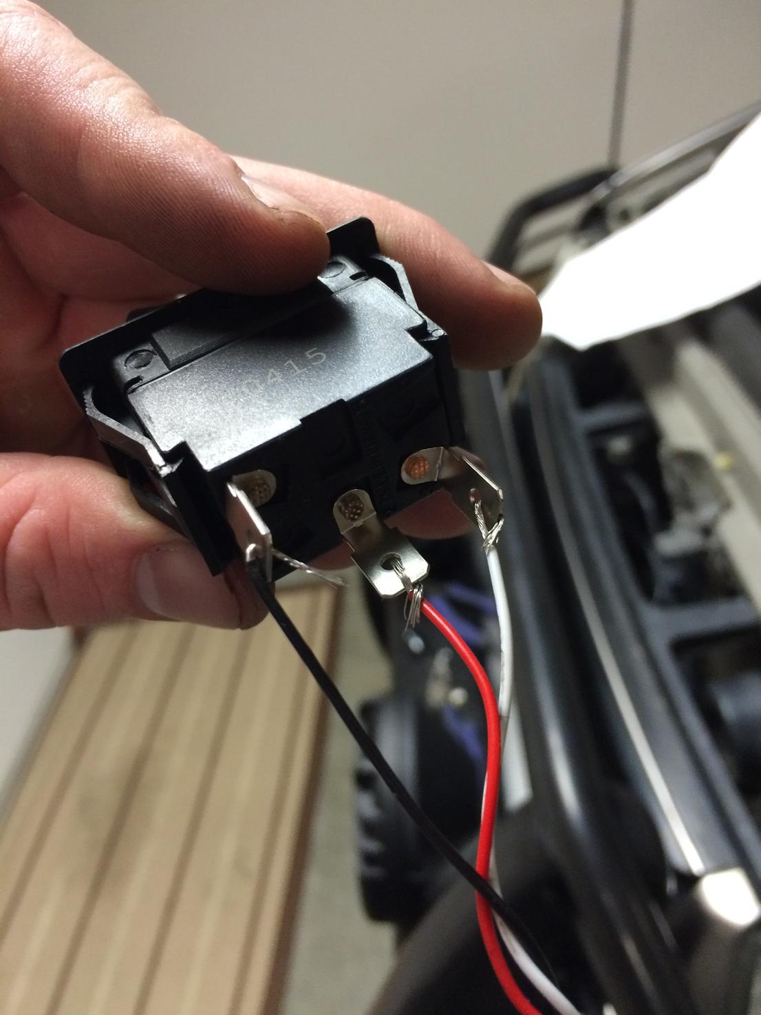

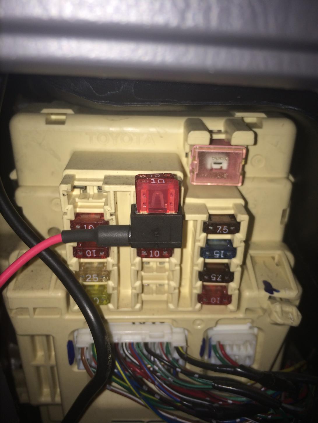

Since I wanted to turn on these lights anytime I wanted, I used a fuse tap and tapped into the dash lights fuse instead of tapping into the high beam lights

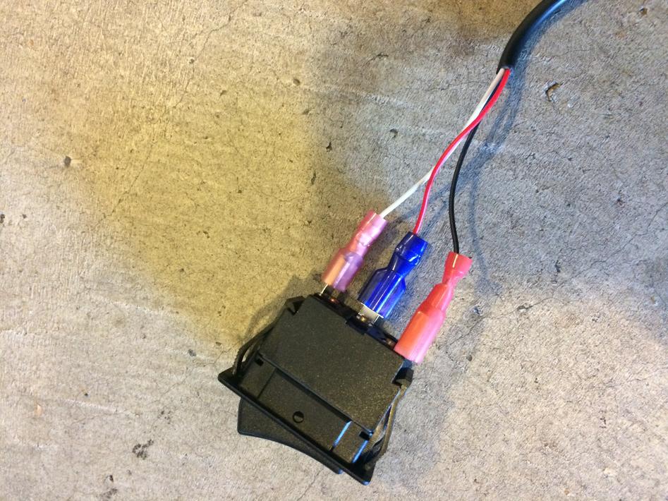

I didn't like the cheap switch that came with the lights so I cut the wire to that switch and I bought a GB Rocker Switch, it took me awhile to figure out the wire combinations but I finally figured it out

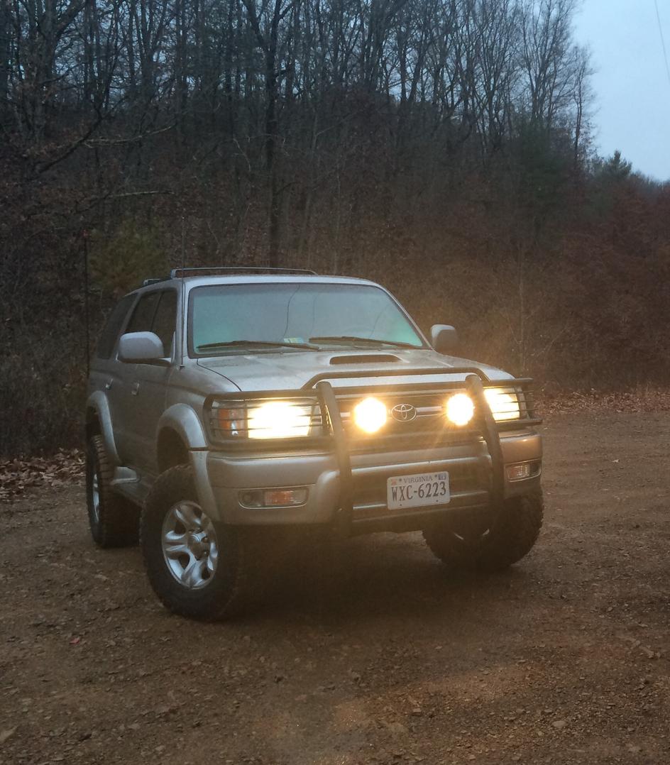

Finished:

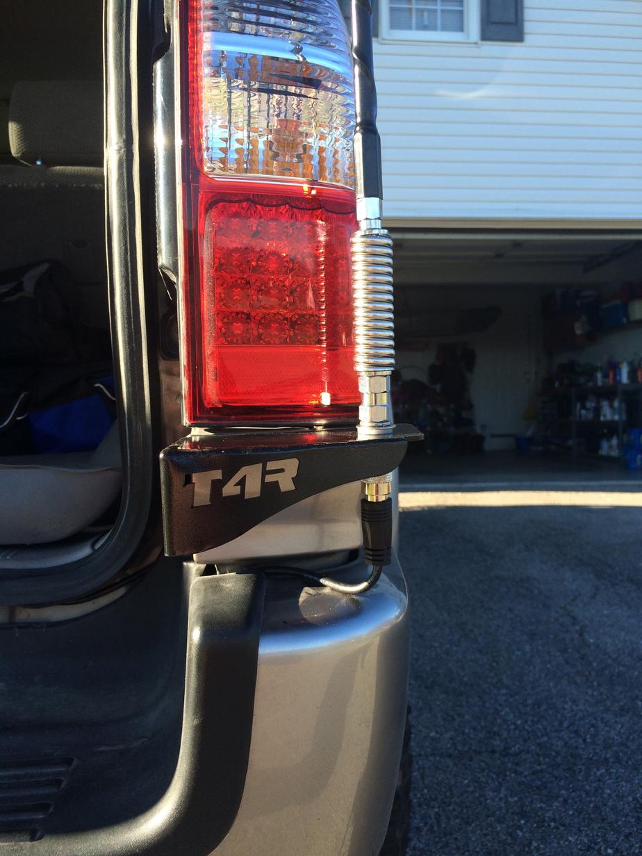

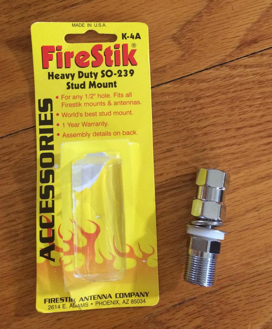

I also recieved my CB antenna mount from MStudt

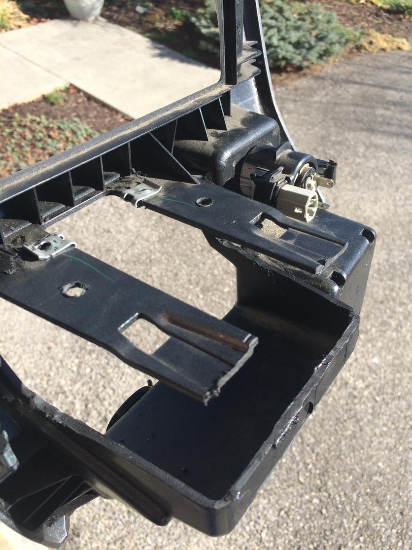

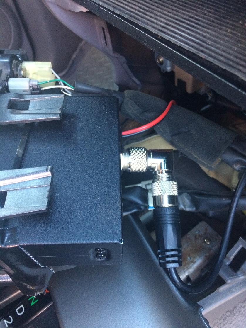

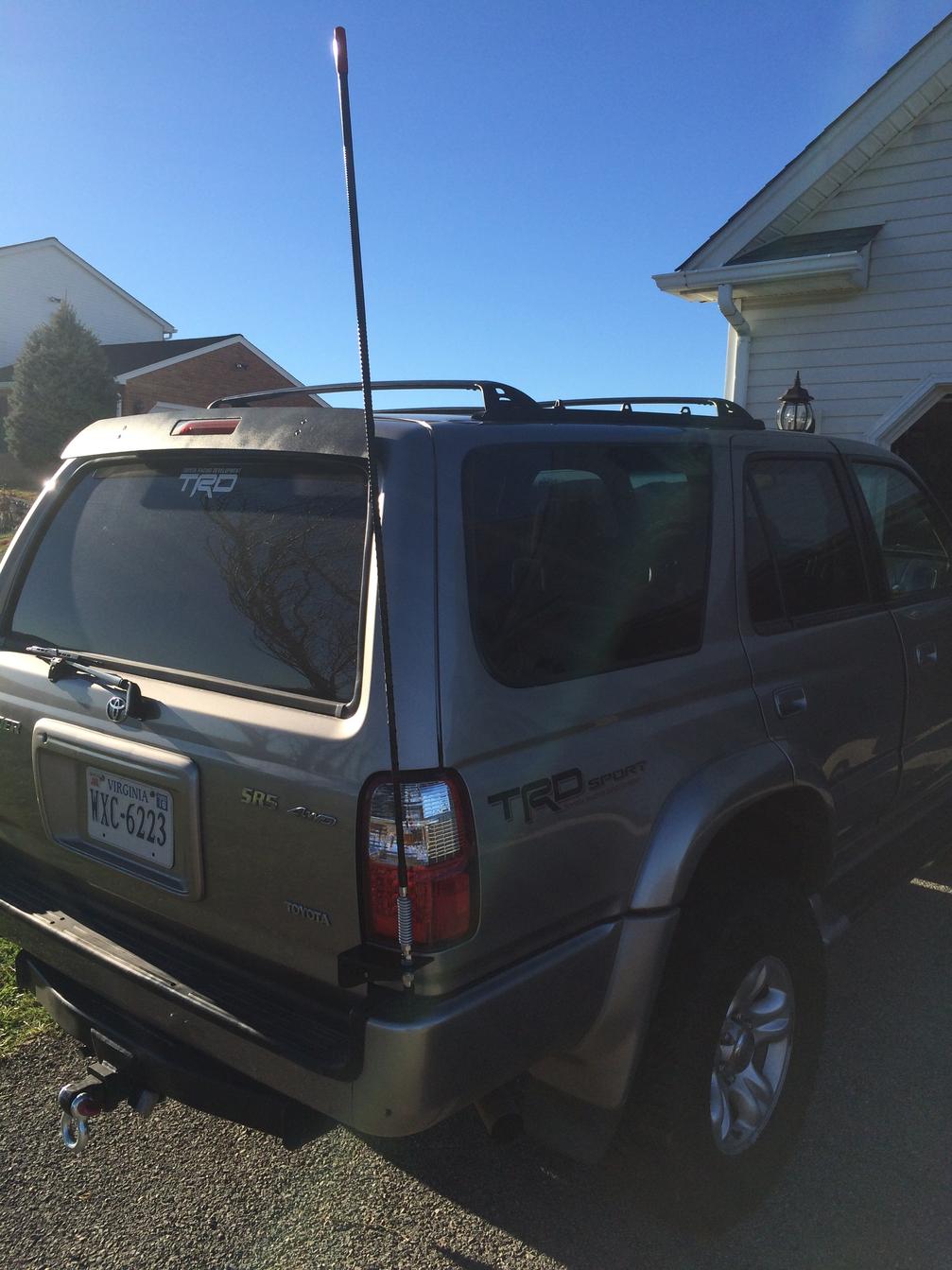

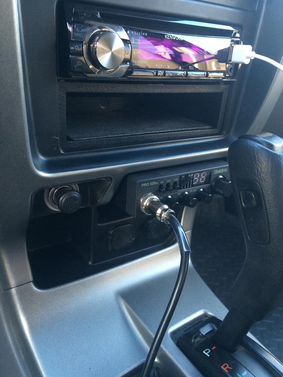

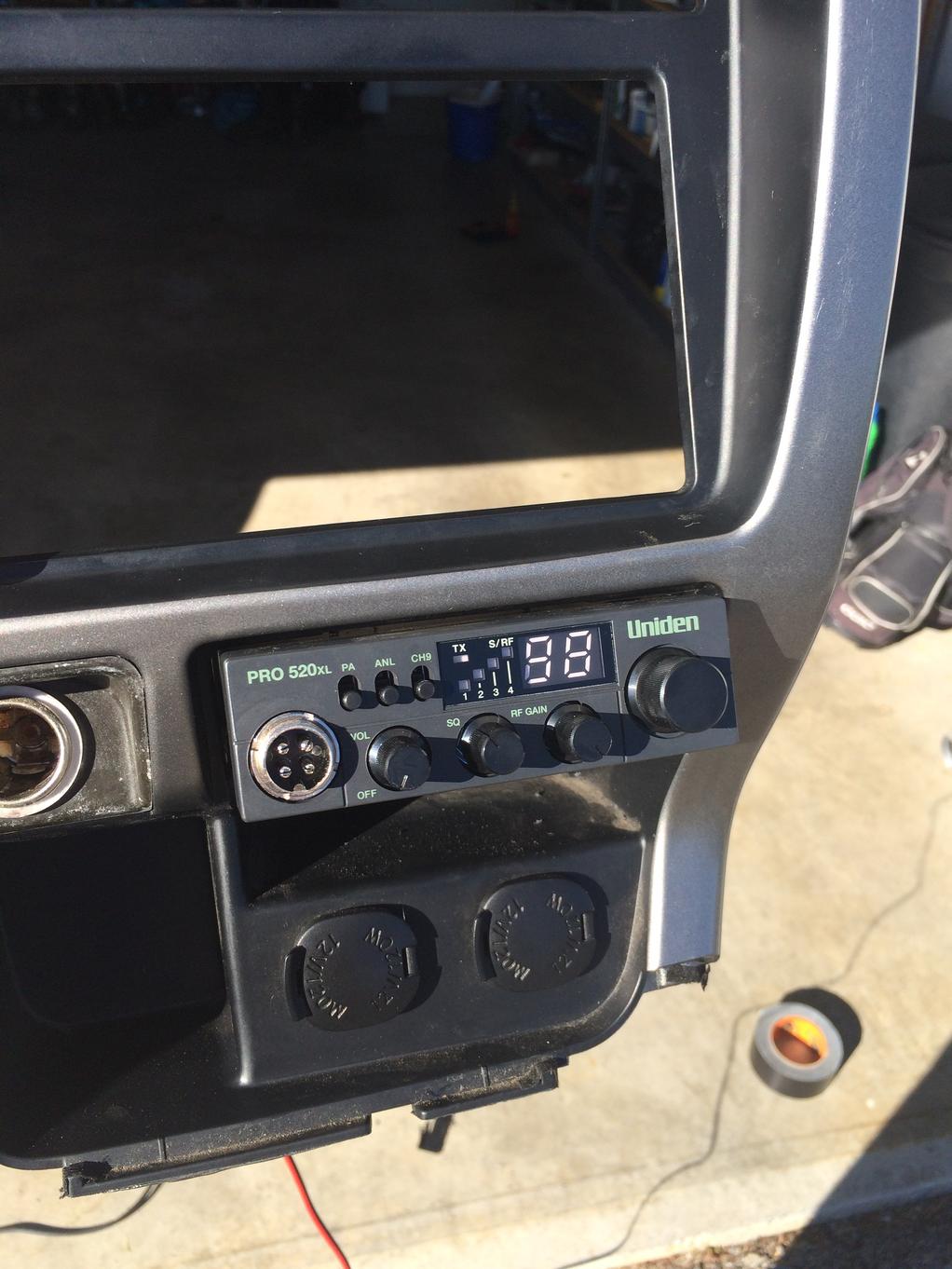

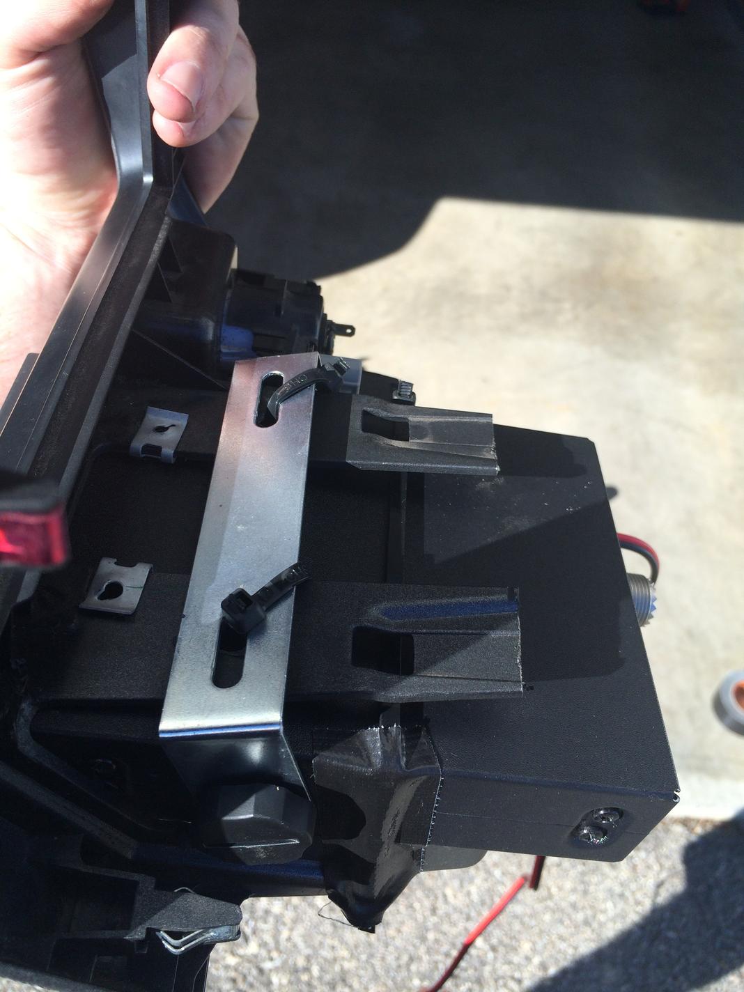

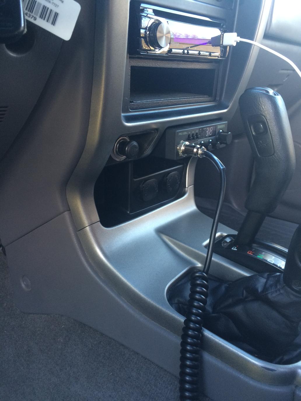

Installed CB
I finally had the time to install my CB!
I used a 90 Degree coax connector so I could mount the CB further in the dash

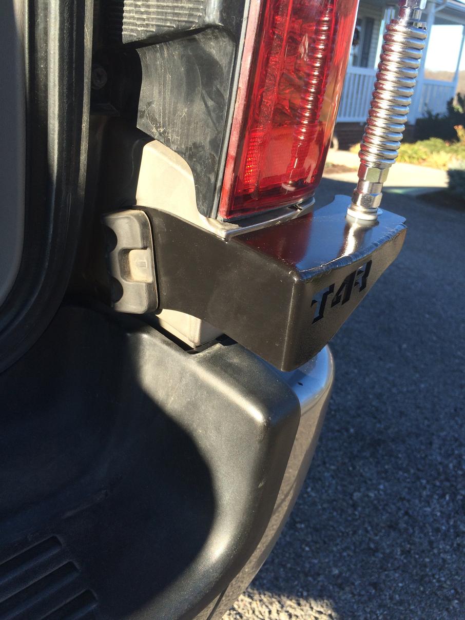

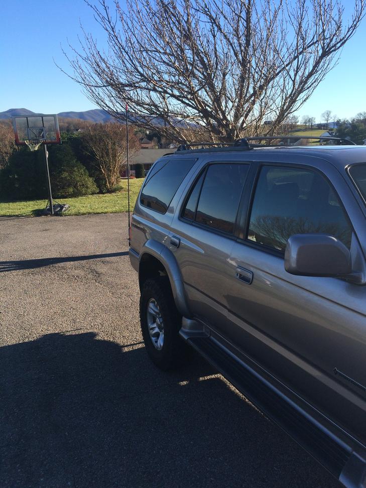

CB Antenna Installed
I used the mount from [MENTION=98153]MStudt[/MENTION] to mount my 4' Firestick Antenna.
