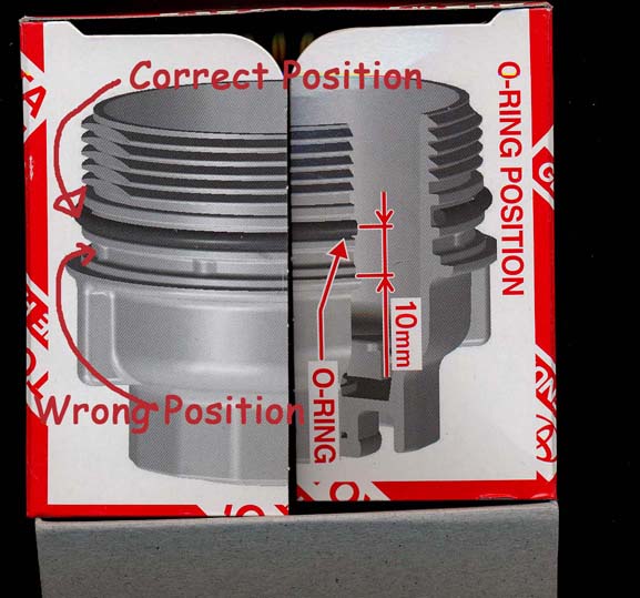

The 5th Generation cartidge filter design allows for the slow oil leak you describe if the monkey that installed the filter is careless. Attached is a scan from inside the filter element box. It shows the correct position for the large O-ring included with the element. Unfortunately, it's possible to put the O-ring in a second(Wrong) position that allows for the slow leakage you seem to have experienced. Sure would be good to watch the disassembly process. The filter can't leak if the O-ring is in the correct position, even with the cap not torqued. It will leak, regardless of torque on the cap if the O-ring is improperly installed, which is what it sounds like to me. Good luck!
Froggy, that's a great pic. OP should definately take a pic of the O-ring location immediately after removal from the car.
