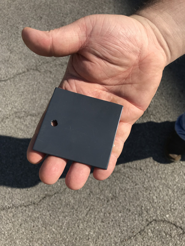

Sold my TRD wheels and bought two sets. Dropped one set off this morning at the powder coater to get the "darker grey" color as seen on the new production 70 series.

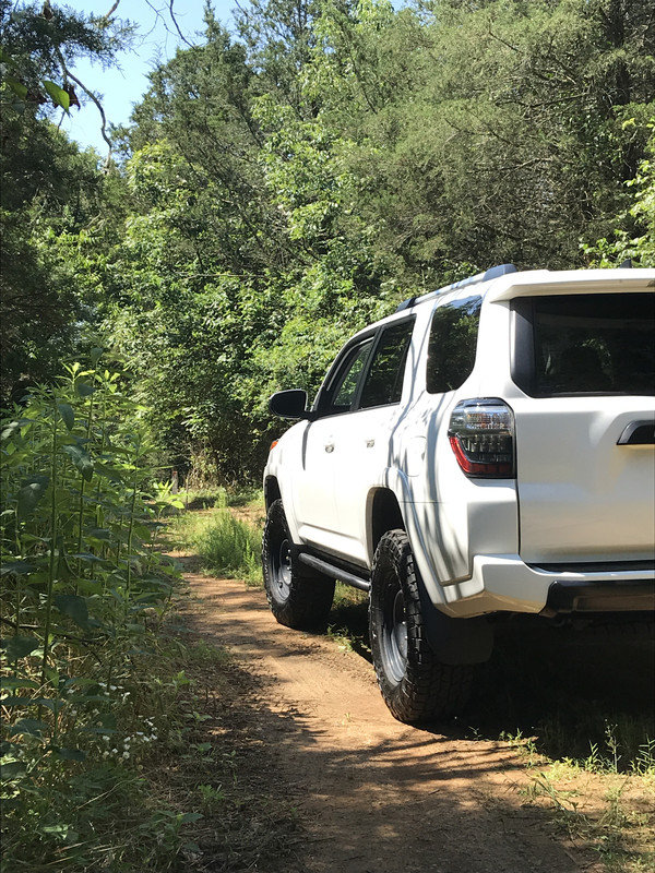

Black set is on there now, 285's no issues. I do have a Toytec / Dobinsons setup though.
Color for second set:
Oh man... that's beautiful. Please keep us posted !
