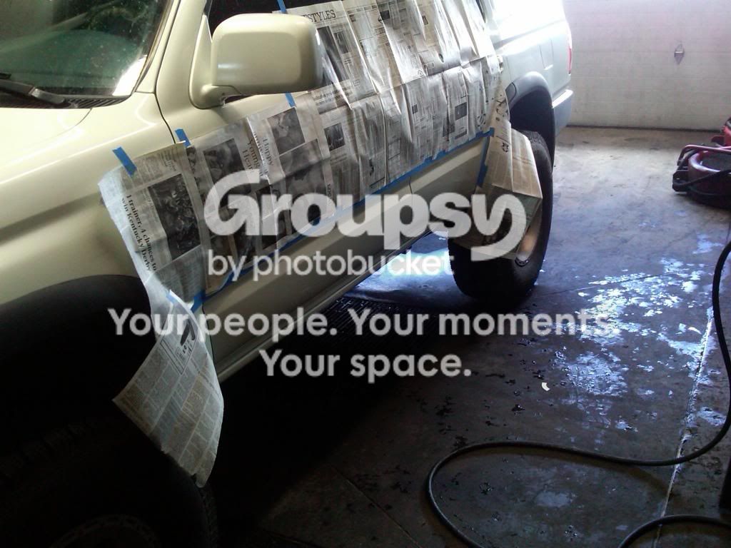

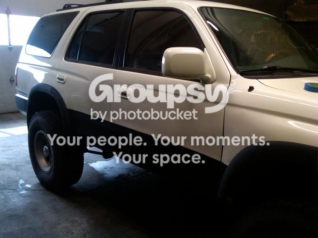

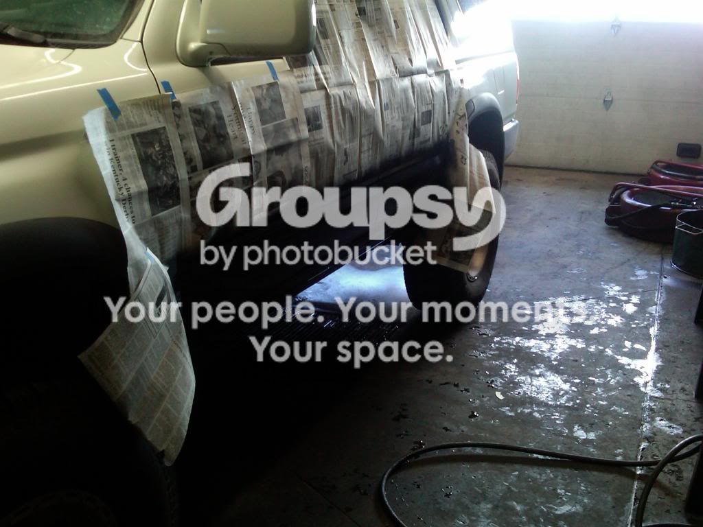

i have bedlined the rockers on several rigs of mine and used undercoating, i figured i would try plasti-dip this time. suppose to hold up good and when your tired of it you can just peel it off.

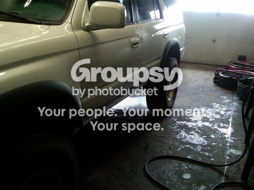

pulled it into the wash bay at work and got it all cleaned up
taped it all off
i learned one thing about it, when you get ready to pull the tape off, run a razor blade over it or it tries to pull off with it

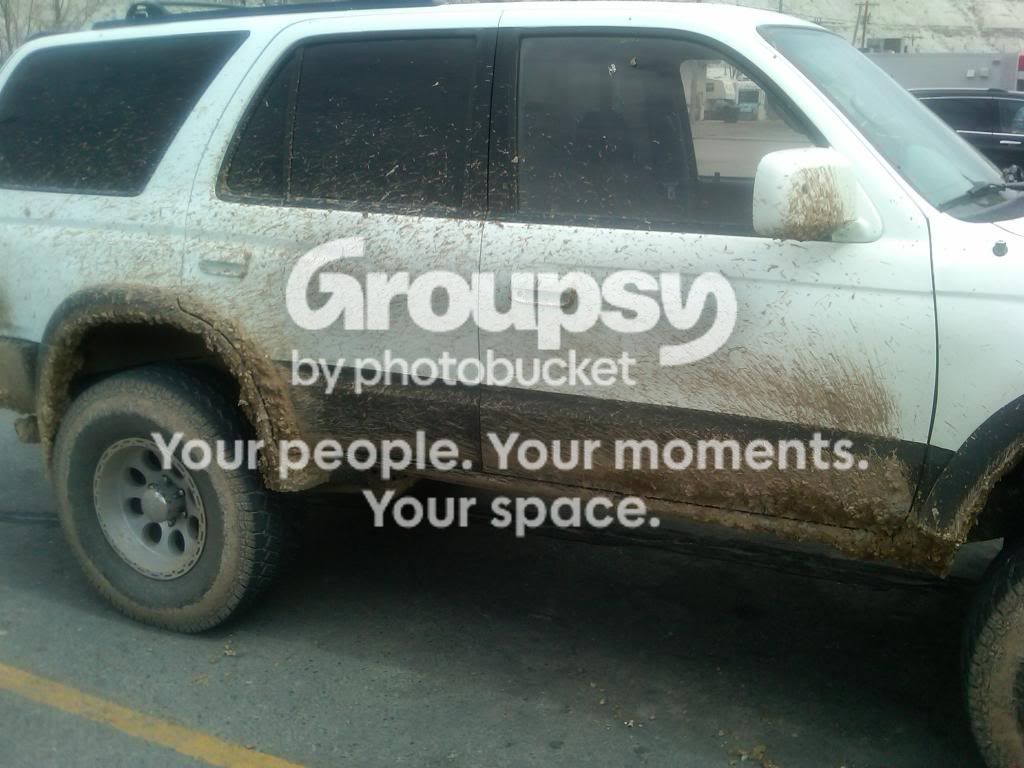

wasnt much for snow but there was some mud, this stuff was horrible to clean off. i also learned that while most people say you can pressure wash plasti-dip and it wont come off, dont try it with a 220 degree pressure washer. it all came off

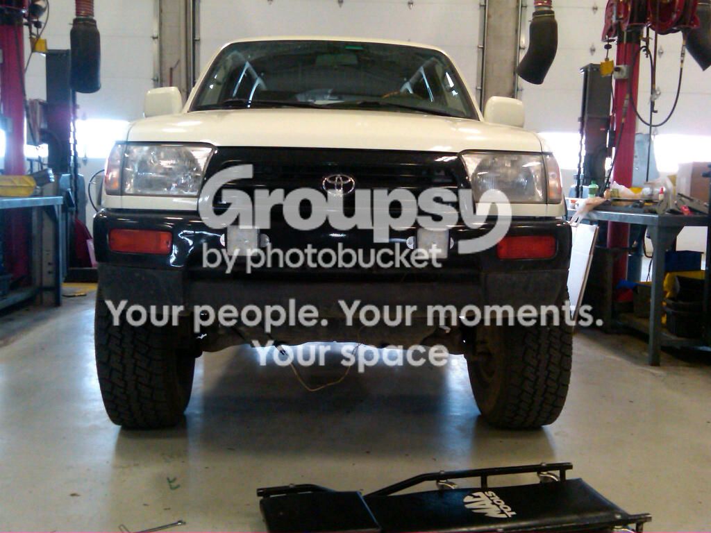

so i stayed late lastnight at work to build my roof rack only to find out our welder isnt working right. so i tinkered with a few smaller things and went home.

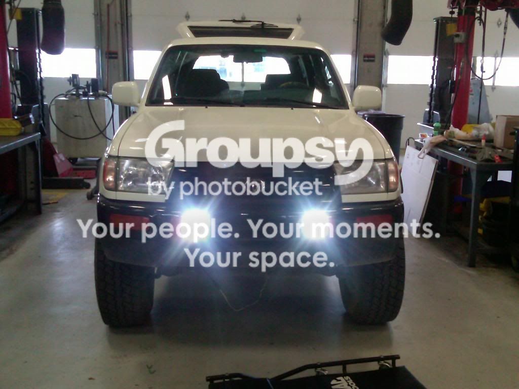

today i came back in and worked on some other projects for the runner. since i didnt have a roof rack to mount my lights too, i mounted 2 of the 4 on the front bumper since i wont be building my bumper till my dad brings my welder and plasma next month after the family reunion.
(i zip tied the wires up after the pic)
they are 15W five LED 60 degree flood pattern

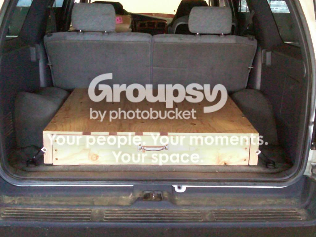

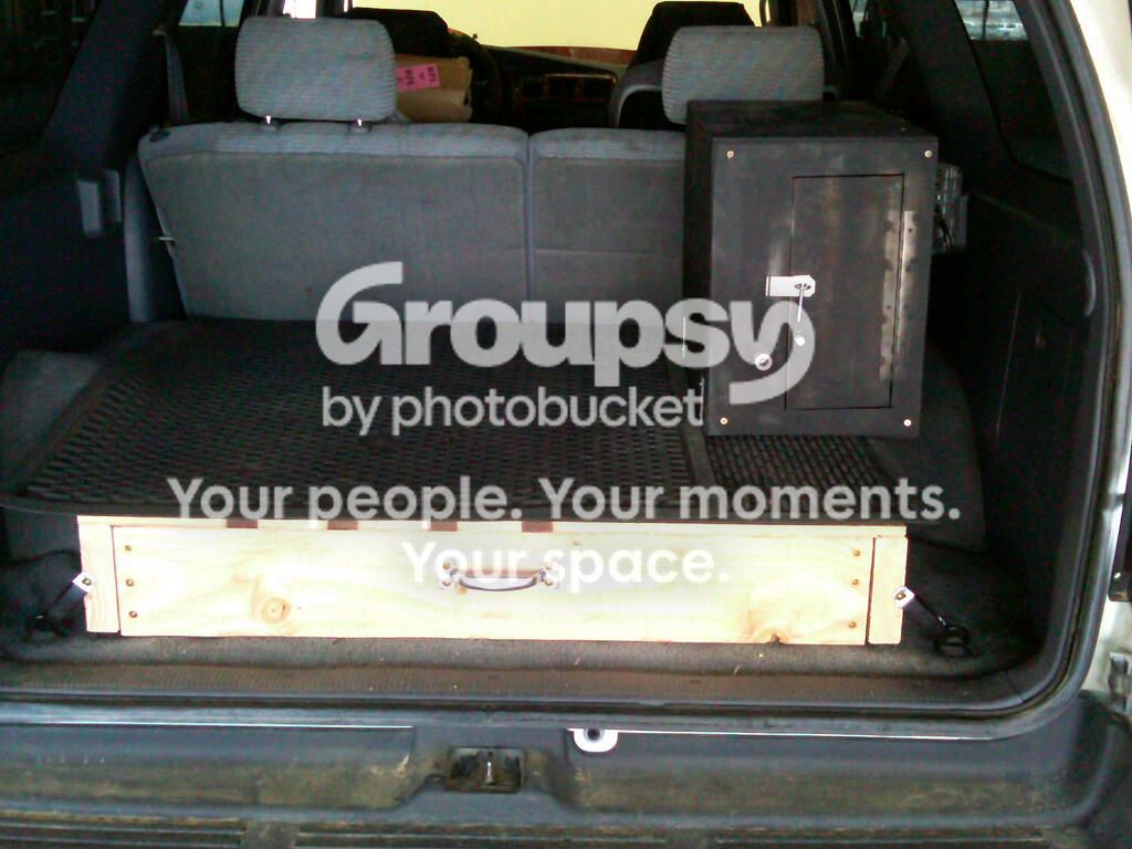

and i built a storage drawer version 1.0, nothing fancy no slides or anything, just friction. i didnt want to spend alot on it just to decide i didnt like having a drawer. later down the road ill see what happens. the black box was from my cherokee and has an air compressor with tank in itand the air chuck coming out the front. it is just a cheap compressor i picked up on clearance when i worked at o'reilly. i also mounted a new cobra power inverter onto the side of the box. the mat is just an old rubber floor mat we were going to get rid of at work, i cut it so one part stays under the air compressor box and we can pull the other half out and put it on the ground for my kid to stand on if we need to clean him off or anything like that.
dont pay attention to the faded paint on the box lol i painted it 2 or 3 years ago

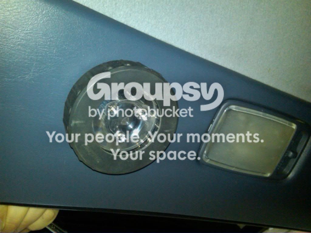

after some issues between the dealer, the state of utah, and the state of wyoming, i now have plates on the 4runner. i havnt wanted to do much work on it since there was the chance i was gonna have to give it back to the dealer. so this really isnt much of an update since all ive done sine the last time was replace the door jamb switch fixing my dome light.

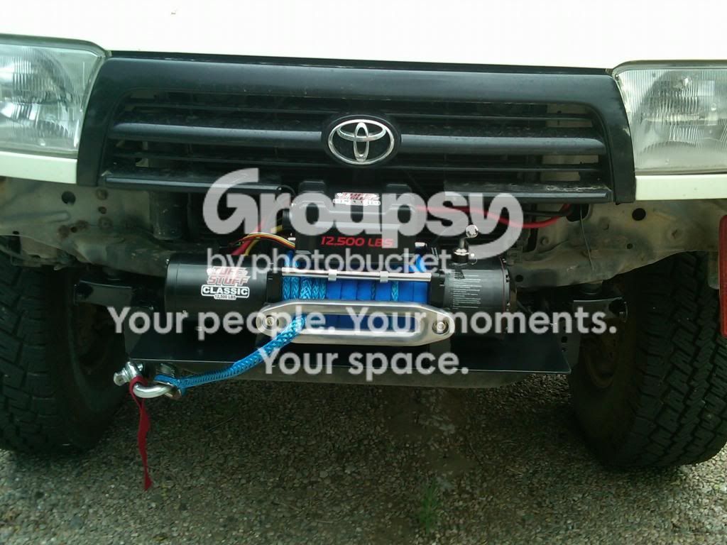

changed my winch/winch bumper plans. i was going to run my WARN 8274 with synthetic rope, but with trying to find a bumper design i liked and could fit the massive 8274 without blocking the whole radiator. a member on another forum suggested this winch TUFF STUFF 12,500 lbs Premium Winch Kit | TruckandWinch.com he has been running one for a while along with a couple of his friends, and at that price i figured i couldnt beat it, im still gonna put my synthetic rope and hawse fairlead on it though.

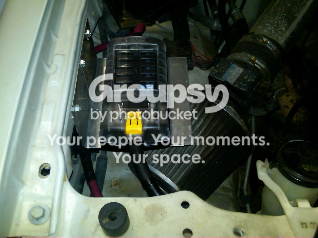

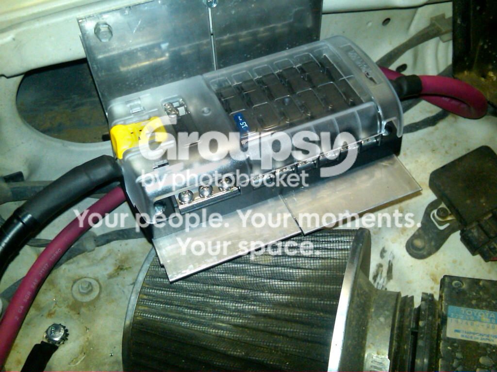

picked up a blue sea fuse box and got it installed, 125A breaker below it and 2ga wires

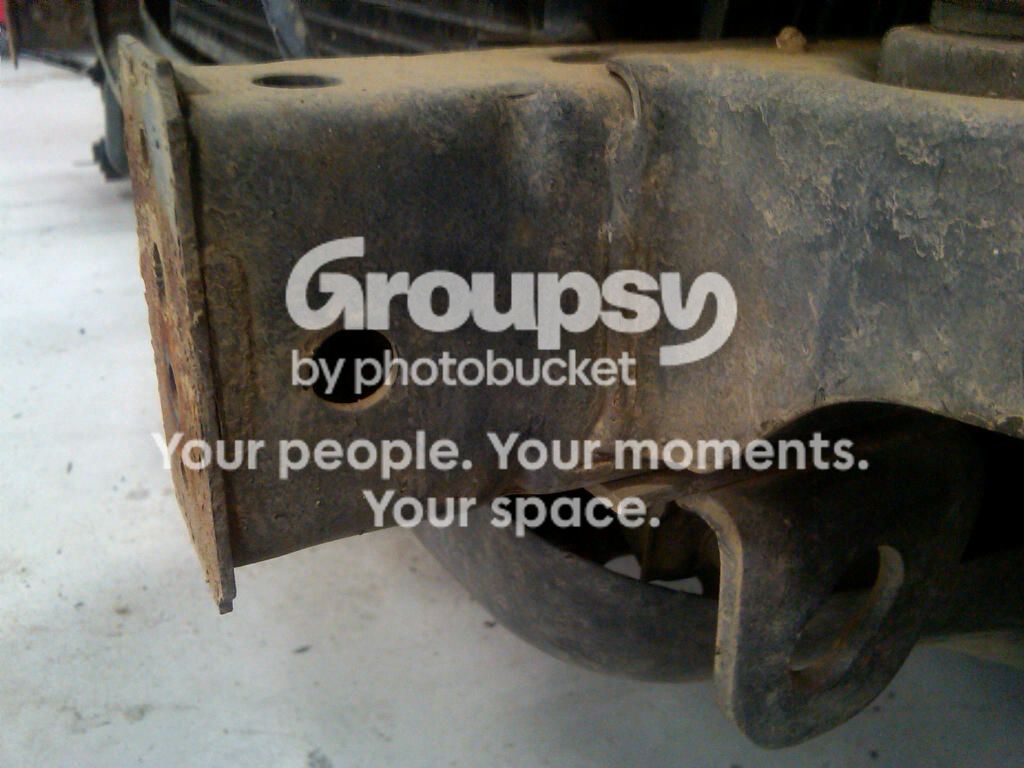

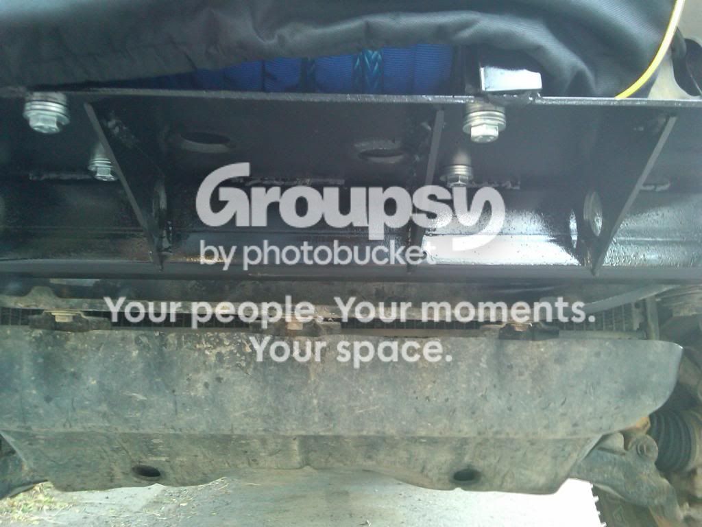

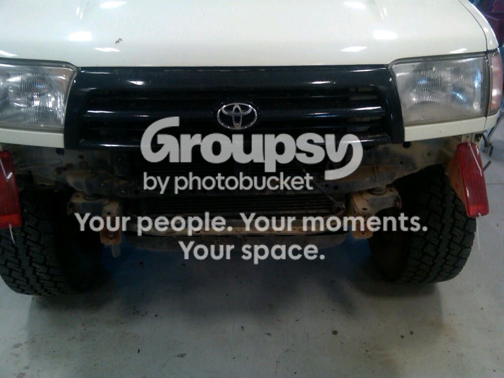

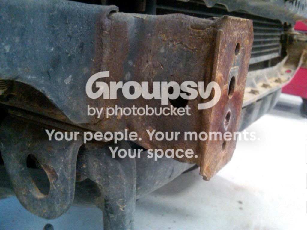

i had an hour after work lastnight so i pulled my bumper off to start mock up for my winch mount. found the passenger frame horn has been bent before and that has my engine skid askew.
straight
not straight
pimpin the zip tied lights

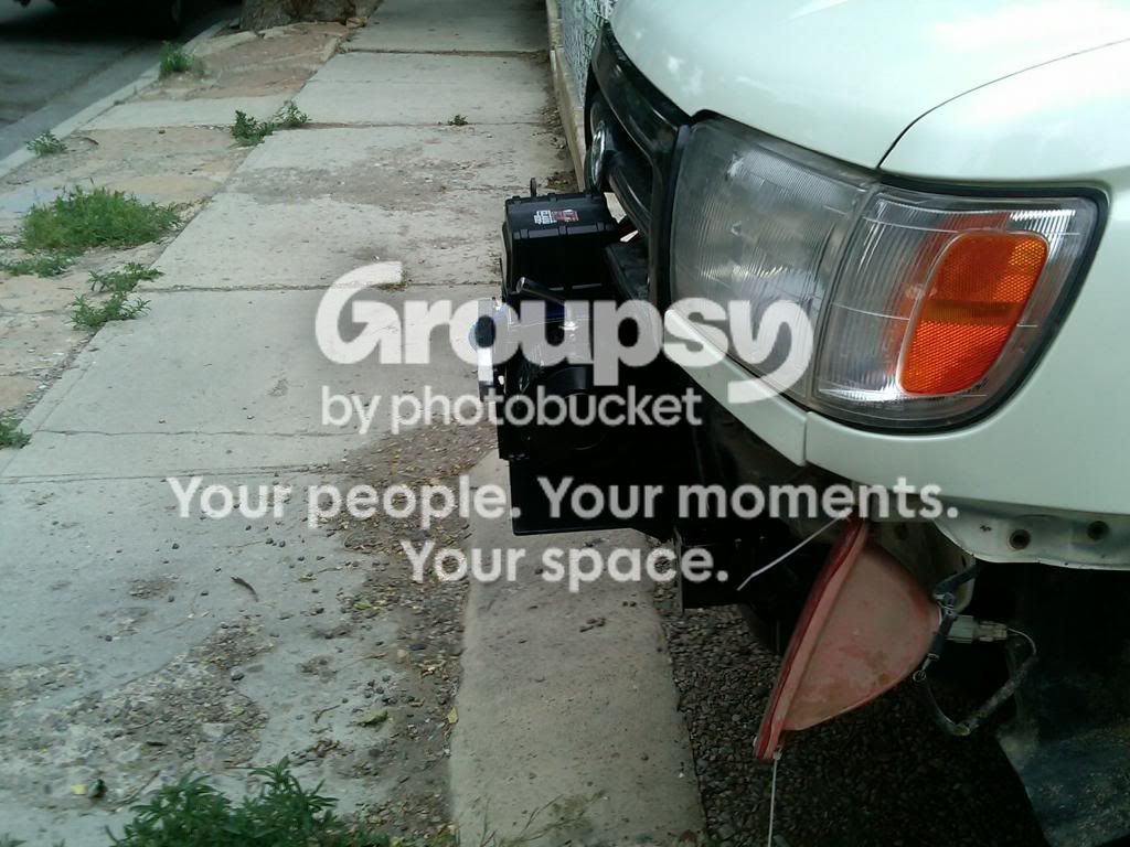

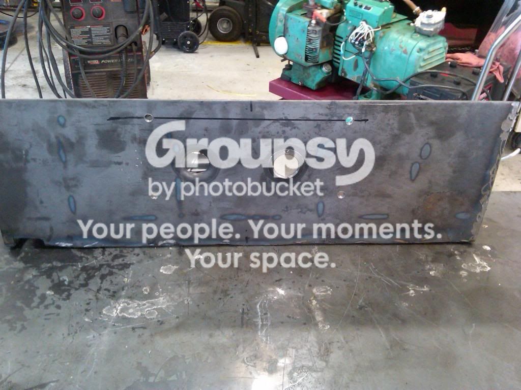

for now im just making my winch mount, later i will finish the sides and actual bumper

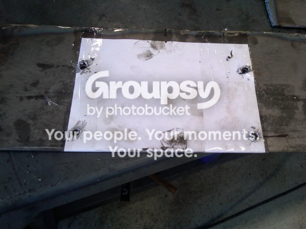

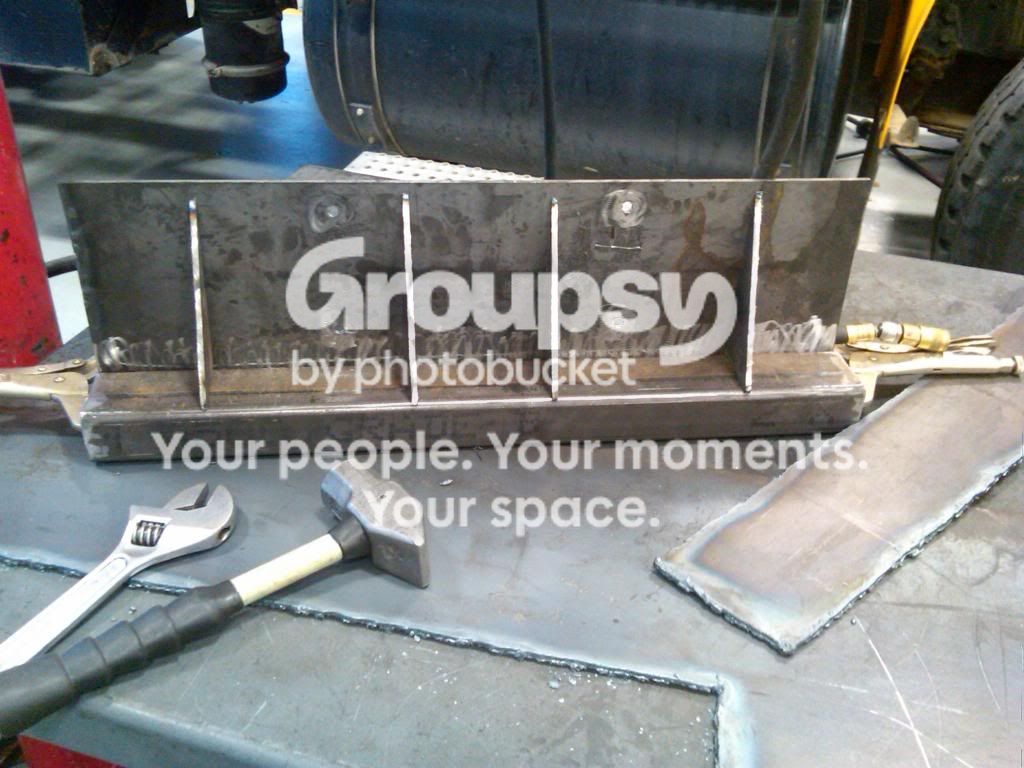

easy way to transfer the bolt pattern from the winch to the metal
supports
first time using my dimple die (note to self, make sure dimple die is facing the right way lol)
more dimples
i only dimples 6 holes, the pieces i cut out of the 6 holes weighed .25 of a pound. not much there but you can imagine if there were more dimples how much weight would be cut.
