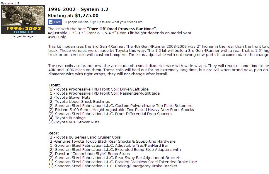

Does anyone know what rear coils I have on my SS1.2 kit in the rear? Wanting to pick up an airbag kit since we will be doing lots of towing in the future. I know they are fzj80 coils but not sure which ones. I need to order the correct bags
From Steve's website:
"Toyota 80 Series Land Cruiser Coils"
Which means Yes they are FZJ80 coils, not sure what you mean by "which ones." If you are looking at an Air Lift 1000 kit they're part# 60728
What he said !
Did you look on the Sonoran steel website?
It lists the coils and a bunch of other details. Friend you can find it by using google.
I'm saying that Steve lists all the parts in his kits on his website. You're right he doesn't list the part #s - this is probably so people don't try and just order the parts from Toyota directly.
If you are a customer of his then he will gladly tell you whatever you need to know over the phone. I've called him several times and he was always easy to get a hold of.
Link ----> 1996-2002 - System 1.2 - $1,275.00 : Sonoran Steel, Sonoran Steel Custom Metal Fabrication L.L.C. Custom Toyota Truck Parts

I'm a bit concerned regarding which kit to get. There are 2 other kits that look slightly taller. The 60747 kit is 1" taller than factory and the 60755 kit is 2" taller. The pics on Steve's site do not look like 8.5" bags
It is also my understanding that the the coils for the 1.2 kit are land cruiser fronts not rears....so the inside diameter of the coils might be smaller than land cruiser rears
I've been doing some research and actually measured my rear springs. With the truck sitting naturally, the measurement from spring perch to spring perch is 13". The ID of the spring is 4.75". When I called Firestone, they recommended kit 4134 OR for single bags they recommended 6022.
