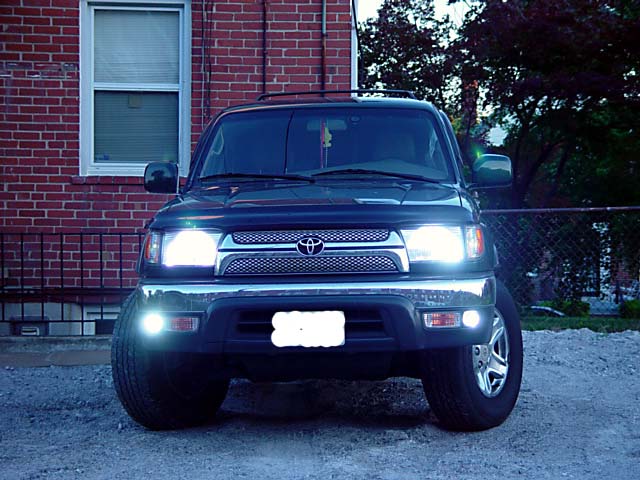

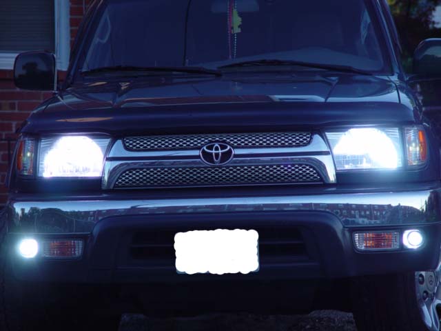

YES CHECK THE CONNECTIONS.9 TIMES OUT OF 10 THATS IT.
