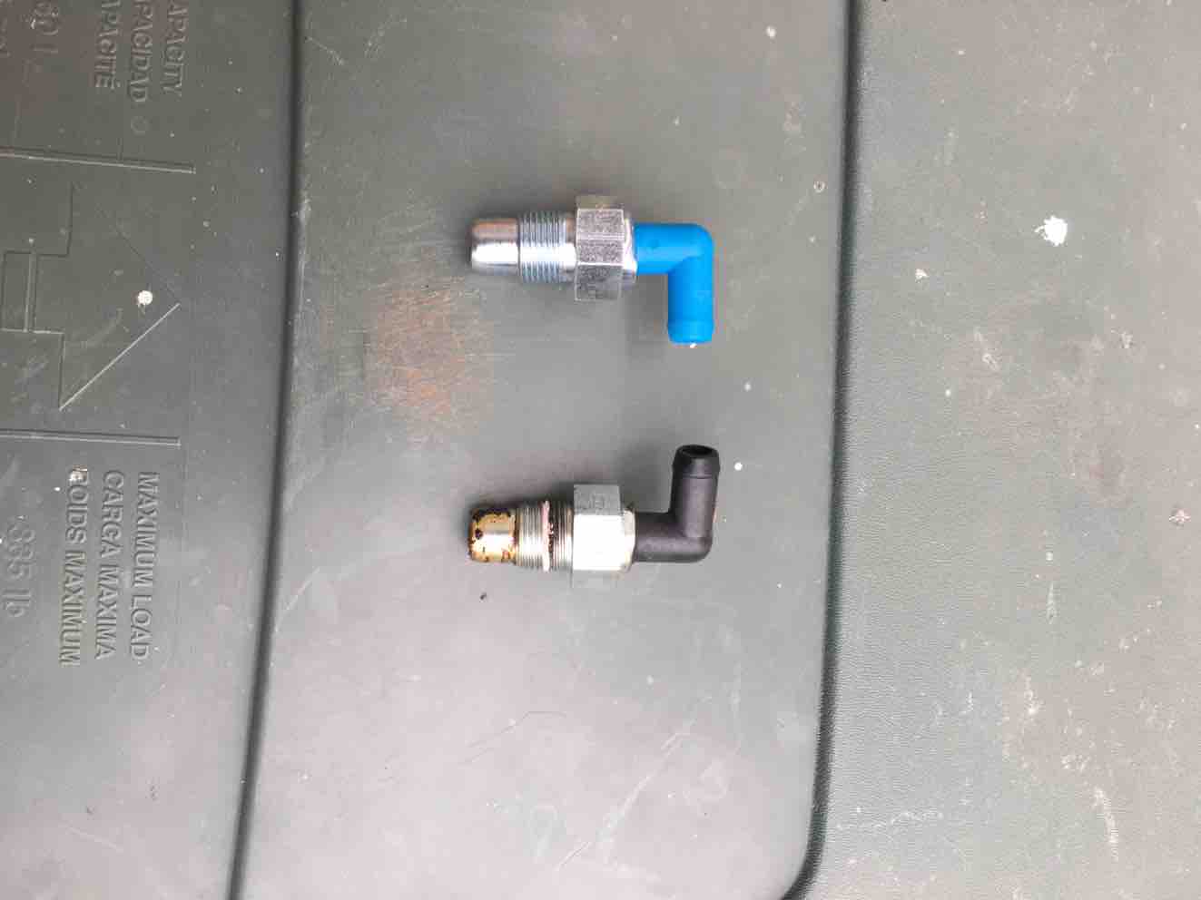

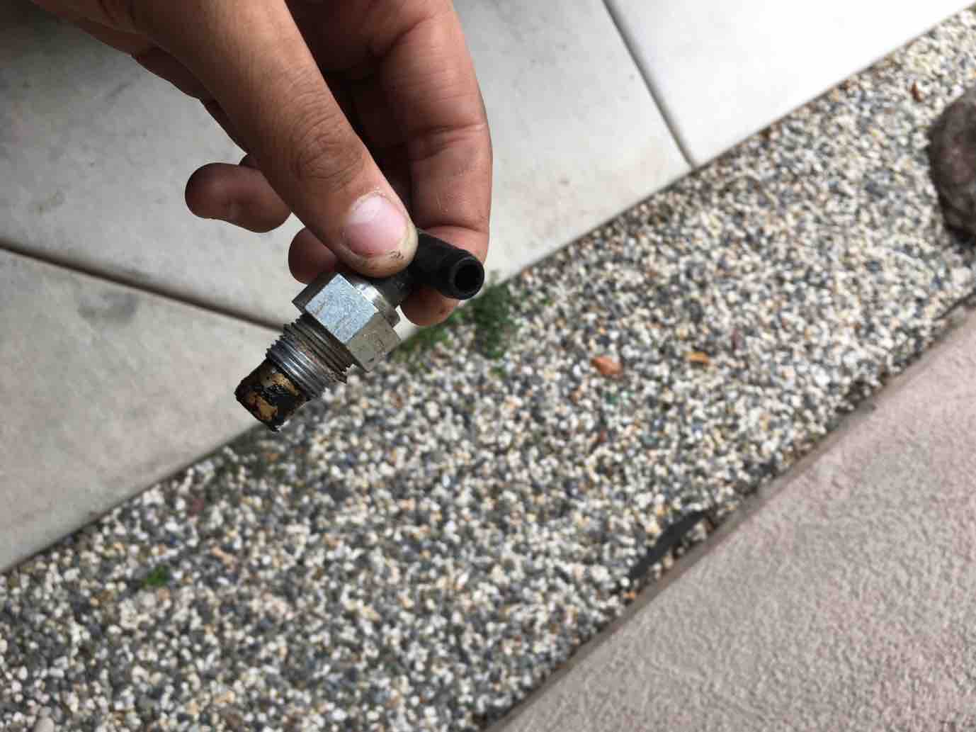

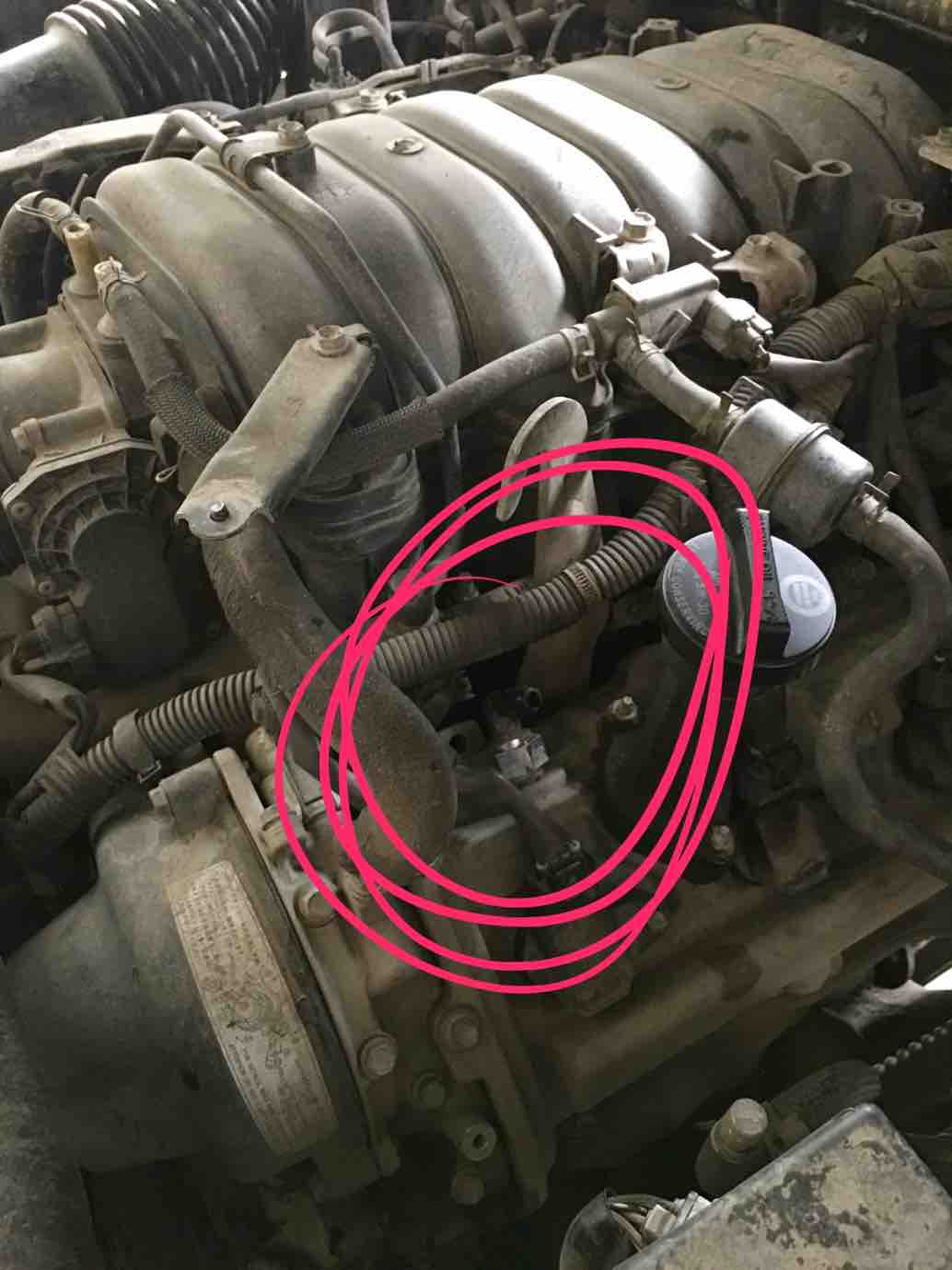

On that note, I decided I'd go through and get a few pictures of some stuff to note for our fellow 4.7 motor owners. One is the position of the PCV. It's under a sort of rubber cover so it could be tough to see at times. It's located on the driver side of the motor above cylinder one, here's a picture for reference.
And here's what it OE Aisan part looked like
And here it is relative to the cheapy I got to hold me off till I order a new aisan one
