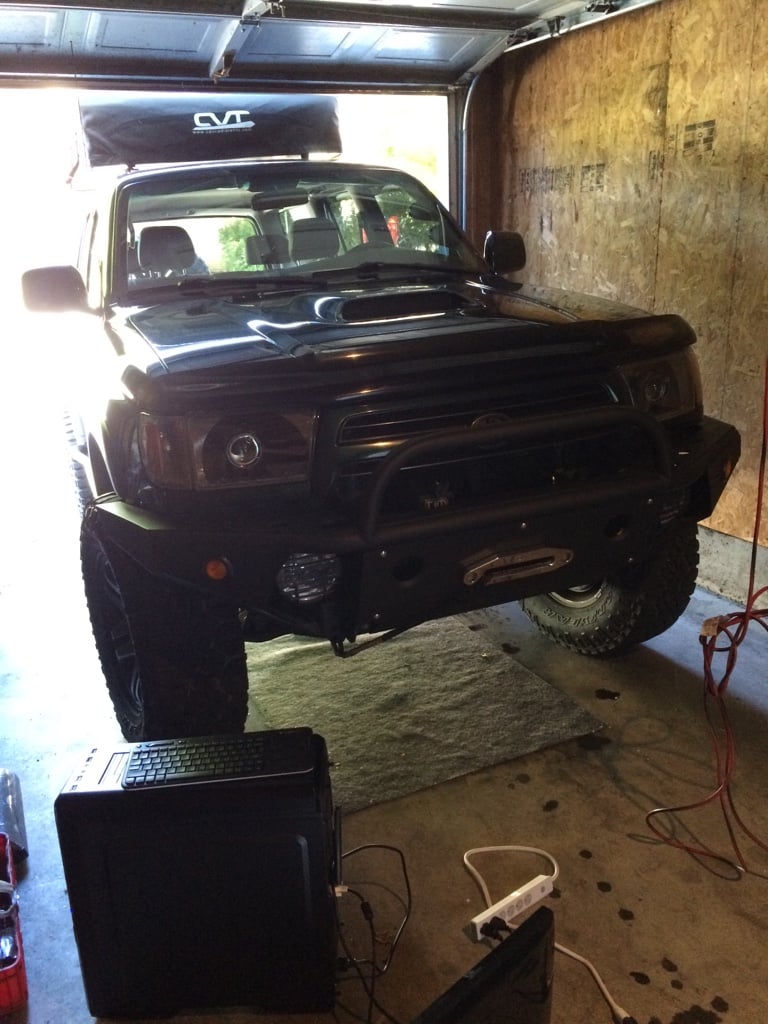

Going to install R4 on my desktop and carry this beast out to the garage to pull my tune. Dyno tuned for 7th injector/2.2 pulley with a couple small changes for when not at WOT...
Now to find my R4 disc... And kick myself for not installing a disc drive on my HTPC... it's much easier to move around.
So pissed. Photographic proof that I carried all this stuff to the garage before realizing I loaned my serial cable to a friend over a year ago.
There was a disc in my glove box labeled "map"... I'll check that out.
And that oil is from my little pickup... Not the 4Runner

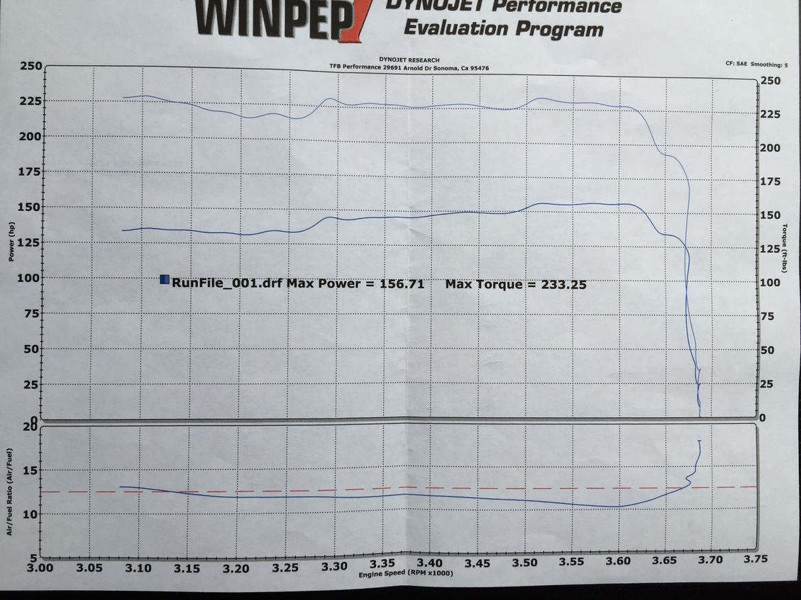

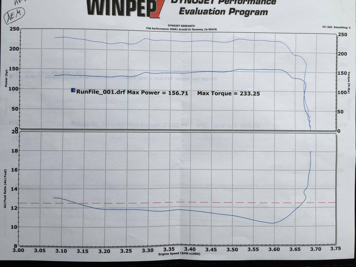

I'm also attaching the dyno results just in case that helps. One is the normal printout and the other is the same results just with the AFR larger.
The bottom of the charts say that it's firing. The air fuel ratio looks good. Maybe rich around 3600 rpm it's down around 10. Why did you only rev it up to 3000-3600 rpm.
Do you not have an afr gauge mounted in the truck?
Well, the dyno guy said it started running lean so that's why he let off. I wasn't in the car and I was standing aside while he did all this. He said the AFR was at 16 so he let off the gas. He said that would be why my car has been surging at open throttle and higher rpms.
And no, I don't have an AFR gauge. The dude recommended an AEM one and a boost gauge and said I could do some tuning while driving around since that'd be cheaper than doing it on the dyno.
