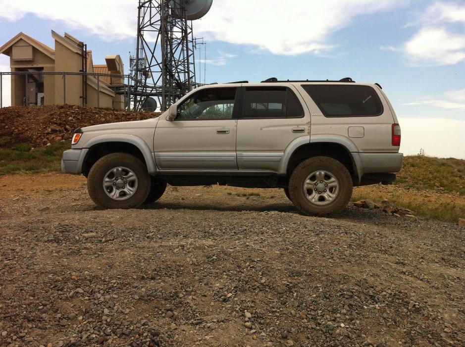

Tundra coils /5100s
on the lowest perch combined with the 906s/60028s in back with 10mm trim spacers will get you right around 2" up & 2.5"s in back. This is what im using and really like it.

I had the 906s with TRDs up front (similar to 881s) and the ride was great. I got just t 2" all around. I think you'd be happy with it.
Thanks for the info, that gives me a better feeling about the ride quality.

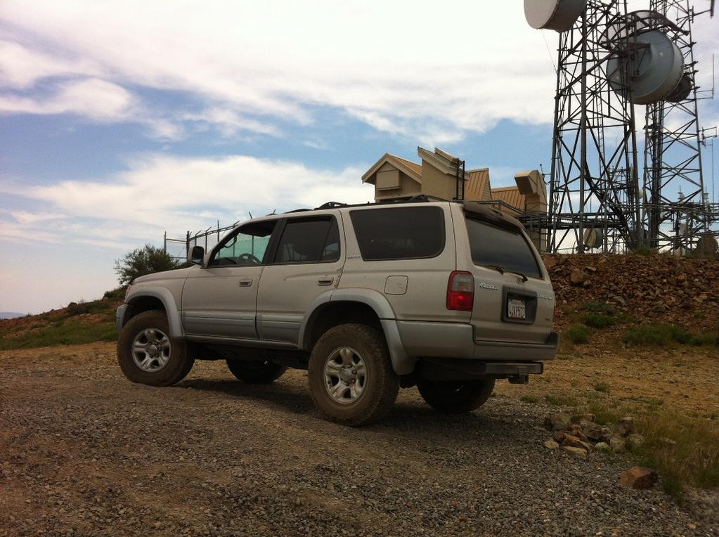

Ive had both the
881s and the TRD coils and i think the TRD coils ride better YMMV. Maybe b/c theyre a progressive spring rate and the 881s are straight spring rate. In my case it was worth it to buy the TRDs new. Sort of a side shot...

Thanks, looks good. I got one more yard to check for the springs, if it falls through new it is.

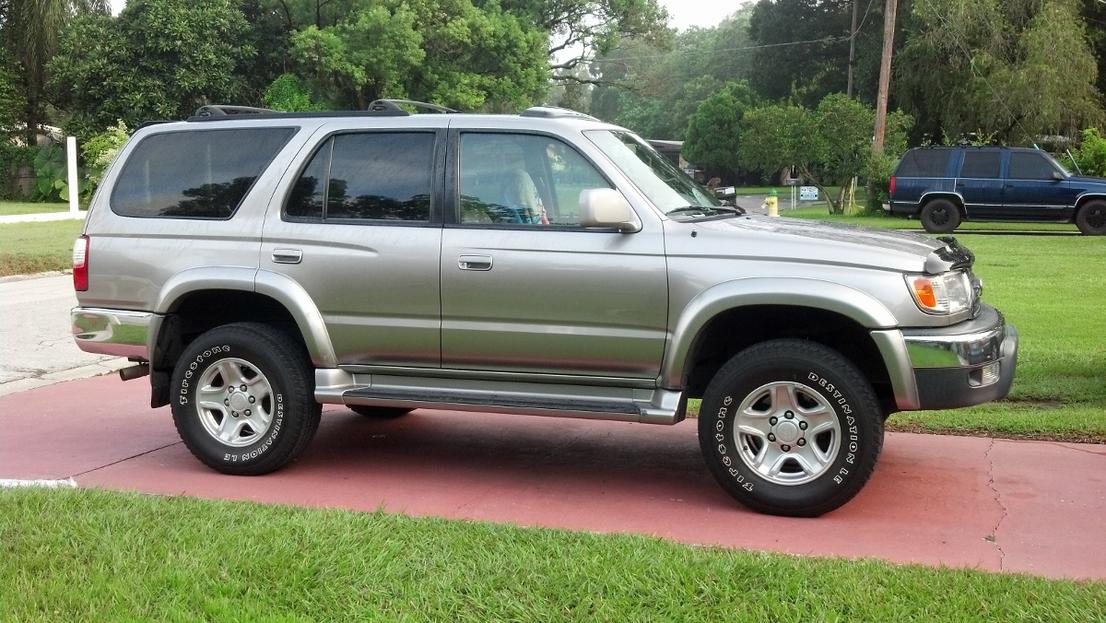

this is my truck. look at my sig to see what i am running on it. the stance looks great and it rides great too.

^^ Now that is an option I had not considered, using the stock coils on some 5100 shocks.
When you say "4th groove" are you counting from the bottom up or the top down? Top down I'm assuming.
Any chance you could take a measurement from the center of your wheel to the edge of the fender?

bottom up; that way it extends the strut. if i remember, the back is at 22", front about 21". it looks level in the photo but that is my friend's driveway and it drops towards the street. i thought it was level until i saw it parked on a more flat surface.
Cool, thanks for the info man.
Did you use the stock top plate and coil isolator or did you go with Tundra parts?
