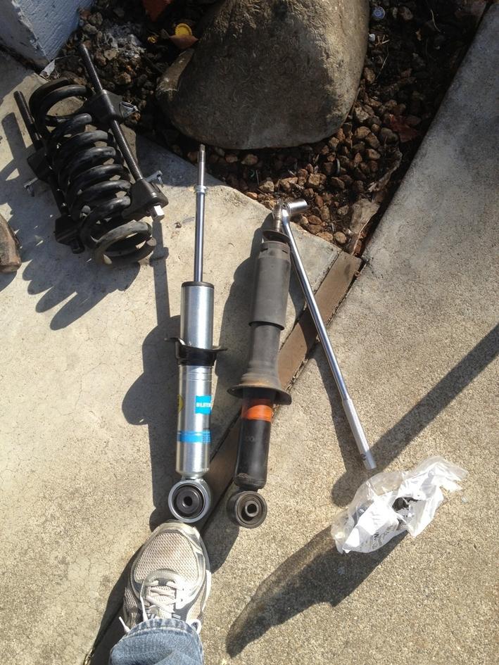

Well. I got my lift installed. I'm very disappointed. The rear went in smooth. However the front went easy too high. I put the shock on the second setting from the bottom with stock shock. The front gained about 3.25''. Over an inch hu higher than the rear and it rides like crap.
Is there any wat I can set The coil perch to the lowest setting without removing the strut assembly and compressing the springs???
With hand tools and a rental spring compressor its a pain in there ass.
I'm also getting driveshaft vibes due to this.

Yes they are. I am going to redo the front today. I'm sure i have the spring perch upside down. There are really no directions how to install the perch. It was reasonable to me that the perch does not go over the adjustment ring on the shock. But I guess it does. I'm too imbarrased to post the current lift picture. Ill post tonight. After its fixed.

Has to come back apart unfortunately. You're right it is a PITA.
That perch is upside down bud.

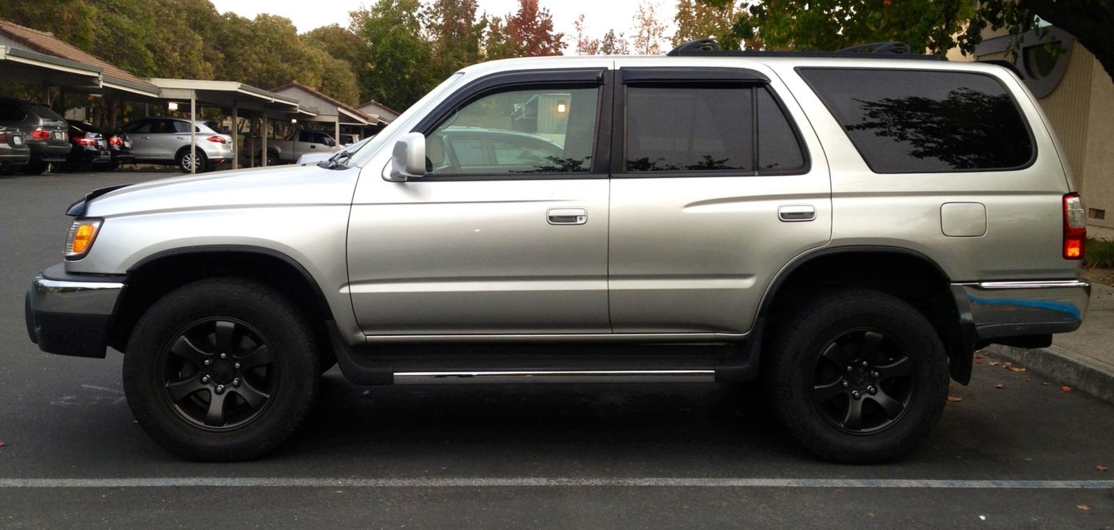

Well. Here is the end result. Lowest setting on the front. With the perch sitting correctly. Too much rake. Ill let the rear settle for a month till ill level it out. Ideally I'd like a .5" rear rake.
Initially I had it on the 3rd notch. but it still kind of look .5'' higher up front.
I will probably put it at the 2nd notch after the rear settles a bit. With he spring decompressed at the current setting its not too bad. I can probably change the setting 20 minutes per side including jacking up the truck.
The pain was messing around with the spring compressor. With hands tools its a killer.
As for handling... It could be better. It seems off balance because the rear is way more stiffer than the front. Plus the 2.5'' rear rake caused a lot of swaying.
