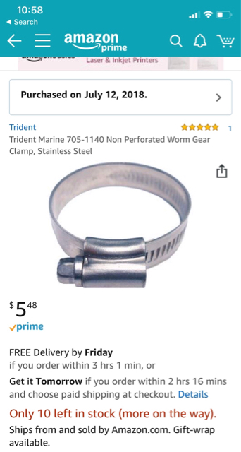

On the leaky CV’s - one of my boots started to leak shortly after putting 99 talls up front.
The factory clamps they have on them suck. I pried mine off and replaced it with a marine grade hose clamp - costs more but is stainless and has slightly rounded edges so it won’t dig in to the rubber
Also before doing that I shot some more Moly grease in there by using a needle attachment on the grease gun and slipping it under the boot edge.
It’s been good for the 1.5+ yrs since
