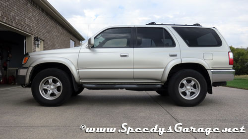

Before new tires and wheels. Stock suspension IS TRD wheels and stock tires.

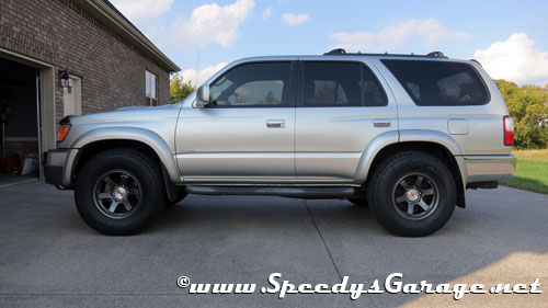

After 265/75R15 Bridgestone Dueller A/T Revo 2 tires and Level 8 MK6 wheels. To me, the larger tires upset the lines of the vehicle at stock height.

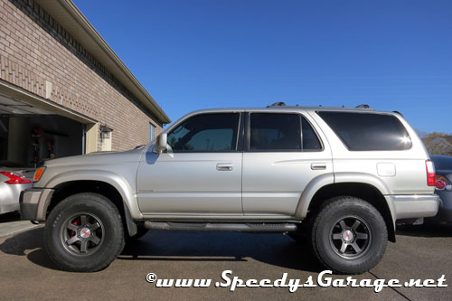

After 2" lift. For me this is perfect. Not too high and gives nice body lines and proportions for the tire/wheel combo.
sweet.. did you leave the front at the lowest setting of the struts?
Mines should look similar I hope.. Planning to leave it at the second notch of the strut with stock springs.

Yep, front is on the lowest setting. I "think" for 2" with the stock spring you want the 3rd perch, but double check me on that.

Well. I got my lift installed. I'm very disappointed. The rear went in smooth. However the front went easy too high. I put the shock on the second setting from the bottom with stock shock. The front gained about 3.25''. Over an inch hu higher than the rear and it rides like crap.
