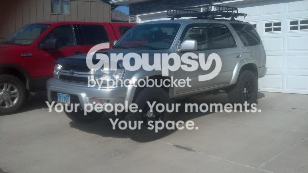

I went with the Daystar 2" because I needed a quick cheap lift to get rid of some rubbing issues with my rims. I went with the MK6's with the -12 backspace so they stuck out more than stock. also on 265/75/16 Duratracs.
P.S.-I went with the TRD center caps over the big 8 ones that came with the rims they're a direct fit
sorry, posted too quickly without reading the whole thread! post up some pictures when you get everything installed! I meant offset not backspace haha you have a good looking 4Runner Im jealous of your supercharger!
