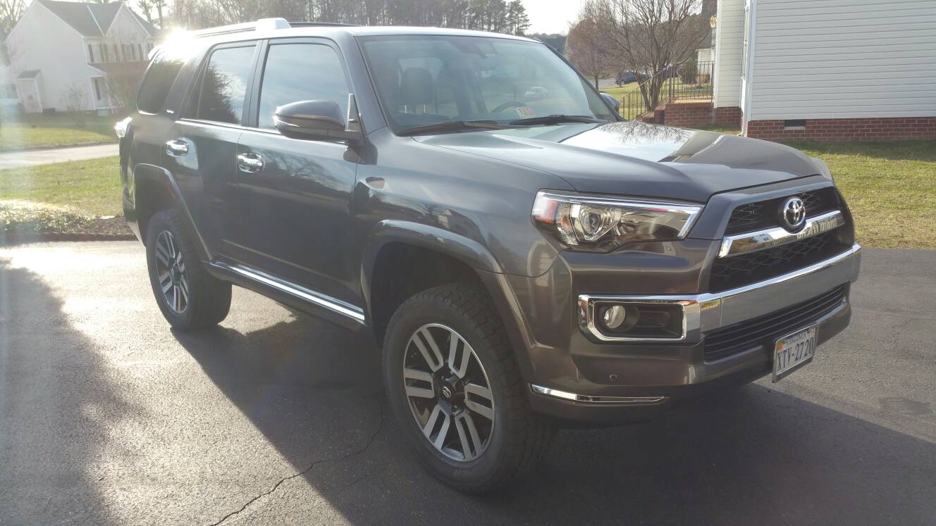

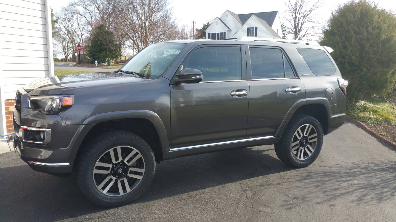

Got these installed yesterday. Let's see how they work out. If you don't hear from me ever again then it's probably a good bet that the 275/55/R20s were not a good idea. :lookout:
My uncle has been running the exact same setup for 4 or 5 years and zero issues he also tows a decent sized camper during the summer and come fall he spends a lot of time in the woods.

Cooper RTX 275/55/20 20170221_161354.jpg20170221_153956.jpg

Mamba M14 20x9 -12 Machined
BFG KO2 275 55 20
Pro Comp spacer lift
