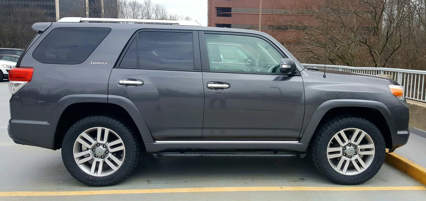

Just wanted to follow up on this thread as I ditched my 20" Limited wheels over the weekend and went to a new setup:
- First gen Tundra/Sequoia 17 x 7.5" wheels
- BFG KO2s in 265/70R 17
Biggest change for me is that the truck feels much more surefooted across the board. The OEM limited wheels and tires always felt like they were fighting back and not doing a great job of supporting the weight transfer of a 4,600lb SUV. We jokingly call them wagon wheels, but that's really how they felt to me.
This new setup is much more surefooted, much more stable - the 4R doesn't wallow as much, it's easier to steer and just feels more solid. Very happy with it.
I assume that even on the 20" wheels, those of you who have gone to 265+ tires might feel the same.
Usually, the lower profile 20" should provide less roll and wallow from sidewall. Must be the heavy sidewall on the BFG that gives the better feel. Guessing under very extreme cornering the 20" may be better.

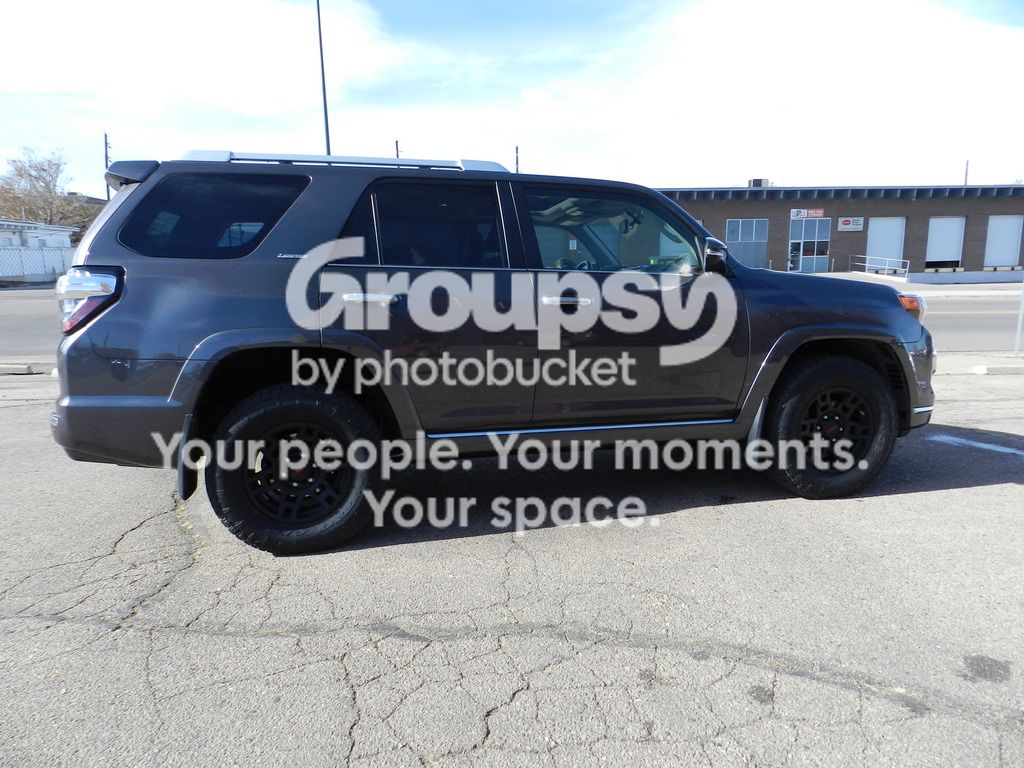

I really your combination, it compliments the Limited very well! In my opinion its the best look of 17" wheels on a Limited with it's boxy front and rear ends and lower rocker panel. It has a good balanced stance/look, better than any other 17" wheels I've seen on a Limited.
I have the TRD Pro black wheels on my Limited and to me it doesn't look right with the boxy styling. One of the reasons I'm going to swap the bumper covers to the SR5/Trail, but mainly I don't like the box look of the Limited.

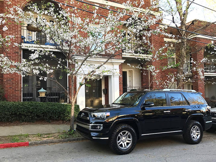

ive been asking all over this forum, and still no answers. can the 20 inch rims on the limited handle 275/55 profile tires? Anyone know how wide they are. (most of the toyota rims are 7.5 inches wide i believe, and I ? if that would accomodate 275 wide tires). thanks
To answer your question. This is my 2013 limited with 275 55 20. Just had mounted yesterday. No lift and no rubbing. Tire kingdom sold them and mounted them for me. I was out the door for 678 bucks. Way more cost effective than the 245 60 20....... Toyota really made a mistake by making these wheels only 7 inches. Technically they are out of spec but a 1/4 of an inch on each side doesn't bother me. I hope this post helps people save a lot of $$$$$$$$!!!!!! The truck looks more aggressive too! This is the size that should have been on these limited 4runners.

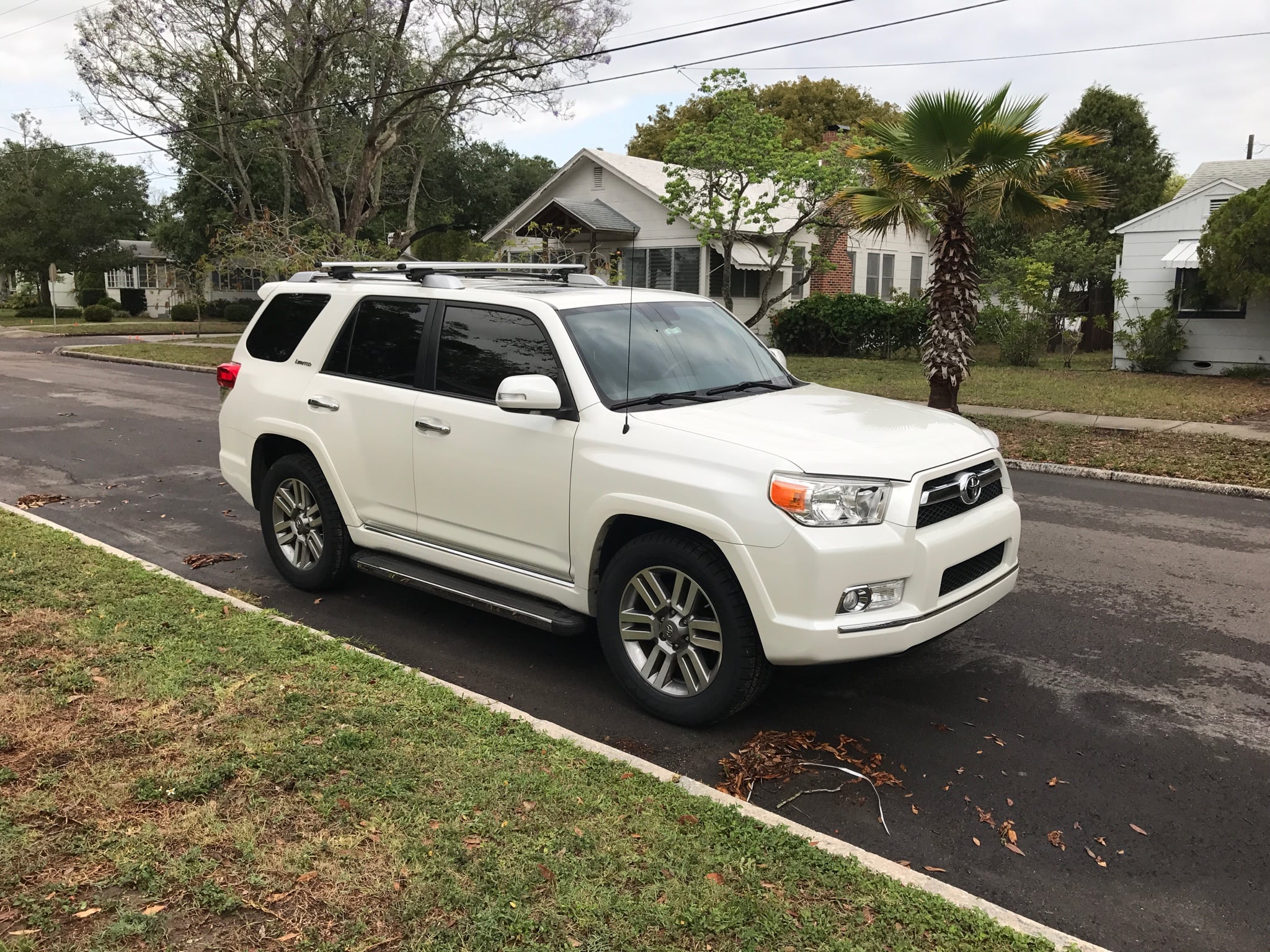

I'm coming up on a week with new Falken Wildpeak AT3W 275/55/20 and enjoying them so far. These replaced Cooper Discoverer AT3's 275/55/20.
Did you notice the ride quality improved? Coming from a 2012 4 runner sr5 and my 2017 limited bounces down the road. pretty annoying. Wanted to go bigger but keep the rims.
