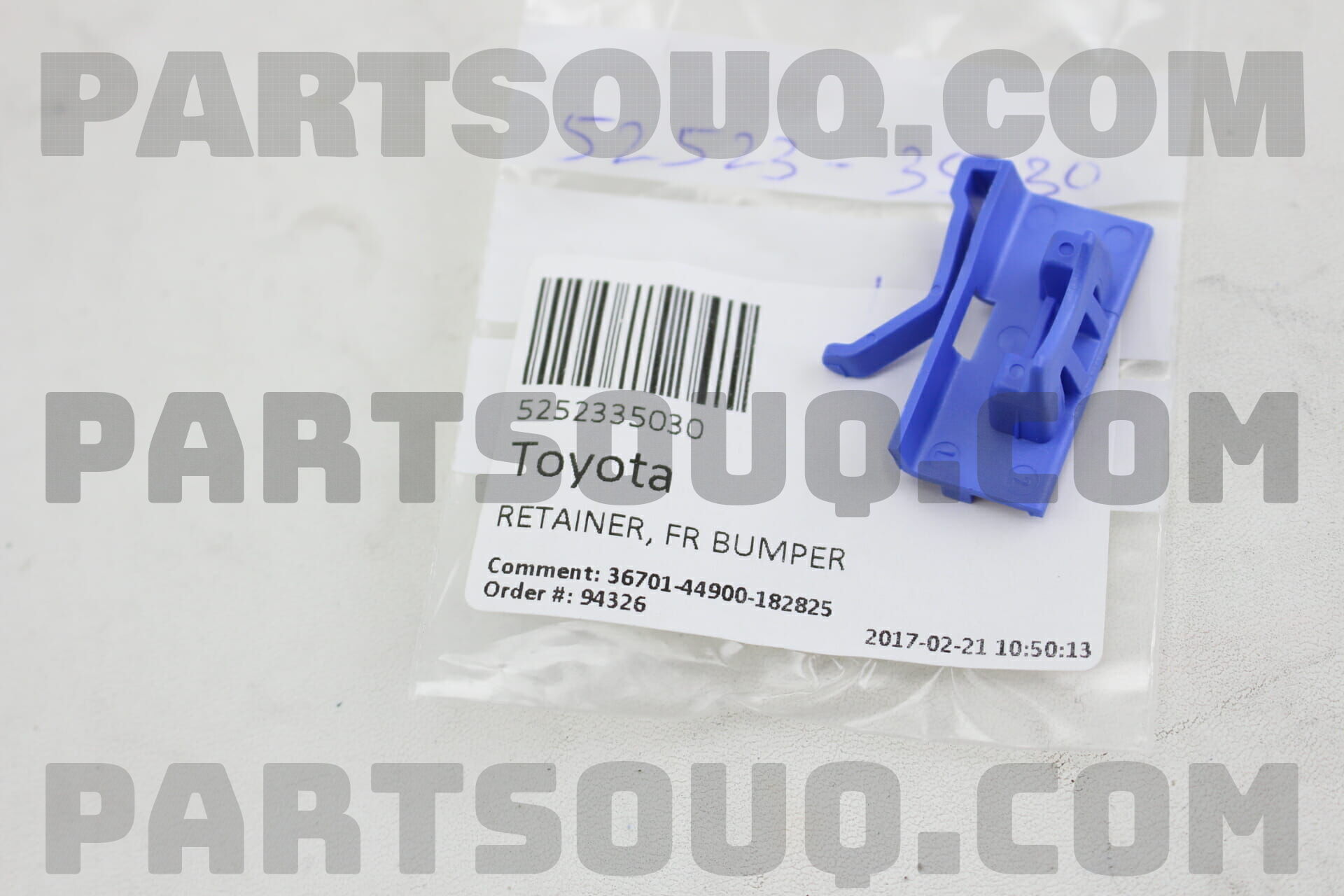

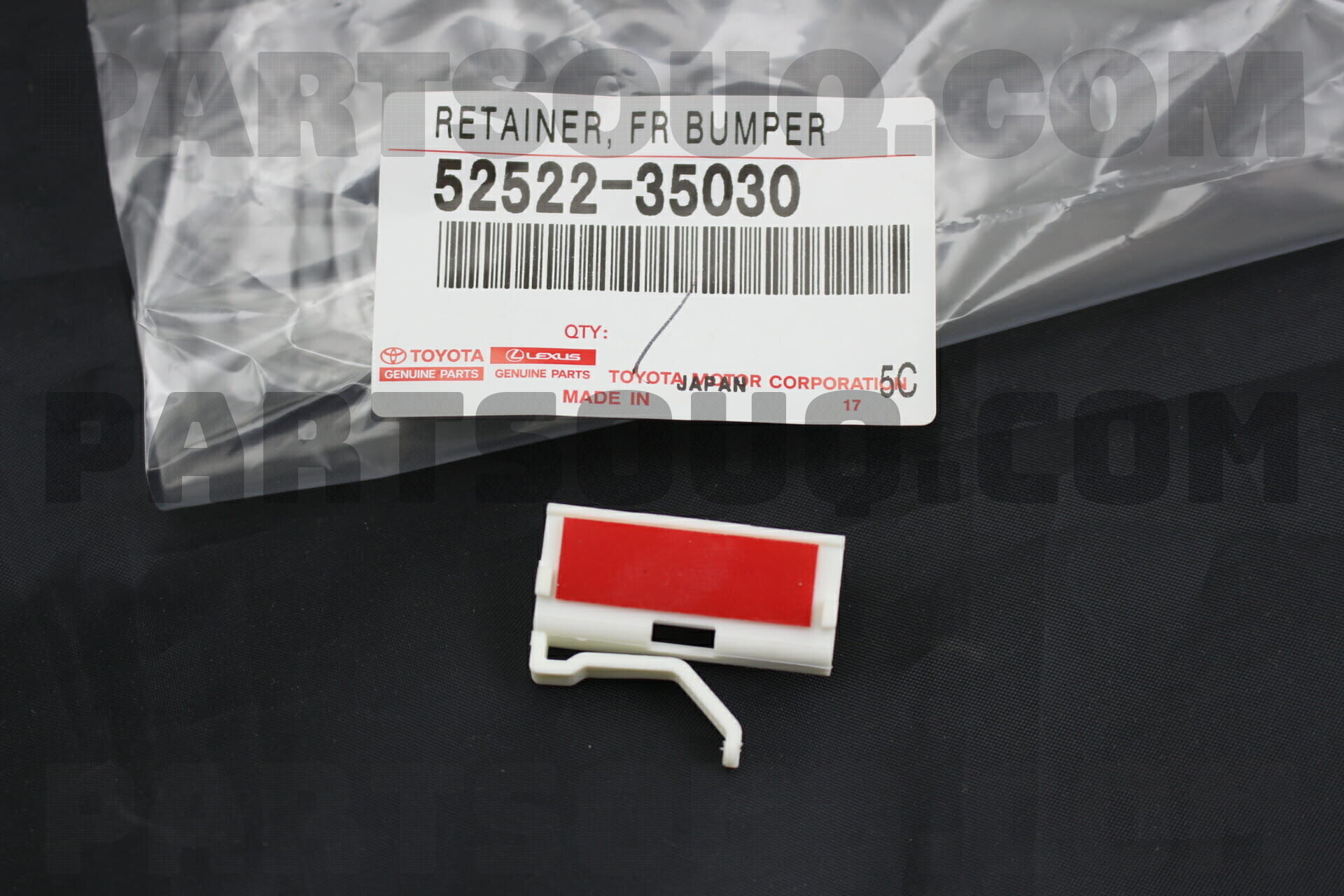

Retainer, Front bumper filler.
part numbers for left and right side- 52523-35030, 52522-35030
