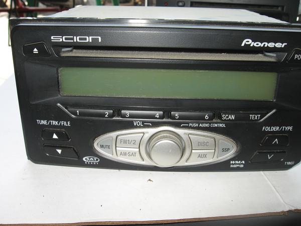

Have a question, and yes I am new here. What if I ahve the Scion HU with one knob that just has the AUX button and not an IPOD button.... I just want to use that AUX feature to plug my ipod in for better sound than a FM modulator! anyone know where to get THAT harness?? I have been looking and looking soooo please help!
I have the AUX cables, took it fom a junk yard.
what's the model number (on front) of th radio.
I thought that every scion radio that had AUx was also IPOD compatible.
Part#08600-21800 I think.. its out of a 2006 xB from what the guy said on ebay.. I have tried junkyards cause I got the idea from reading this bulletin but no one in town has any Scion at all! I think it says T1807 on the front!
that radio is ipod capable, (same one I have) order the attached part number to add the ipod.
ebay item number 200146065845
cable, $70, free shipping.
that radio should not be the one that is ipod capable... that is aux input capable with the headphone style jack but not the one that has the ipod jack or ipod software.
the ipod one has two knobs on the front, one on either side, and a button in the middle where the knob is on this one.
that much i knew... this one has no IPOD button like the two knob, only the aux feature.. which is all I want becuase I would like to plug my sirrius into it and my ipod without having the FM modulator way.. so back to my original question... where can I get that AUX harness? is a junkyard the only place? if so, anyone feel like helping a guy out and seeing if there city has one cause Nashville does not!
bump- I really wanna get this done.. anyone know the answer here? does someone sell this harness or is junkyard the only way?? if so, anyone wanna find one, pull it, and sell it to me cause my town is lacking in wrecked scion!

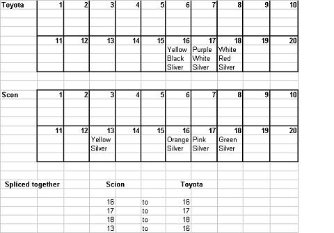

AUX
Attched is a diagram of the splicing of the Scion AUX harness and the Toyota harness.
The Scion Harness does indeed connect to the Scion radio and run it's self behind the dash, so it will have to be cut out.
But splicing mine together, I am able to play a DVD player on the AUX and the ipod on the ipod connection and flip between them with the AUX button.
This is only for the SCION radio with two knobs referenced in the thread.
I hope I didn't cut the wrong wires! The wires you show for the scion are the wires that I ended up cutting free. They are still there, but I cut them.
Those wires started running behind the steering column, that's why I figured they were for the steering wheel controls.
The rest of the wires from that plug go to one connector and then to the console connector for the aux.
There's even an extra 12 volt socket that is connected to this gaggle of wires.
When I went back and got the actual Ipod cable, it was all together from the head unit to the connector under the center console. No cutting to free it.
This is going into an 03 Tacoma, so we didn't have steering wheel controls as an option. However, I have thought about the idea of going back to the Scion and getting the steering wheel to see if it would work.
Thanks for the wire color info.
