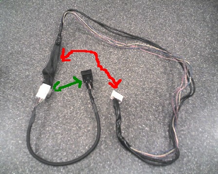

Cheers, PM with solutions...Please.
I have the green but not the red.

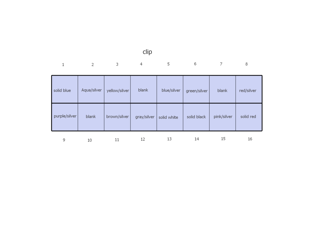

Might be asking alot, but if either of you have the time to look at that elusive third harness...yes this probably means opening up the dash again, you could map for me the wire colors to the pin locations and the rest of us would be set. From there we could cut the ends off and do a little soldering and be done with it. The intermediate is a 13-pin and the radio is a 16-pin. I'll pay you for your time via Paypal if you decide to do it.
Maybe.

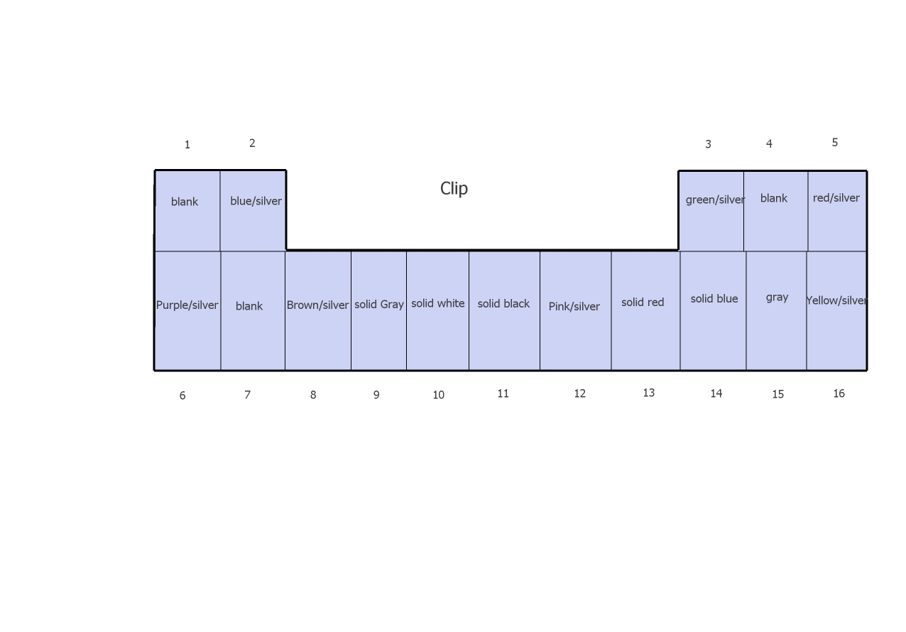

It would actually be better if you mapped the connector pins to the color-coded wires on both ends. I'm not looking at it now, but the situation is that I need to get 13 color-coded wires from the intermediate harness connected, correctly, to the 16 pin connector on the back of the radio [three pins on the back of the radio are not used but the 16-pin male connector "maps" the 13 wires into the 16 pins in the manner that is necessary to not blow up the radio and work the iPod]. So a map would look something like this:
16-pin on back of radio numbered from left to right, top to bottom as you are looking at it:
Orange over white wire - pin #1
White over orange wire - pin #2
and so on.
It was easier for me to make a couple of diagrams. Both of these diagrams are looking into the connectors on the side where the wires go in, or looking into the slots where they connect (such as into the HU). There are two sets of three wires that are grouped together and are shielded. I read on Scionlife.com that these wires must be shielded to protect from interference.
The grouped wires:
9,10,11 on the HU side connect to 12,13,14 on the Ipod side.
The colors are the same on both ends.
13,14,15 on the HU side connect to 1,2,16 on the Ipod side.
The colors are not the same coming out of the shielding - There is a solid blue and solid red, but the gray turns to aqua/silver.
Let me know if this doesn't make sense.
Head Unit connector:
Excellent work. With your diagrams and the schematics on scionlife.com, I'm going to call a harness maker I found on the internet and get some prices for making this harness at different lengths. Thanks for taking the time to post this Ed.
