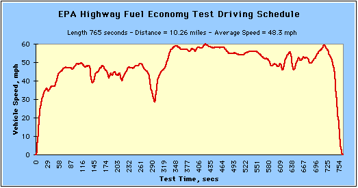

I noticed today on a 4 hour trip between I-65 and I-20, my 2012 Limited was getting between 18-19 on the highway. I was going 73-80 mph average. What happened to the 22 mpg advertised on the highway? :mad: I guess they meant a highway no more than 55mph.
You have 31% more aerodynamic drag at 80mph than 70mph. Aero drag makes up something like 75% of your total system drag (rolling resistance and drivetrain drag are much lower at this point) at those sorts of speeds. The EPA test really doesn't hit those speeds other than a supplemental test that is just there to help make the numbers a little more real world. The drag difference between 55mph and 80mph is a whopping 112%! My best advice to save gas is to slow down and use your brakes less. The less you use your brakes, the less energy you are converting to heat in your brake pads and rotors.
