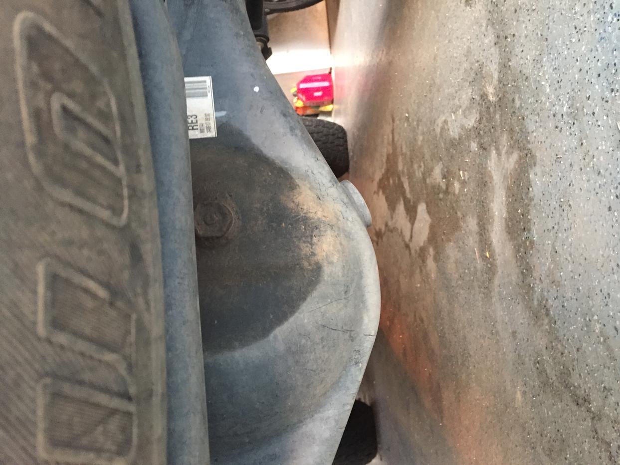

Does this look bad?! Fudge btw... The garage floor is just dirty... No signs of oil
Not able to find issue of leak...
