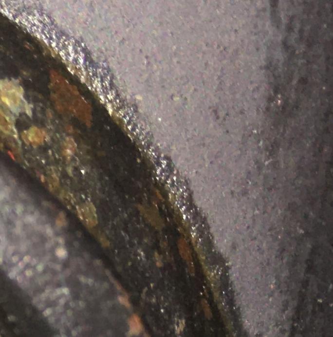

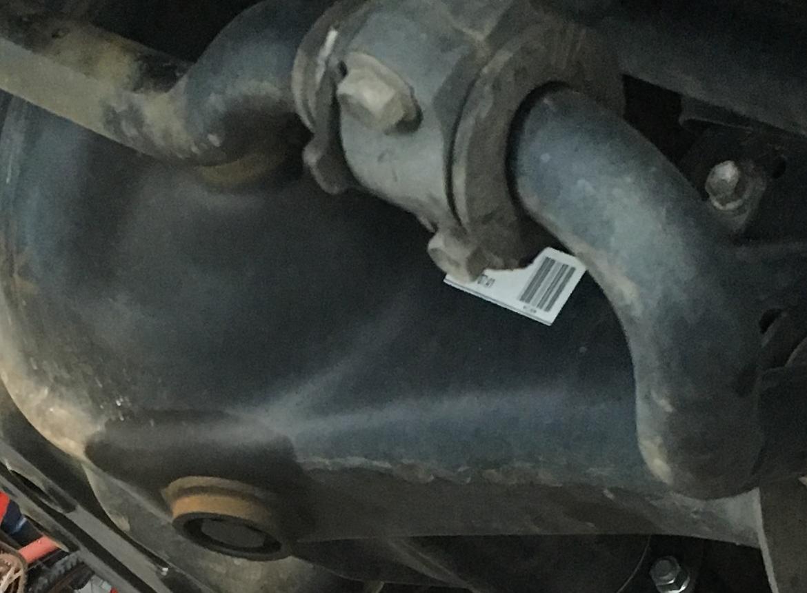

I might have fluid coming from the weld too. :cry:
I'll be testing this week. Hoping I'm just being paranoid.
