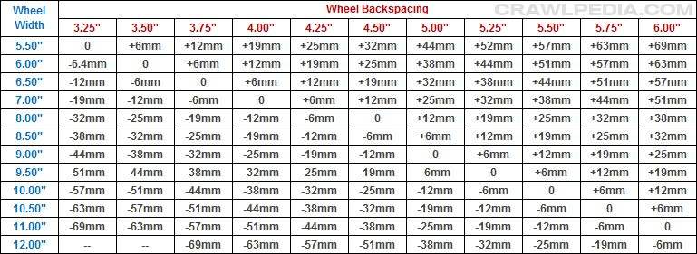

That's because offset changes according to the width of the wheel. BS is a more reliable input to how a wheel fits. How wide are your new wheels?.....If your wheels have a +20 offset and are probably 9" wide that would give you a 5.75" bs which is 1.25" inward more then stock wheel which has a 4.5" backspace.Backspace on these 5ths should not be over 5.25" max with recommended less then 5".
You may get away without serious rubbing with 5.75" backspace with a double deuce wheel since the UCA is inside that radius while the suspension is neutral. Flexing it ,as in extending or compressing will rub the tire and probably the wheel and could be dangerous as rubbing at speed on the UCA can and will blow out the tire. You would be the first I know of to lift with 22" wheels ,especially with that backspace for a Chevy . I thought big wheel lovers lower them.....at least that's the way they roll in the Gas Monkey Garage!lol
Here's a offset chart to show you how it works with bs and wheel width and why offset changes and is basically useless info other then finding your bs which they could have just given in the first place.

I just double checked and they are 9.5 wide and +25 offset which according to the chart is an even worse set up..... I'd did check and there was room for 4 credit cards thick between the tire and uca. No rubbing on the tire was evident.
Here's a offset chart to show you how it works with bs and wheel width and why offset changes and is basically useless info other then finding your bs.

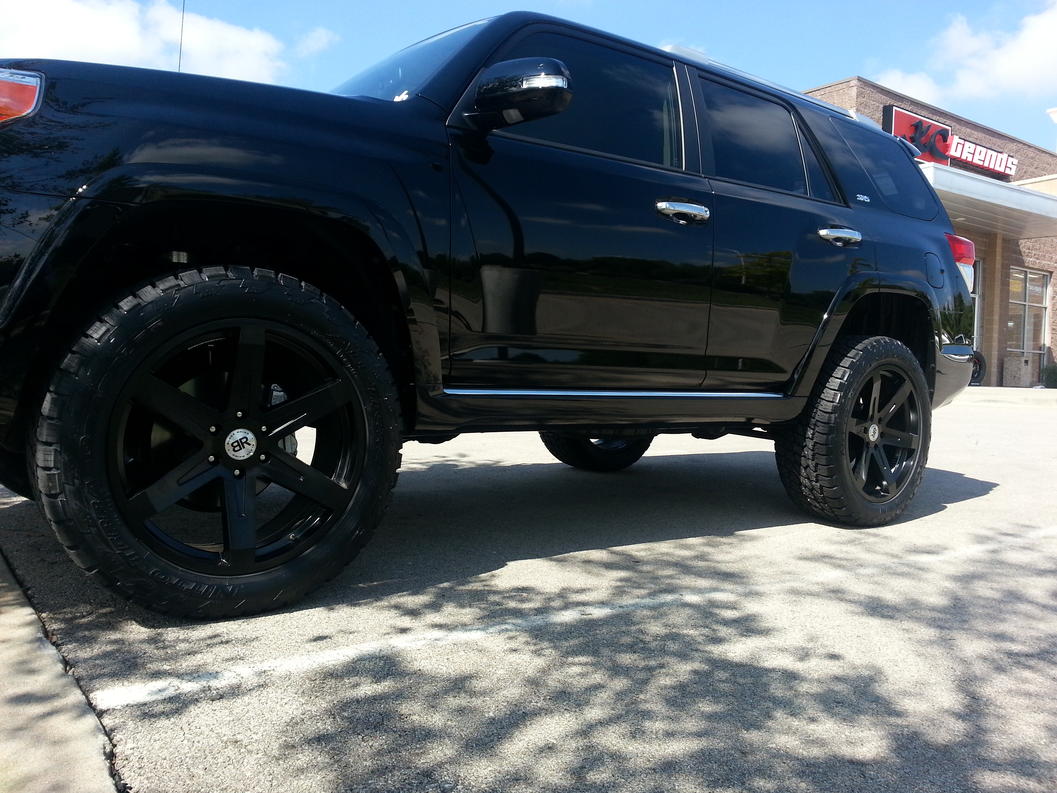

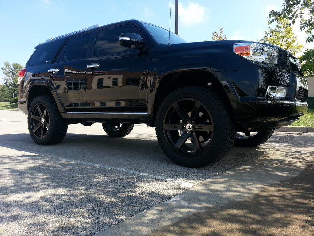

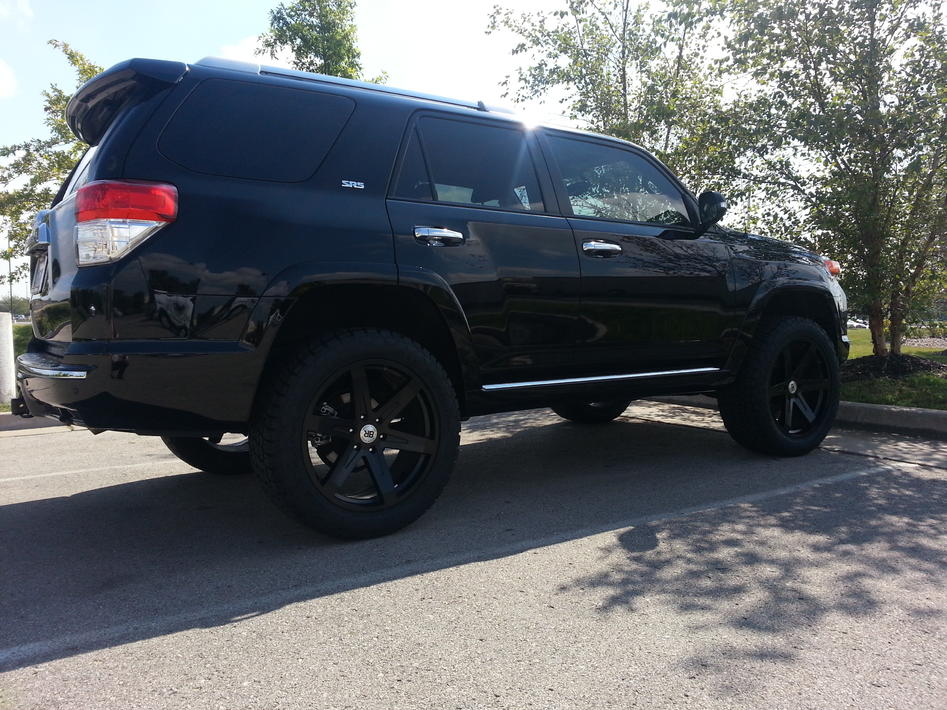

here is the update:
i know many on here are against 22" wheels, but it is a personal preference. I like them. I don't off-road. I just like the 4Runner and wanted to make it mine.
Window Tint
ToyTech 2.5" front and 1.5" rear
SpiderTrax 1.25" spacers front and rear
22" Black Rhino Peak forged wheels
285/50/22 Nitto Terra Grapplers (33")
[MENTION=99579]Tylerdh[/MENTION], have any rubbing issues with your setup? How does the spacer suspension ride compaired to stock?
[MENTION=66483]hrod79[/MENTION] , I had to remove the little front "mud flaps" and then push the fender liner forward. then trim a little bit of the plastic that is inside the wheel well. very minor trimming was needed, and you can't tell it was trimmed at all unless you are looking inside the wheel well. I don't notice very much ride difference, so I asked my lovely wife.. :) she said it does ride a little more "truck-like" now but not a big difference.
