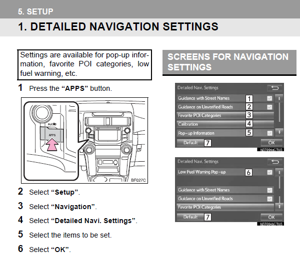

Any ideas as to why I'm missing the second page of Detailed Nav settings? Does yours not show all of them that page 250 does in the navigation owner's manual? (bottom image)

At a complete stop, gear in park in the garage. The second page just doesn't exist. No option to scroll down to it either. The scroll bars are grayed out. I think the low gas pop-up would be cool when traveling while using GPS.

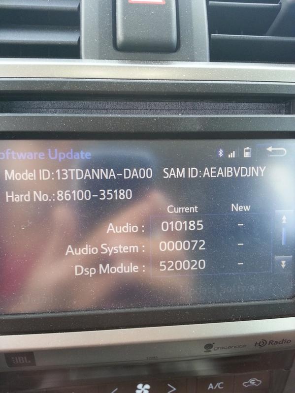

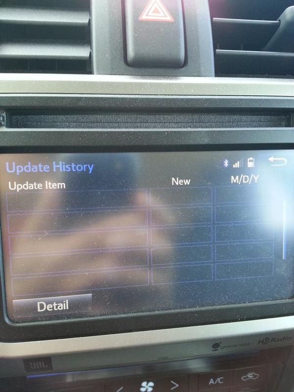

if you are running a HD radio the entune update on the board will not work.
if the dealer did update your software goto
Setup > General > Software Update
in there you will see 2 options
software update and software update history. if your software update history has NO entries, then they didn't update it.

Mine was upgraded to 101A5
I noticed that Nodak's was 10185.. I'm not sure what is different. So far, no problems, no slow down in transfer of contacts/other data. But, after about 3 or 4 weeks I'll know for sure.
Night time map problem solved! Thanks NoDak! But I can't figure out how to get to all of the options in the bottom image on page 250. At a complete stop, in park I've tried to access the options both with and without a route programmed. Odd. Not a big deal, but if there are options in the manual then I want to be able to have access to those options!

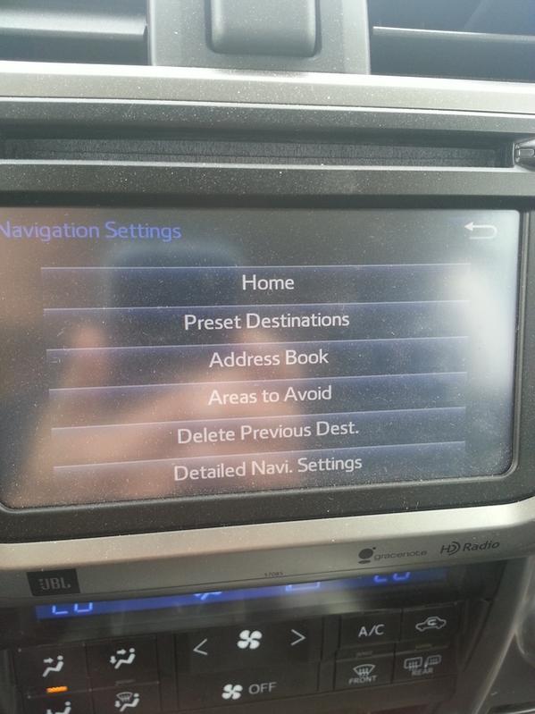

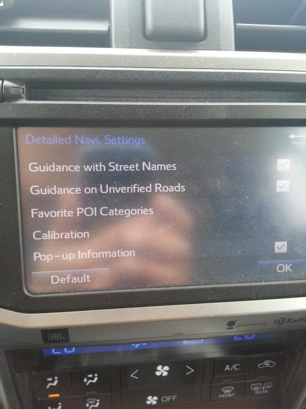

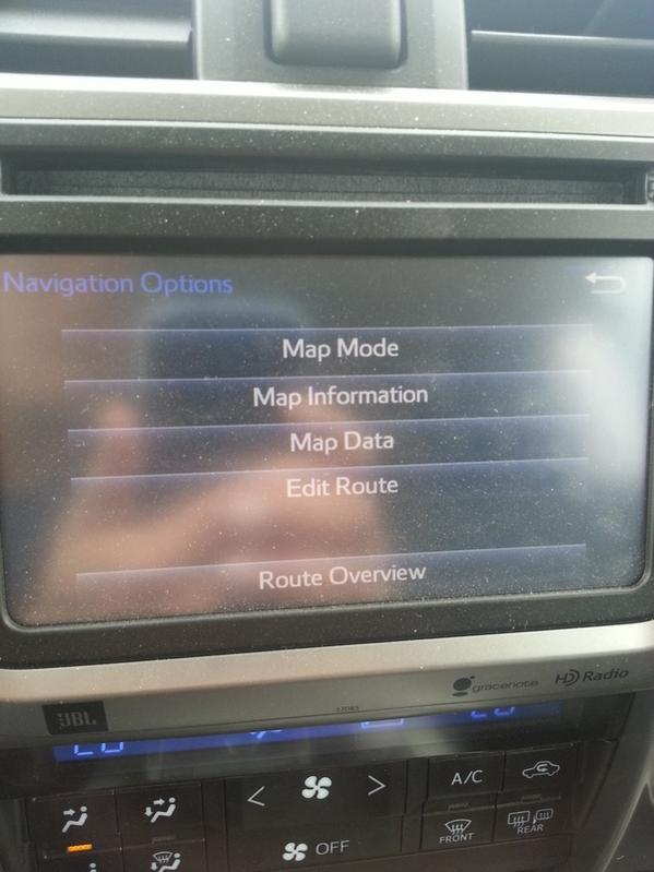

as you can see, there is no scroll bar for mine either.
pic 1 from the owners manual, the instructions on pg 250 say you need to goto setup > nav > detailed settings
pic 2 is the option button on the actual nav map
pic 3 is from setup > navigation
pic 4 is from setup > navigation > detailed navi settings

lol I just noticed this.
the extra entry #6 is the low fuel warning AND the list scrolls to the top of the list to entry #1.
the low fuel warning I think was remove in production units since its redundant with the low fuel warning light in the dash by the fuel gauge. I would trust the bingo light more than the nav notification.
