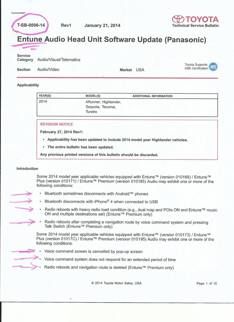

Don't let them blame their problematic software on your iphone (or android for that matter 'which I use'). Just show them the 'Toyota generated' tsb number (below) and stay on them until you get this resolved! This is a ten page "Entune update install instructional document" for the Toyota techs so I won't post them all here; you can download them from Toyota's 'TSB' website. Chow!

Big thanks to Rigtec for posting this info. In looking at the sheets of paper they gave you my problem was -Radio reboots with heavy load condition.
I complained so much about it my dealership replaced my radio. Not sure if that will even solve the problem since by the sounds of it they still don't have a solution.

Big thanks to Rigtec for posting this info. In looking at the sheets of paper they gave you my problem was -Radio reboots with heavy load condition. I complained so much about it my dealership replaced my radio. Not sure if that will even solve the problem since by the sounds of it they still don't have a solution. I will keep this thread updated as I find more information as well.
