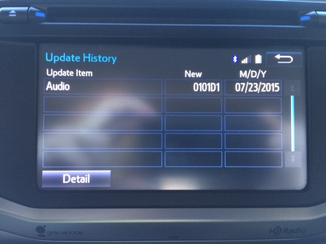

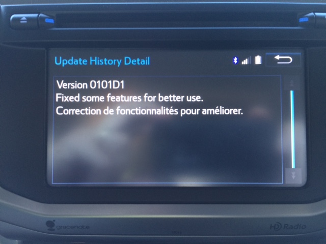

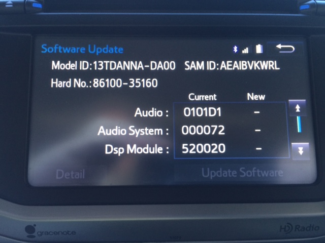

I have a 2015 SR5 with Entune. Purchased in January. It had an issue connecting Bluetooth the other day. The head unit shut down this morning and rebooted.
My headunit restarted or locked up 5 times in the last 3 weeks.
Videoed each time and contacted the dealership, sent them the vids, they wanted to check to see if it has the latest software update.
The dealership installed a new update today, see photos.
EDIT: Update to software had to be done via Techstream, otherwise I had the latest update.

If you would have held in the power / volume knob in for several seconds, it would have done a hard reboot and restarted the head unit.
See my post two above yours, for the latest update.
You have to have this done at the dealership via techstream.
So far, since the update, mine has not acted up once.
