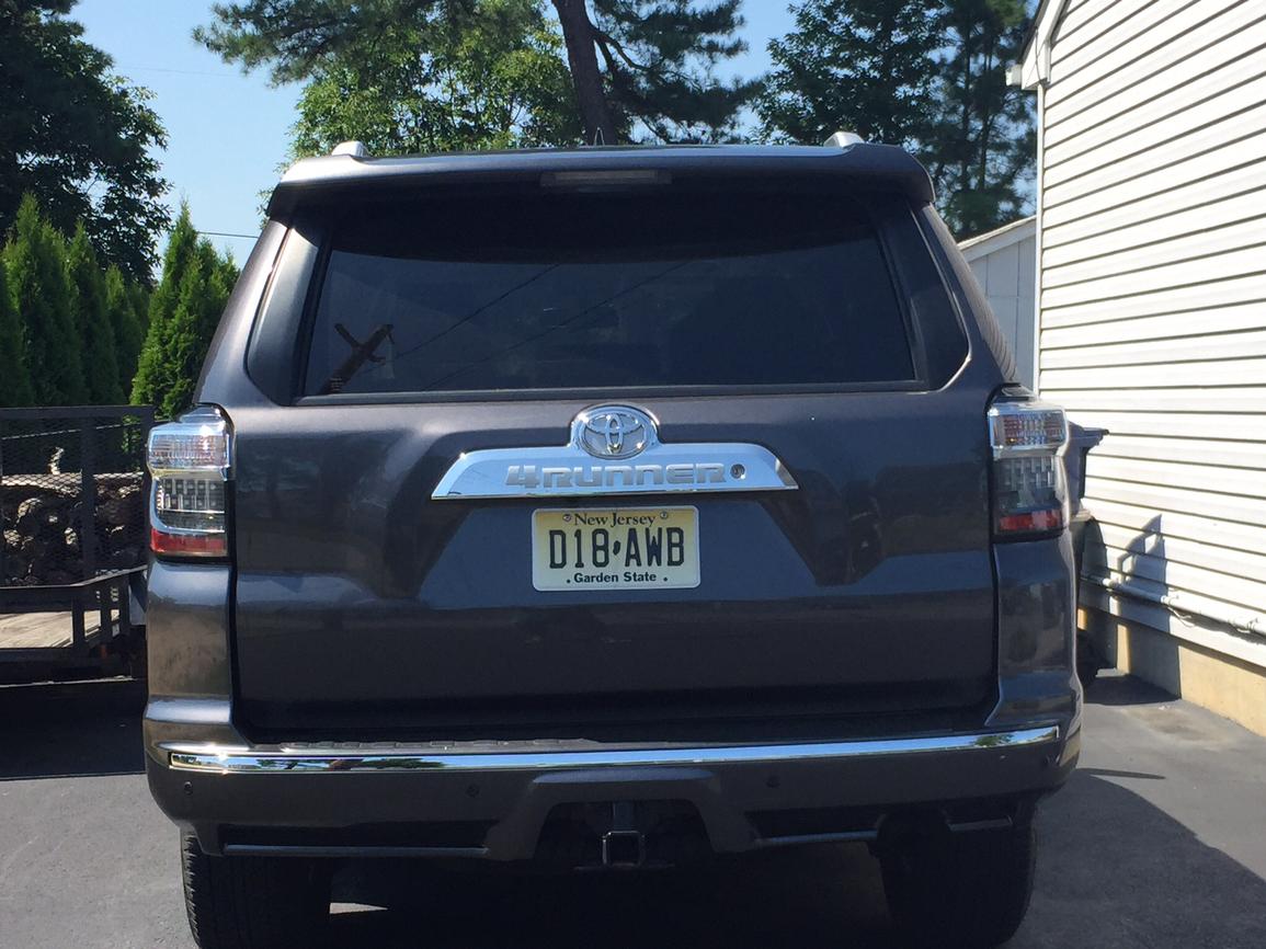

I just ordered the TYC lights from rockauto.com. I'll post picks next week of them on my magnetic grey sr5.

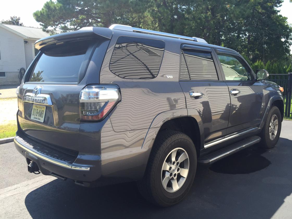

I just received my TWC lights and fit and finish is pretty much stock. Everything fit perfect except the two metal pins that snap into retaining clips on the body. It maybe that the 2013 model uses different clips than 2014. The pins insert fine bit do not lock in as stock do. Once bolted down though it isn't noticible. I'm very happy at the moment with the TYC quality. It really looks great on the grey too

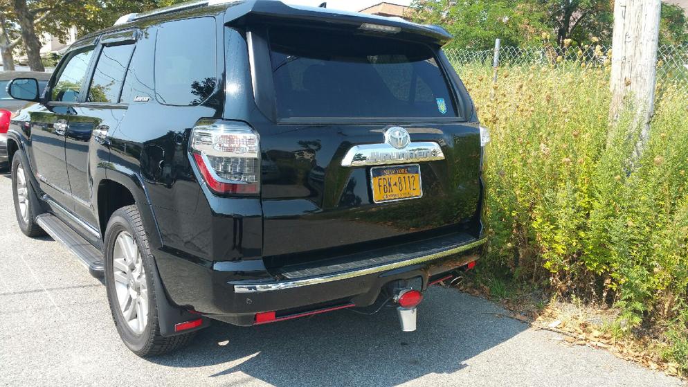

After reading all posts about TYC lights, I've decided to pull the plug on them.
Ordered on Wednesday, $229 and six days later there is result.

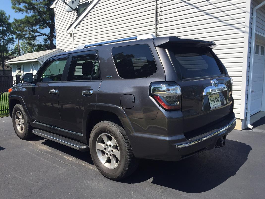

It's wanted thank you all who did this tail lamp swap and posted all the great info on here. My drivers side factory light broke and I was going to have to replace it. Finding this thread while I was researching how to take it off and decided to change both sides to the newer led version. Again thanks everyone.

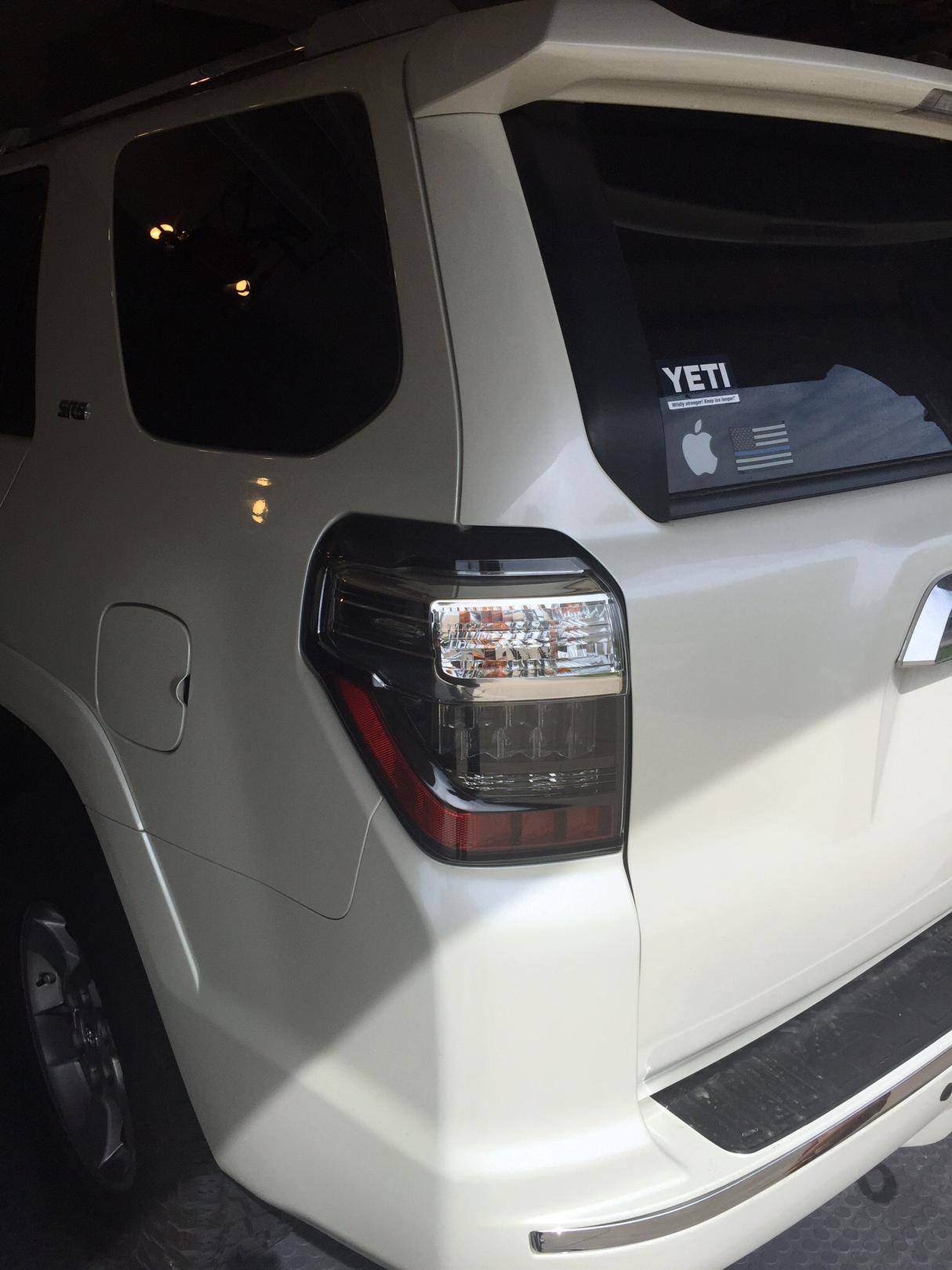

Obligatory photo!
Total cost was $253.95, shipped, from Amazon.com.
