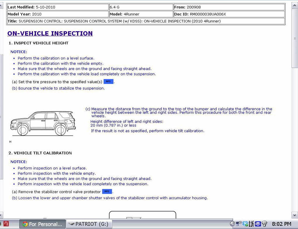

As stated factory limits are a maximum 20mm(.787") difference left to right or it needs tilt calibrated for the KDSS equipped TE's. Tilt calibration needs special bleeding tools and techstream however.You may be able to talk the dealership into doing it to get it better level since it is so new.
This is page out of the 2010 repair manual but should be the same for the 14's.

I think the general consensus is to just leave it alone, lol. There's probably a reason why the FSM specifies that up to ~3/4" difference is within acceptable tolerance. Keep in mind the rear height difference side to side changes a good ~1/2"+ or so when the gas tank is empty vs full. It's probably impossible to get it completely even at any given time :)
