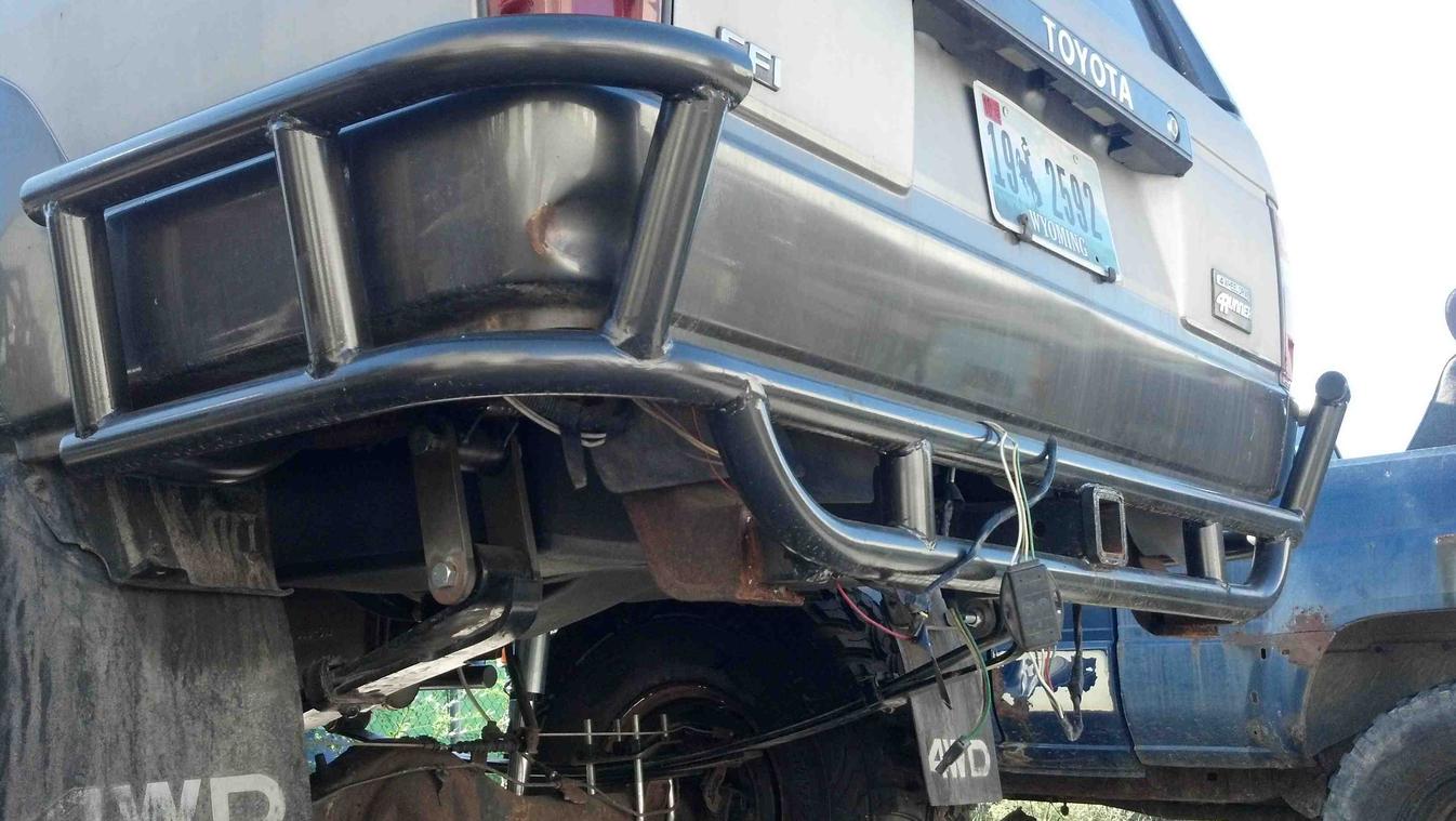

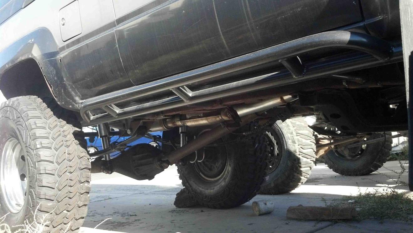

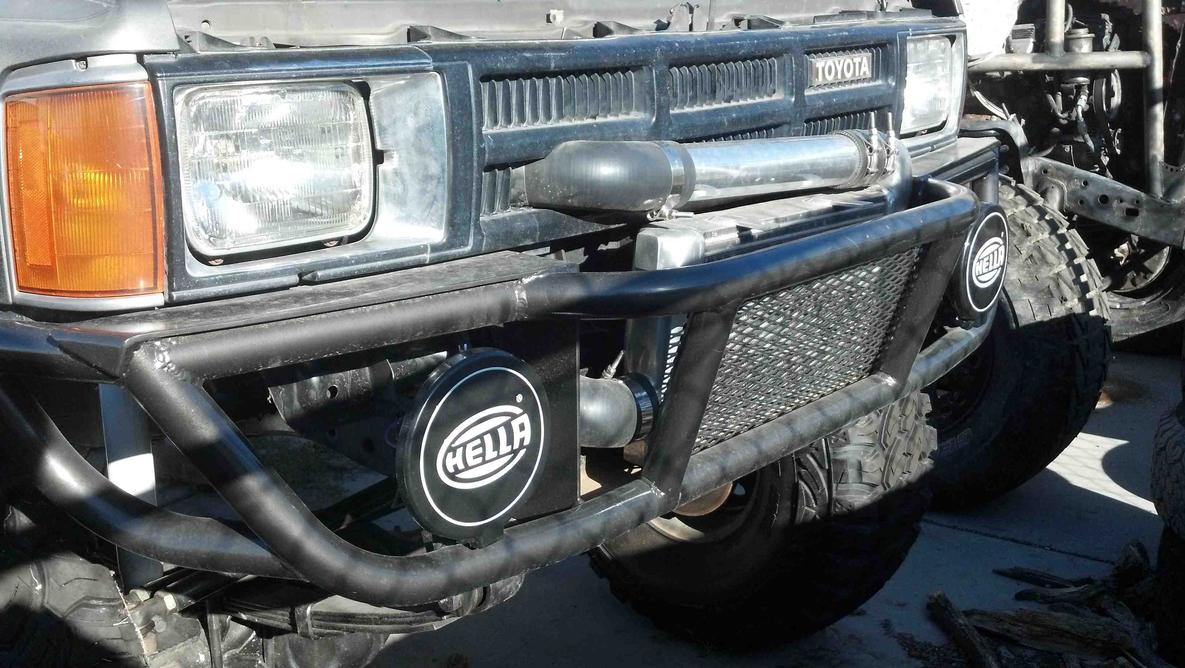

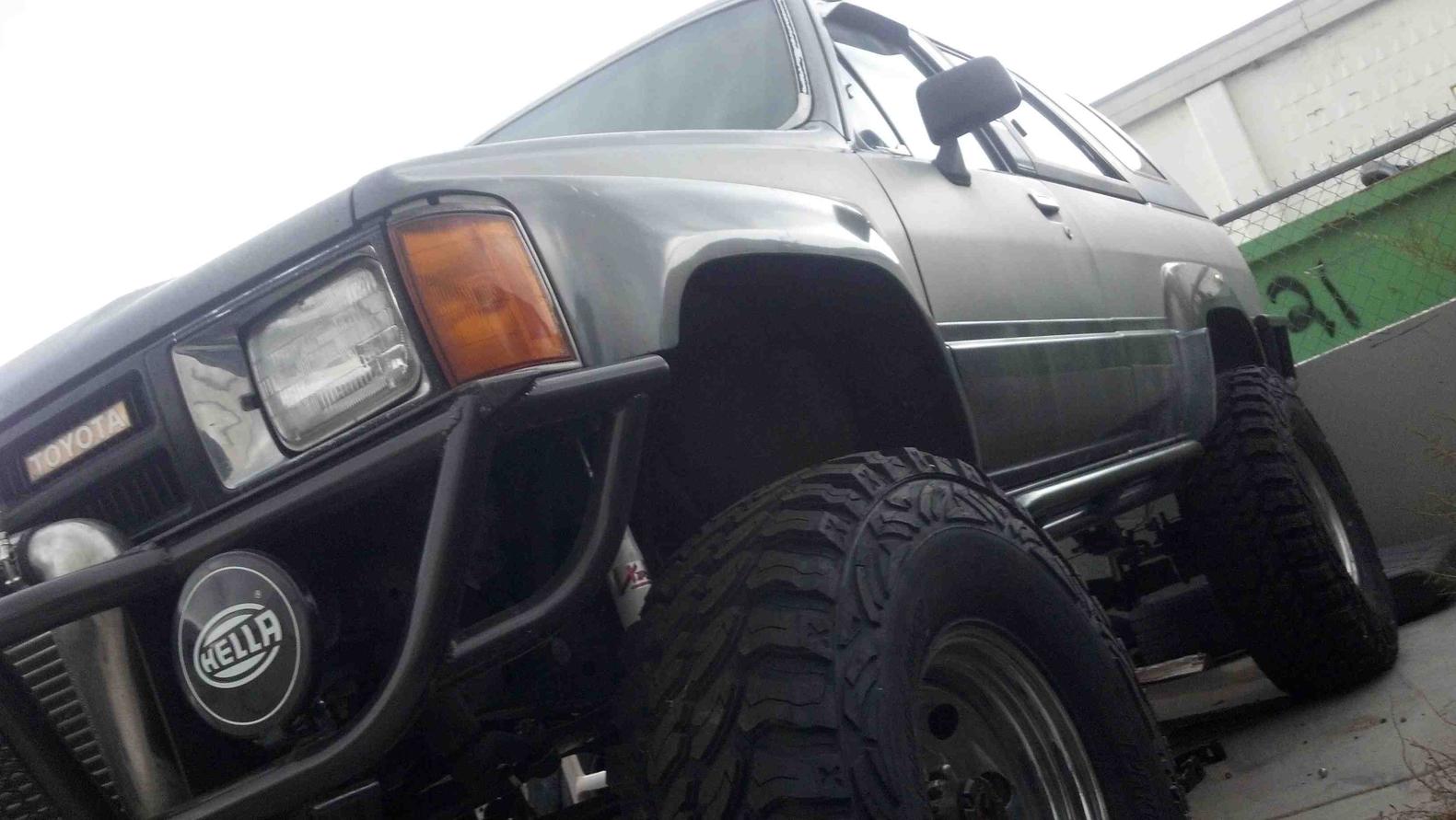

I'm still working on my swap. I put it out of commission for a long time doing a sas, upgrading suspension, building bumpers and sliders, and other stuff. Right now I'm being stumped by a possible bhg. Was gonna go pull the head today but its snowing! I think I'll still go get a coolant check kit and try to confirm the bhg before I pull it apart.
That's an interesting intercooler install. You need to bring this beasty out on a run with us, I really want to see what that turbo does for you on the trail.
