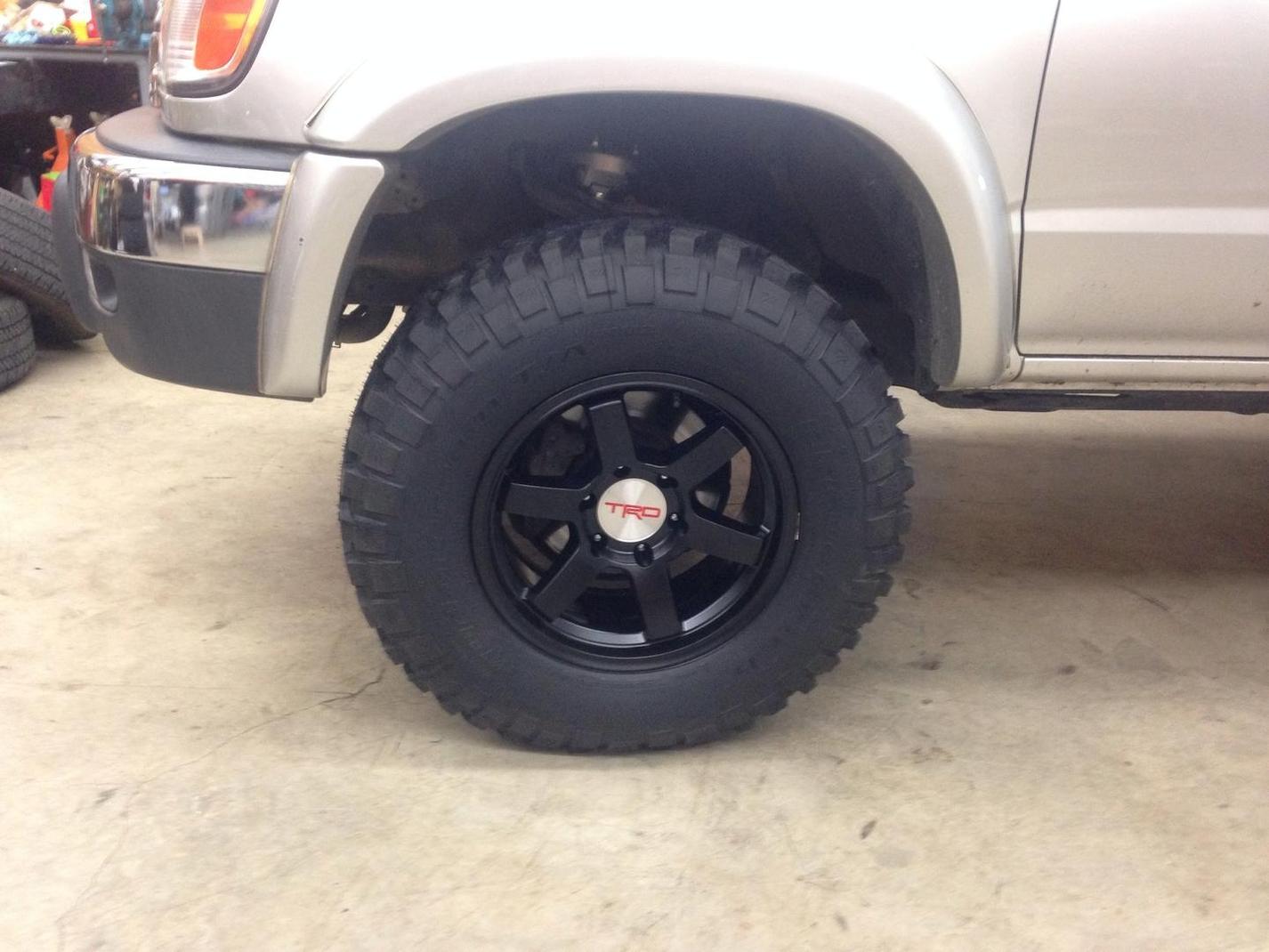

You will be fine running 255s on an 8" rim. I know a couple guys that have run this setup on their tacomas. I'll find some pictures and post them up
ee7563ac333c08429507c126c074d60e.jpg~original
IMAG0090.jpg~original
Thanks for the photo. I'm definitely going this route. I've been on the fence between the 255/85 and 285/75 for a while now.
I've decided that the 255s aren't nearly as narrow looking as everyone makes them sound as long as they have a mildly agressive tread to them. The KM2's tread width in that tire is the same width as the tire itself (10") while other brands are down around 8.9 or 9"
I think that they'll look sweet, and keeping them closer to under my un-flared wheelwhell while going up .3" in overall height vs. most 285s doesn't hurt either...
