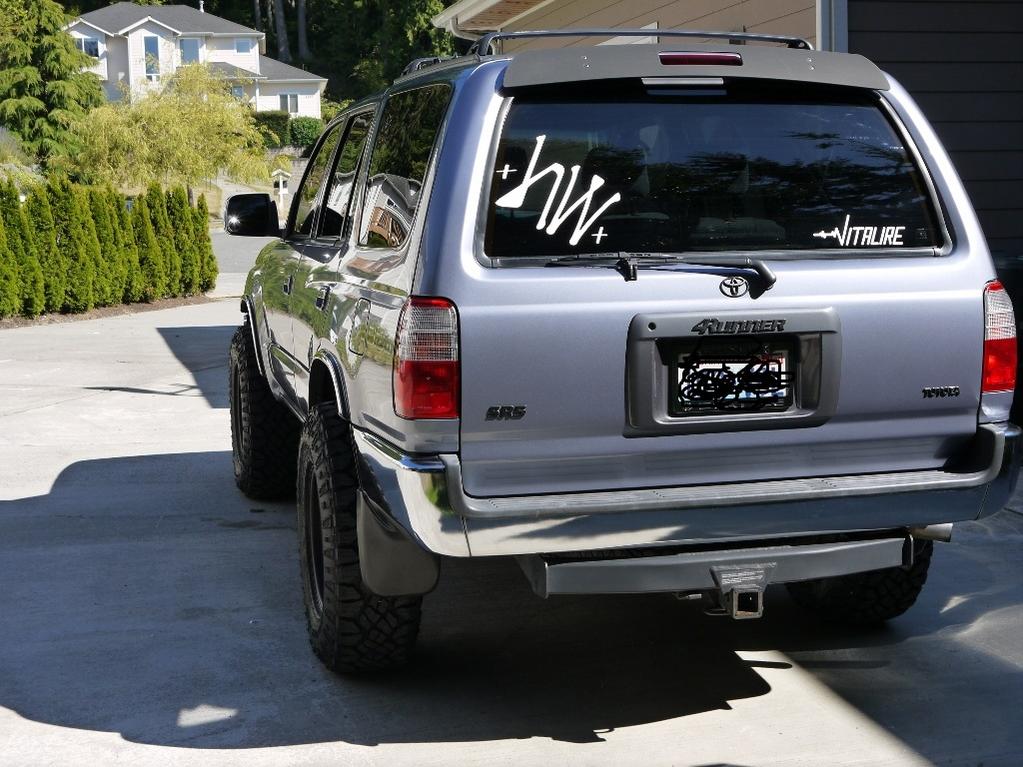

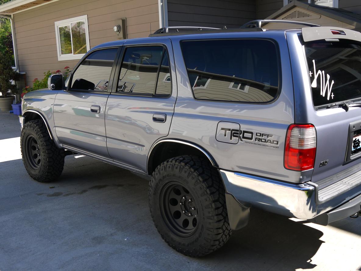

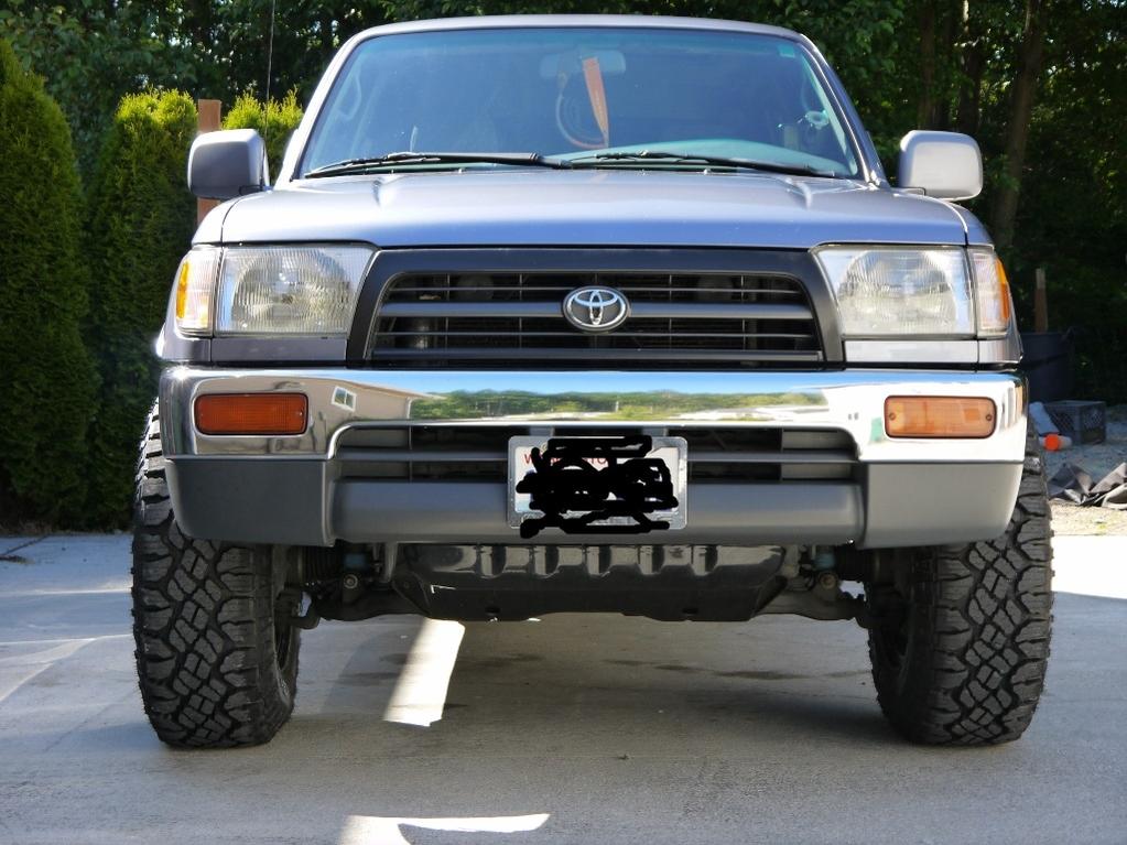

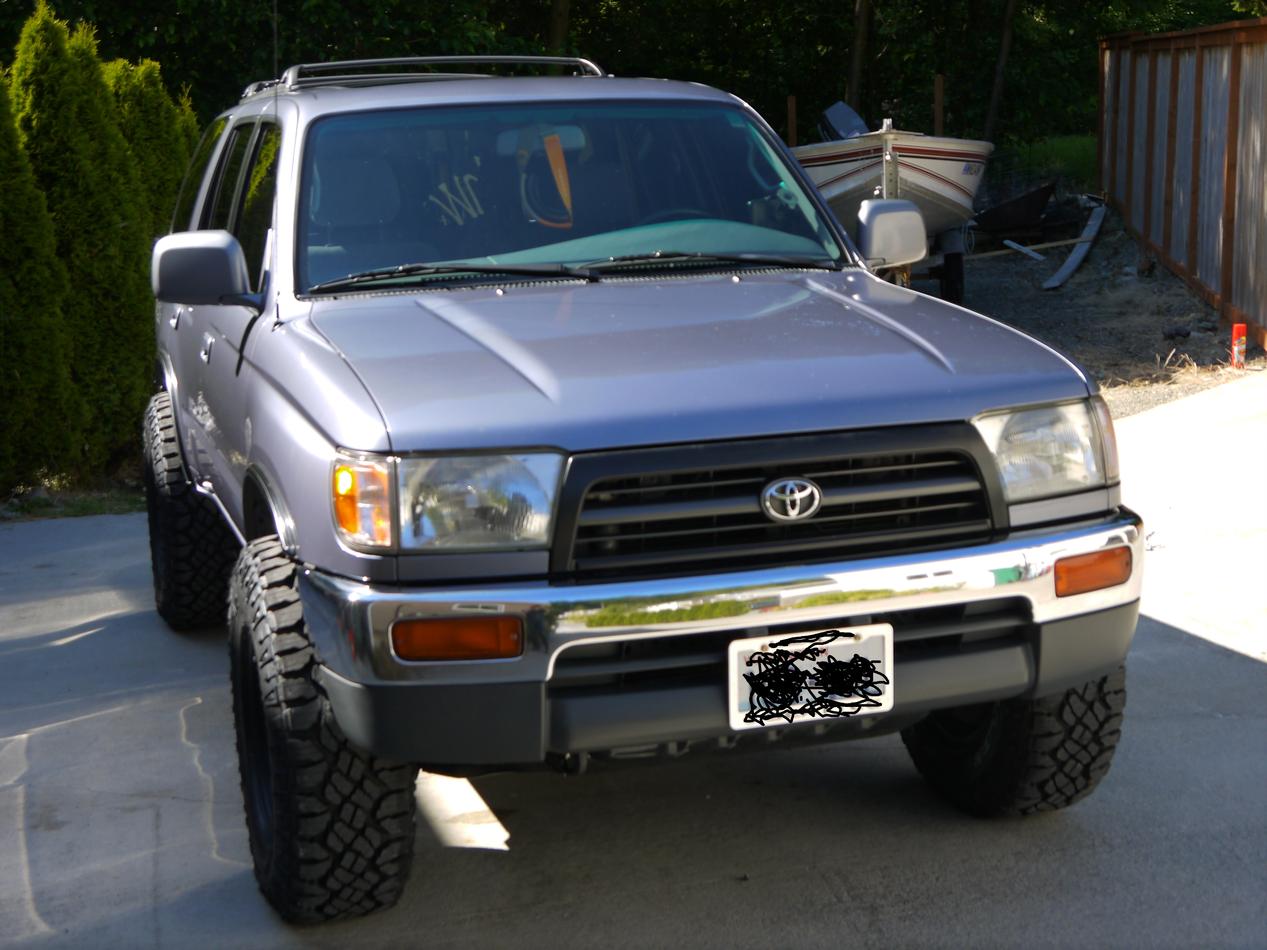

well i got my 265 duratracs and procomp 7069 wheels put on the other day and im pretty happy how it turned out! but despite having a 98 with larger coils than the 96,97,00, and 01 4runners im rubbing when the wheel is full turned and i already replaced the bolts to a more flush counter sunk alan head, and messed with the pinch welds but its still rubbing. so now im saving for a lift and i will hopefully have something by the end of summer i wanted to do 99 coils but they arnt much taller than the 98's might get 1/4" lift if im lucky which would be a waste of time and money, might as well do it right! please message me if you know anyone selling some 881 or some 891 coils!

Your right that thing looks lifted already. 265's usually rub on all when fully turned and more so with those aggressive tire tread. Just dont turn so muck, LOL. They look good!!

no spacers, i think the offset is -12 with a backspacing of of 4 they push the tires out pretty well, im trying to find some limited flares now
