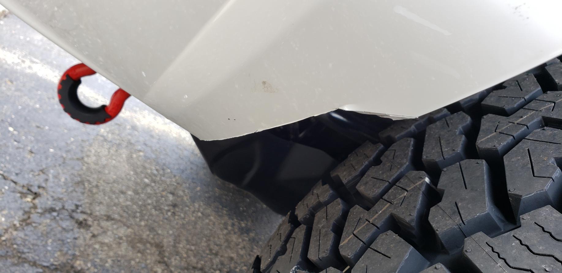

I go up there and sure enough, they rub the back of the front fender liner (or the mud flap, rather) and the front of the fenders, especially catching on the bottom of the front bumper cover.
NOTE on the photos: all photos are taken with the wheels turned at full lock.
One more note: in case it's relevant to you, I also had Spidertrax 1.25" spacers installed with the tires.
In front of tire.
At the rear of tire.

That piece, indeed, helped a lot, as you can see we barely rub now.
In front of tire.

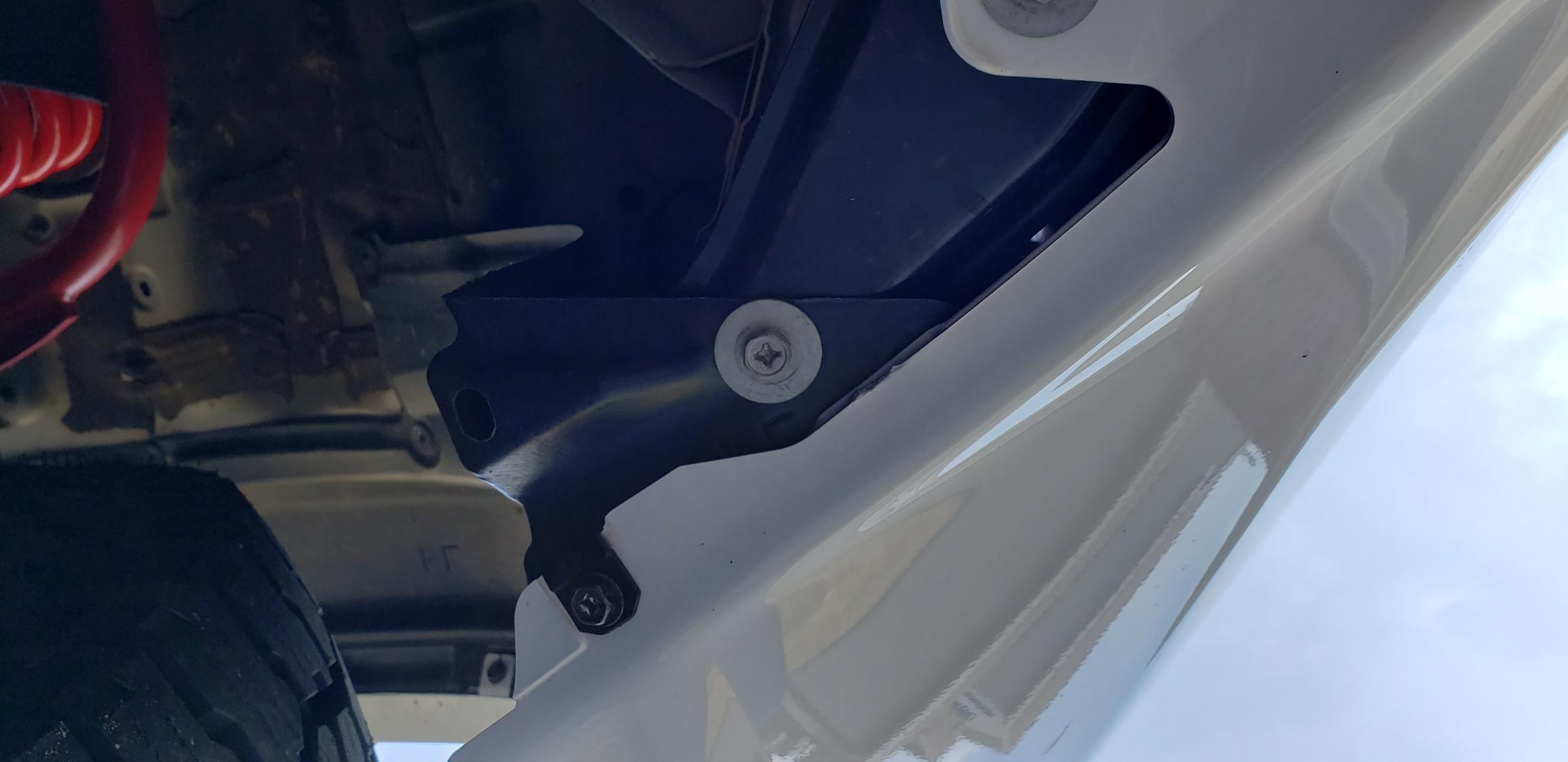

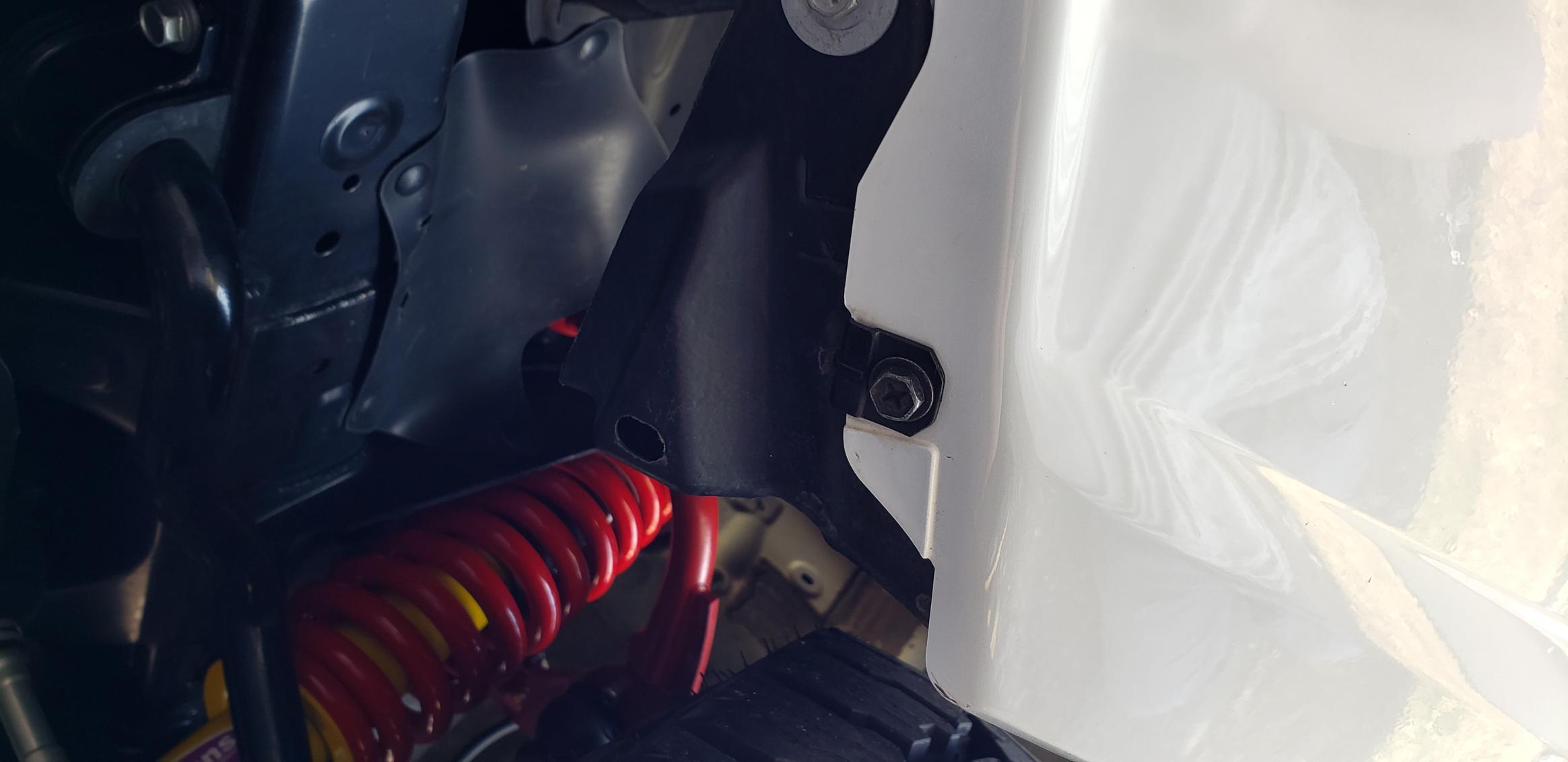

The first part of the fender liner mod was to move the front part of the fender forward. I unscrewed the two screws on the bottom that were connected to the fender liner and was easily able to push the fender liner forward, as other posters had mentioned, 1-1.5 inches.
The tricky part was putting the back-most screw back in. I found what made it easier was drilling a pilot hole the same size as the original, into the fender liner plastic. Once I did that, getting the screw to line up with the seat it screws into was much easier.
As you can see in this shot, I have the fender liner pushed forward the advertised 1-1.5”.
You can see in this shot, the screw wasn’t quite lining up. This was because the bottom of the seat had a nipple that was intended to fit into the original hole to keep it in place. When I made the pilot hole larger, it lined up perfectly.
For the front screw, I drilled a much smaller pilot hole.

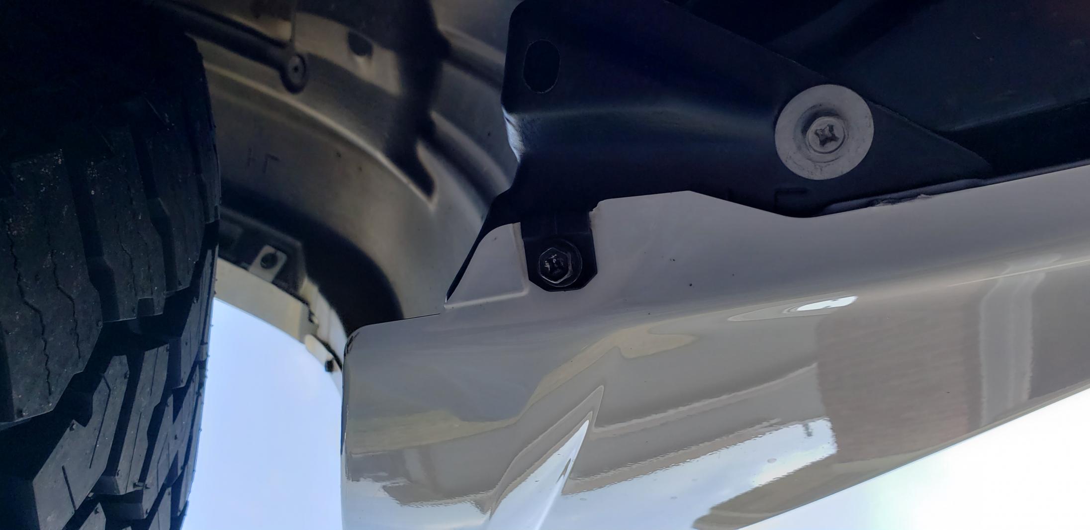

Now that the fender liner is moved forward, the next step was to trim the bottom inside corner of the bumper cover.
I taped my line that I wanted to cut, intentionally being conservative, knowing I can always trim more, but I can’t put any back!
It took a few passes with a fresh utility knife, but the cutting was fairly easy.
I wasn’t really happy with the clearance and decided to take some additional bumper off.
Once I got that pesky corner cut, I grabbed some 150 grit sand paper and sanded it all down nice and smooth. I smoothed out all the jagged edges, rounded off any corners and got it looking as close to a “factory finish” as I was able to.
As you can see in the before and after pictures, I earned about 3/4” of clearance through the mod on the front of the fender and bottom of the bumper cover. I can definitely take off more, and will have to watch it to see if I need to.
