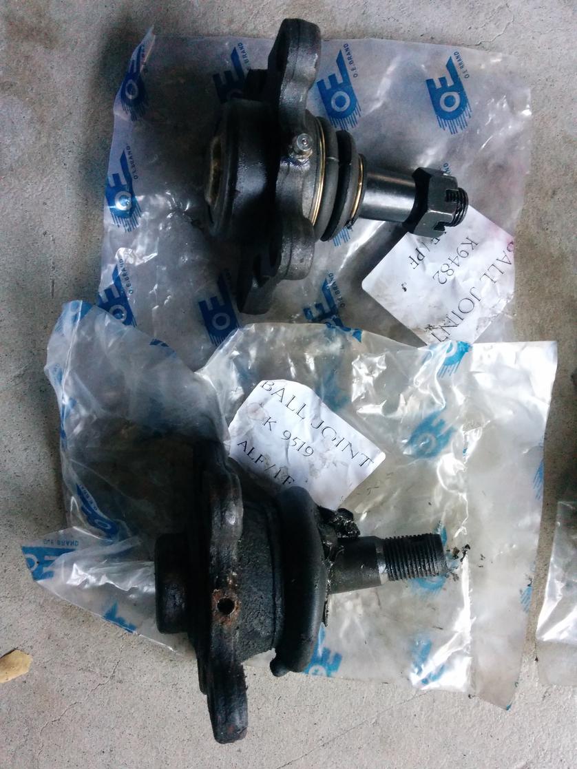

Heres some pics and details on these parts for you fellas:
All ball joints, pitman arm and tie rods ends are in bags with this marking "OE Brand" and have white stickers on the bags with the nomenclature and MOOG part #s.
Every part includes all associated hardware (bolts, nuts, cotter pins and grease zerks as applicable). Only the upper ball joints and Pitman arm have grease zerks; all other parts are sealed shut without zerk locations.
IMG_0617.jpg~original
Upper Ball joint w/ Grade 10.9 studs and crimped style self locking nuts.
IMG_0620.jpg~original
IMG_0622.jpg~original
Lower ball joint w/ Grade 8 bolts and nylon nuts. Also pictured is one of the tie rod ends.
IMG_0625.jpg~original
Idler Arm has a different style bag and logo for "DLZ Chassis Parts"
IMG_0626.jpg~original
IMG_0627.jpg~original
IMG_0628.jpg~original
Everything seems to be of an OEM replacement quality... For the price, I still think it was a smokin' deal.

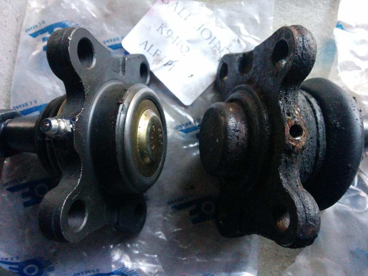

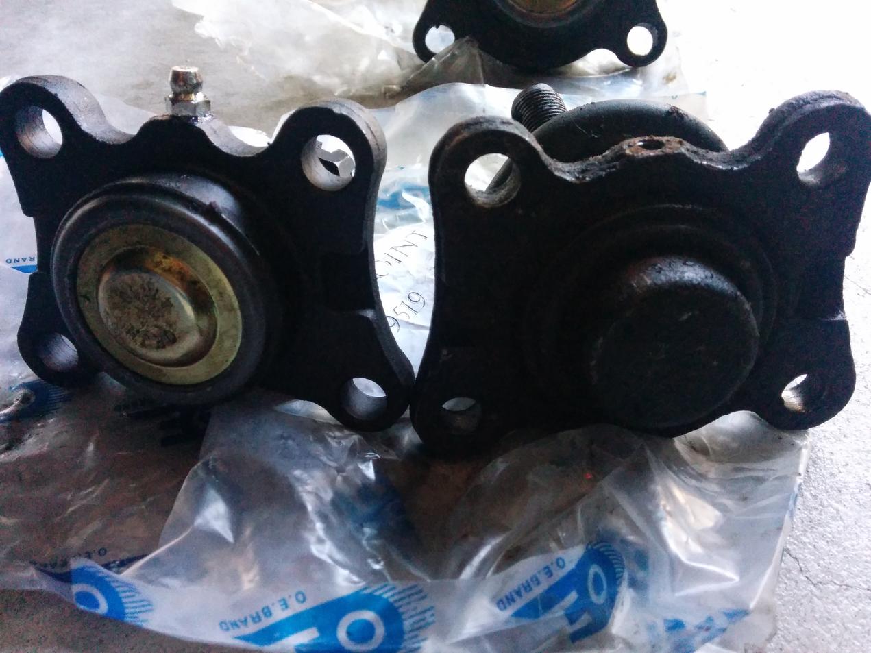

I hate to dig up an old thread but I purchased the same parts above. The lower ball joint did not line up. I have contacted the seller earlier today but have yet to hear anything back. I wanted to bump it here in the case that someone else decides to purchase this for their rig. I have a 92 4WD 5-speed 3.0L.
Didn't line up how, got pics? What's the brand and part number?
Attached is the OEM vs the aftermarket pictures. You can see the OE ball joint has a smaller lower "hump" than the aftermarket. The aftermarket one just slightly does not fit the hub. The eBay seller has replied and I will be sending these same pictures in a few minutes.
I had to get one on a whim from worldpac.
I got refunded $19 for the lower ball joints. I'm not sure if they are taking any action to correct the parts they are sending out. I lost a whole day of time and more money spent finding this out.
