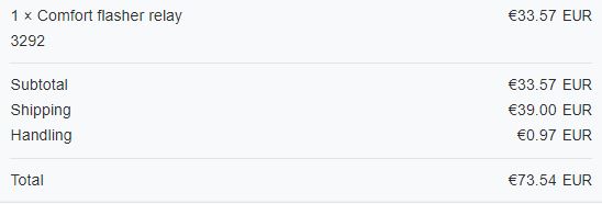

Have been in contact with another company out of Germany, PEKATRONIC. They claim that their module will work with all Toyota's and Lexus'. I double checked with them if it will work with 5th gen 4Runners and they have confirmed both times that it will. I am looking to place an order with them but with this whole Corona virus thing they are not shipping to Canada at the moment. Per their email to me, this is completely plug and play. No need to splice/cut into existing wires. Part number you are looking for is 3292. Here is a link for anyone who wants to try it out.

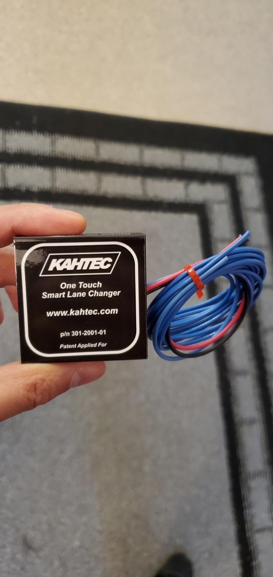

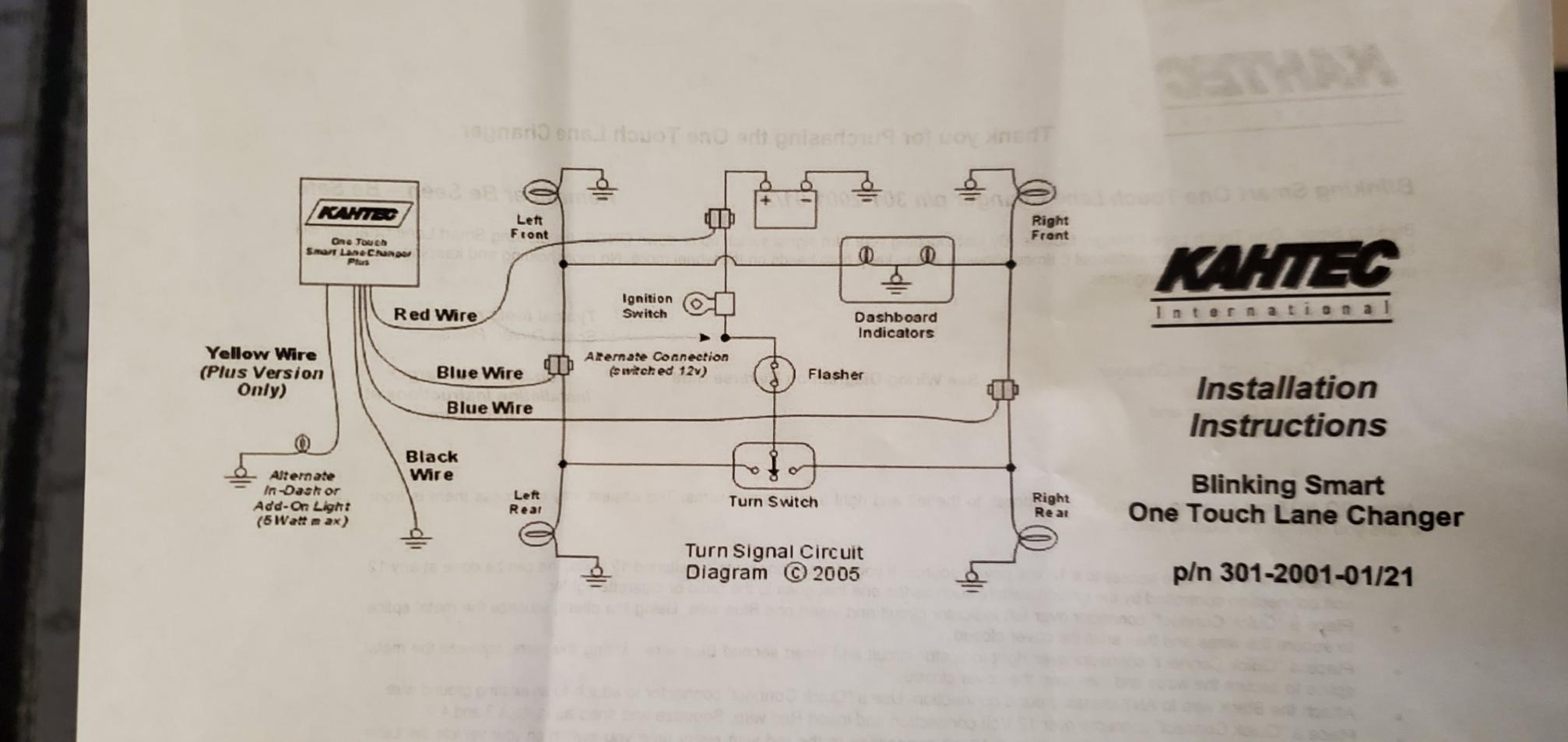

Just purchased the module from Kahtec after reviewing the install wiring diagram. The install seemed simple enough so I thought I'd give it a try. Will report back after I install it.
These just arrived! I will install this weekend and report back. Wiring diagram looks simple enough. I will tap the turn signal wires from under the steering column. Hopefully they work as advertised...

5TH Gen uses on-board computer to control that, therefore no easy solution. 4TH Gen is Relay and easy to upgrade to 3 or how ever many blinks you want with just replacement of that relay with smart relay.

Finally got a chance to install the harness/mount and relay and I'm glad to say it works like charm! I have the tap/turn function along with multiple hazard strobe options as well.
