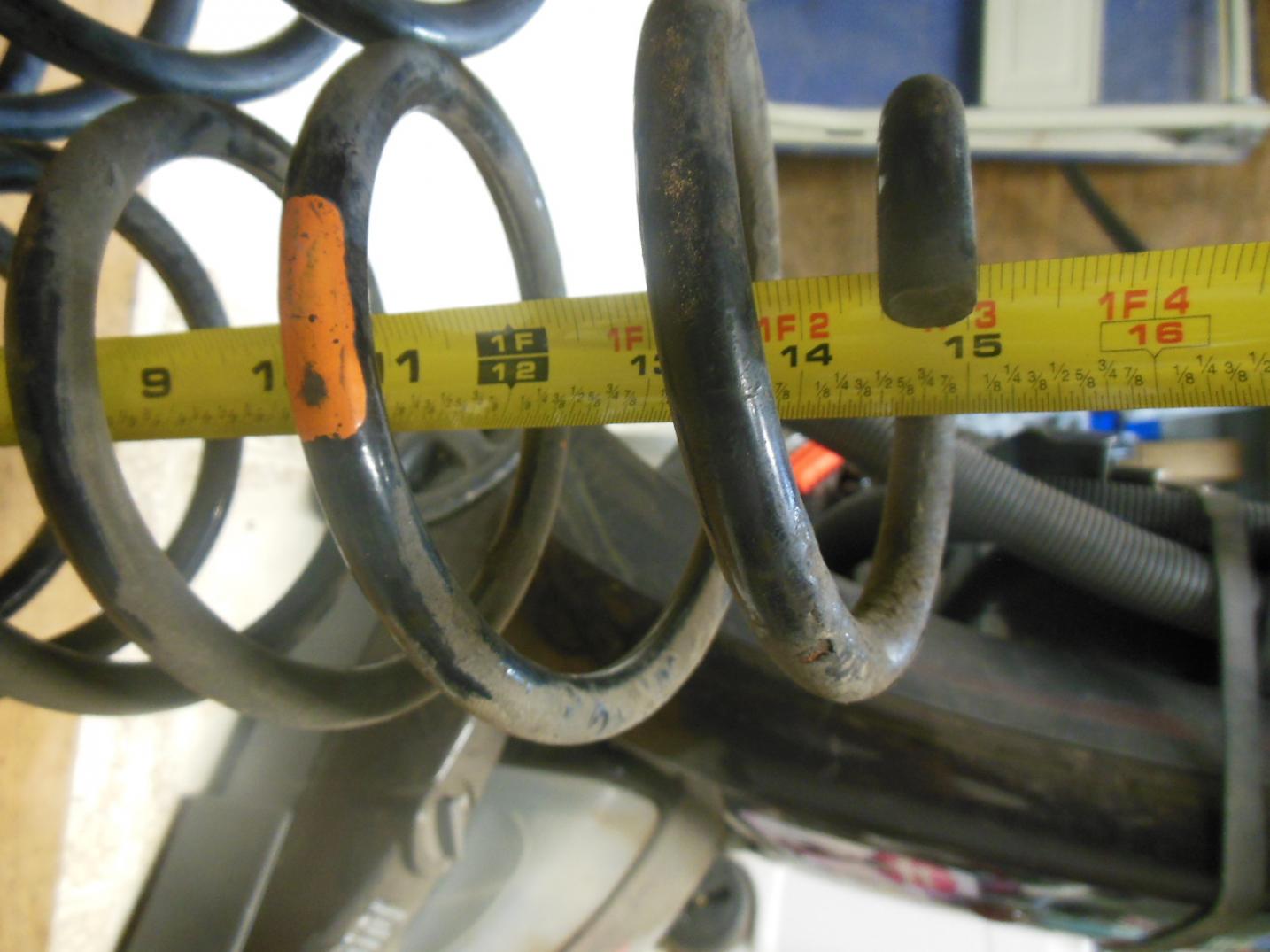

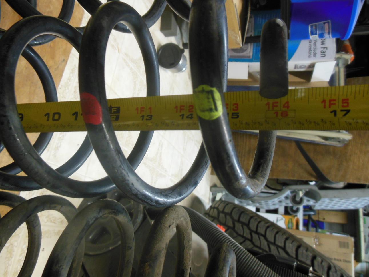

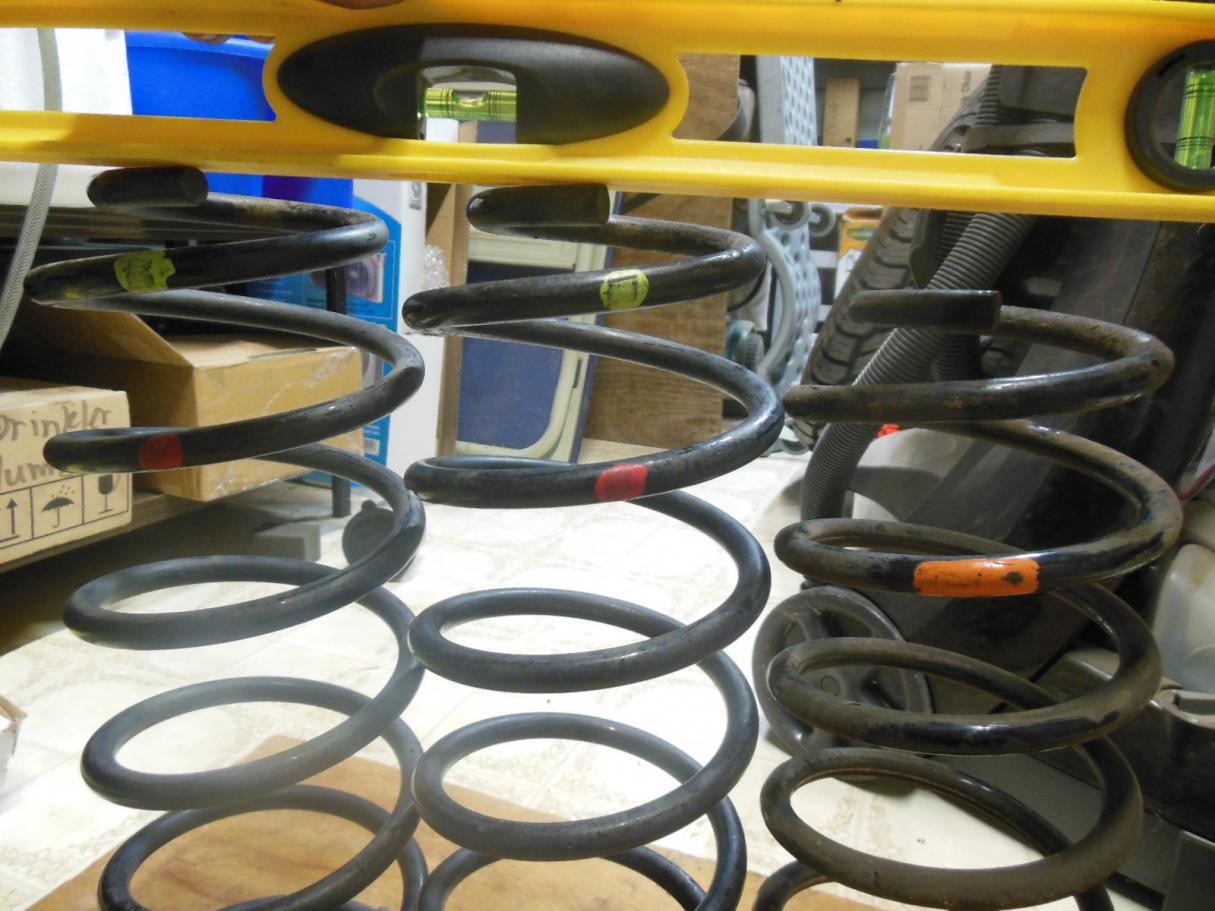

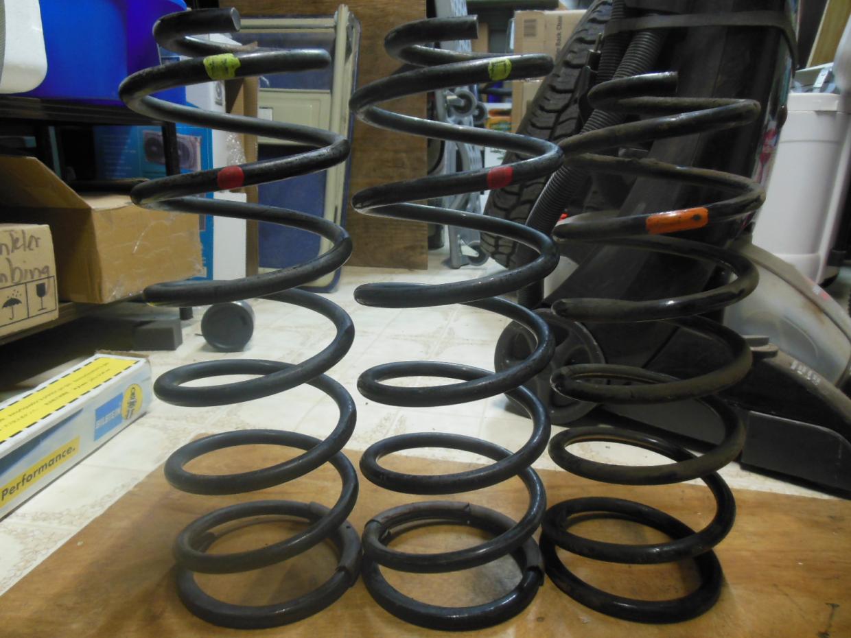

A simple comparison of OEM rear springs with 7.5 turns:
Apparently, there seems to be TWO types of 7.5 turn coil springs.
1) Red and yellow colored (Left two in the pic.): 16 and 1/8 inches
2) Orange colored (right): 15 and 1/16th inches
Diameter: 13.31 +/- 0.08 mm on both

As far as I know 2 types existed. The standard springs and the 99 tall ones. They were one 1 inch higher in the tall ones. Other users can confirm or verify. :)
Sent from my SM-J337V using Tapatalk
That diameter matches what was on my '99 2WD originally. Also same number of wraps. I don't have a free measurement height though. It rode right around 20" fender to hub center all around.
There should be many different springs though - 2WD and 4WD will be different, even in the rear, along with changes through the years in height depending on the OEM ride height that changed multiple times.
