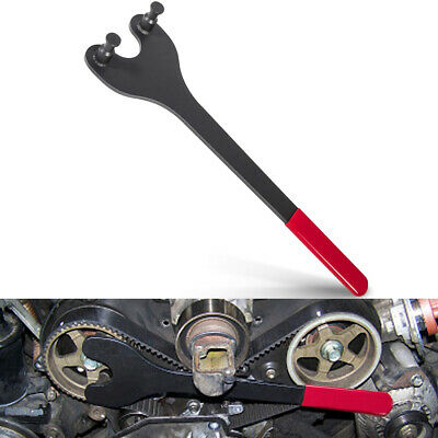

You'll need some way of holding the cam pulleys when re-installing to be able to torque them to spec. I made a simple tool out of some steel bar and some grade 8 bolts/nuts spaced out to fit between the "spokes" of the pulleys.
Thats basically what most mechanics use, this tool. Then a long breaker bar or pipe over my ratchet.
