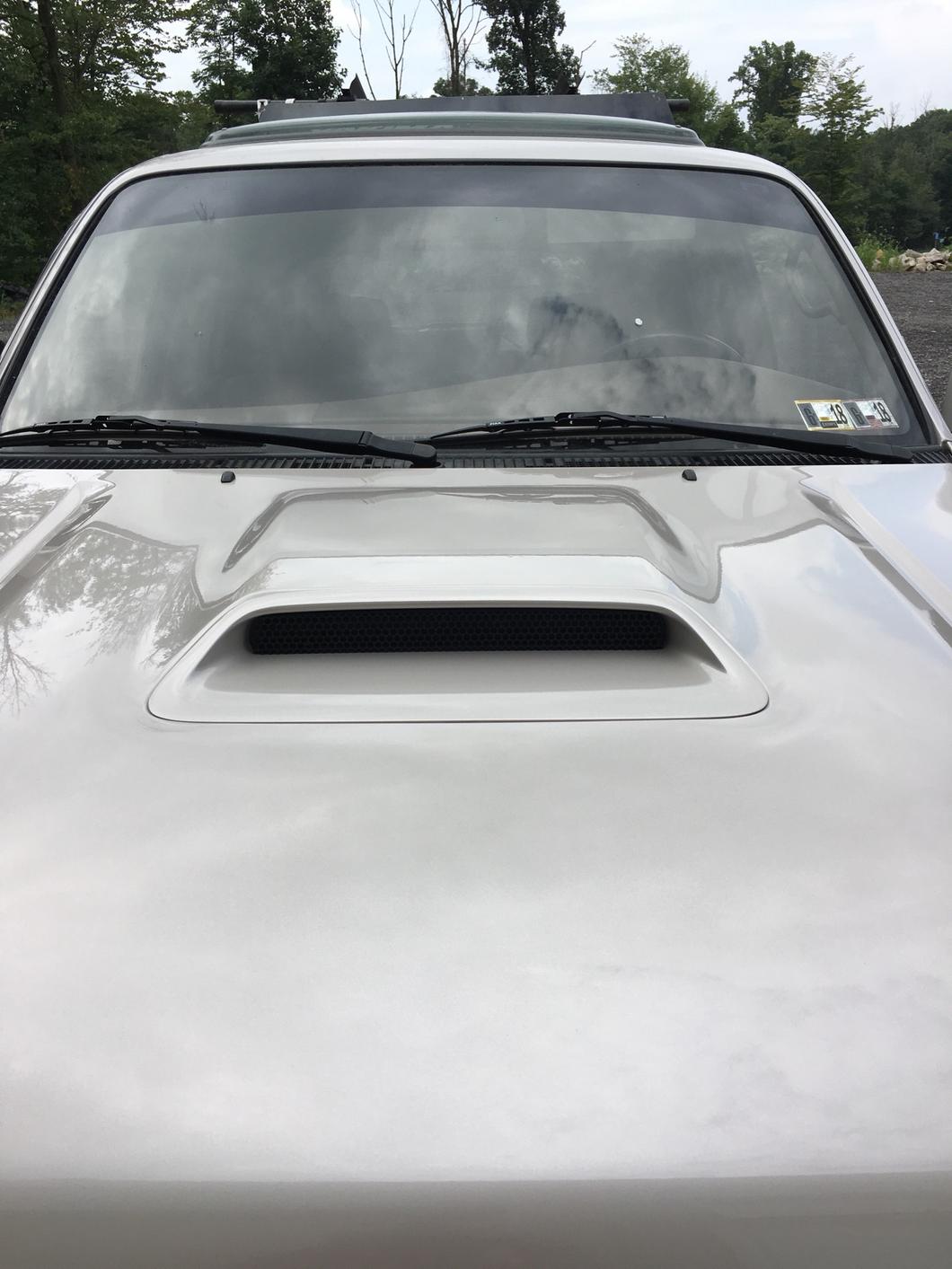

Mine's white, so I had the scoop painted white as well. Here it is soon after the hood came back from paint.
Lookin good!! For sure paint scoop to color match body.
I didn't care for black mesh insert of scoop.
So I chemically stripped mesh insert, under black paint is nice stainless steel
that goes well with Millenium Silver.
