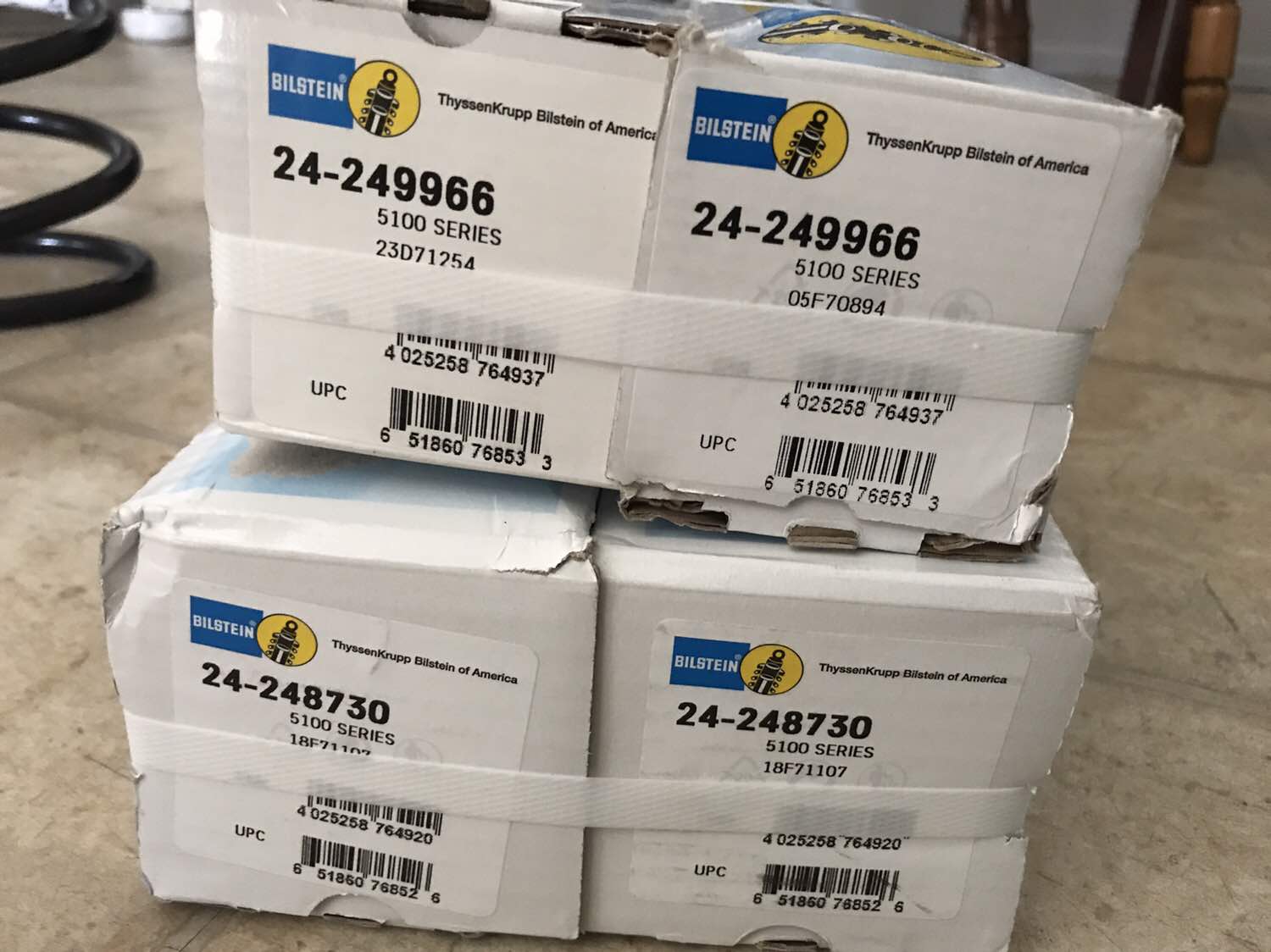

Setting mine up soon. Have '07 Fjs and 4Runner specific 5100s. I'll let you know how it goes

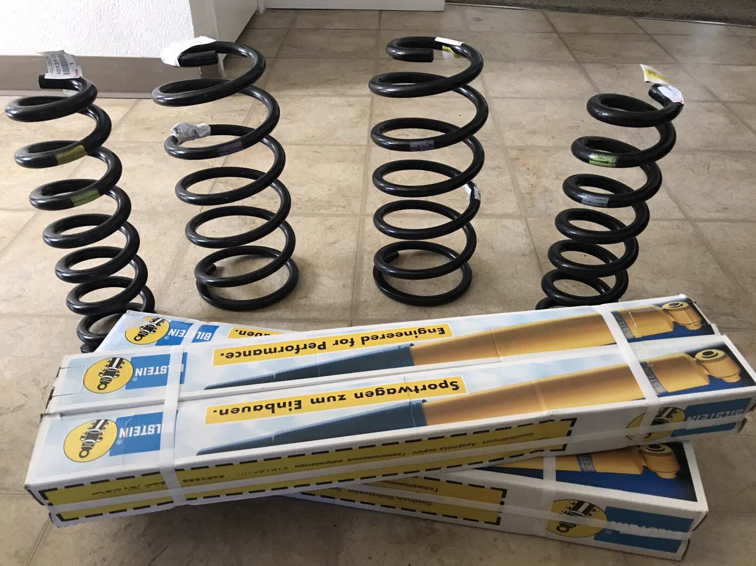

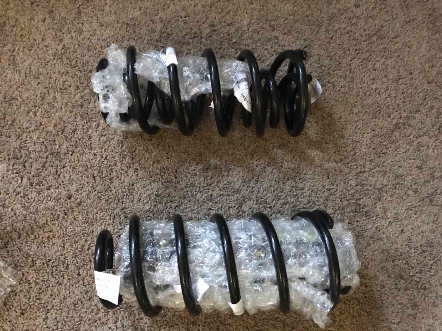

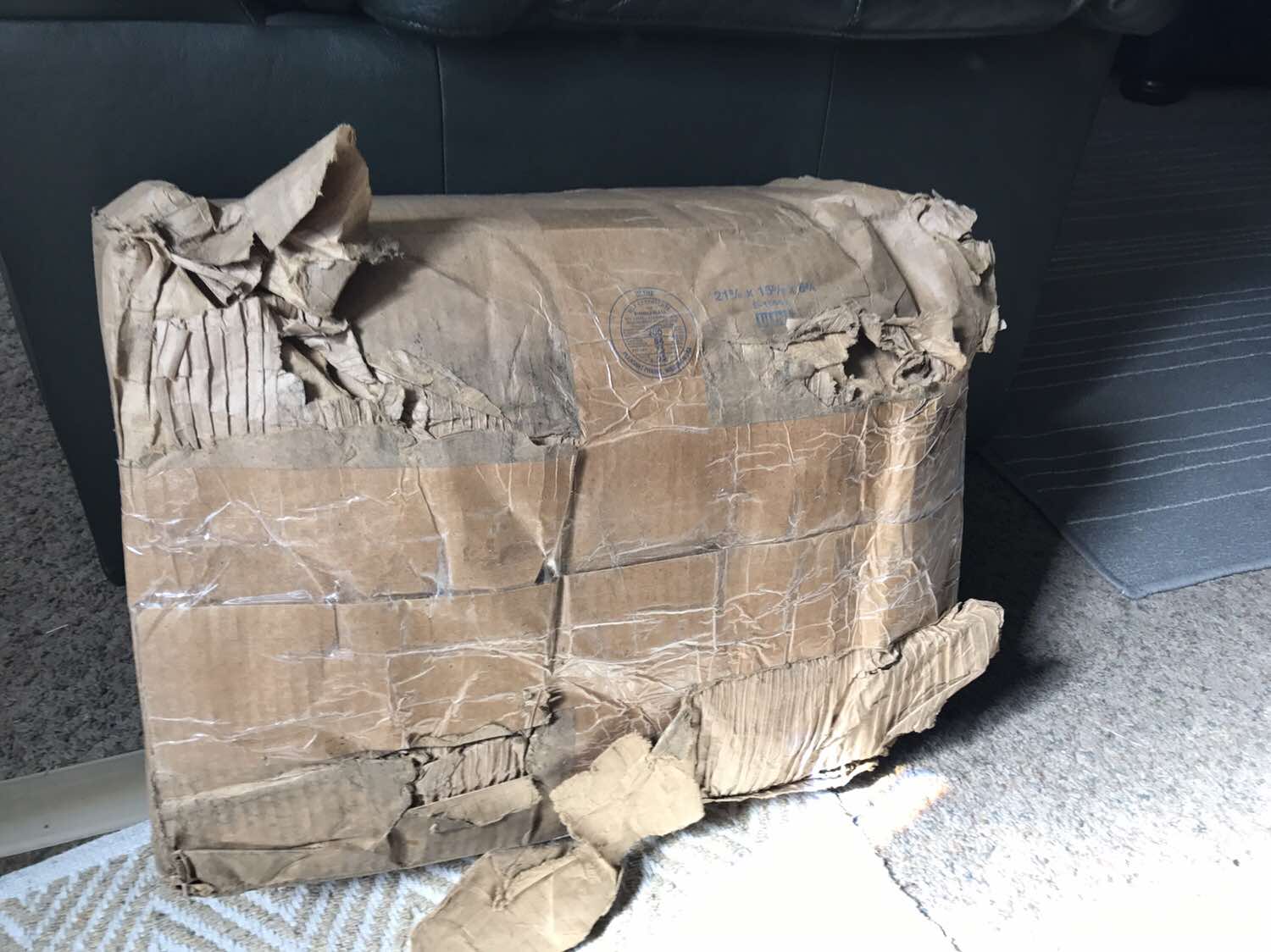

The FJC coils came in today. The box was in pretty rough shape though.
The front coils were packed inside the rear coils.
I am really excited to get these installed tomorrow!
Current setup is with oem coils and Bilstein 4600 shocks and struts.
Before measurements taken with a little over a 1/2 of gas:
Rear left-20.75"
Rear right-20.5" (JL 10W6V2 is on this side)
Front left-20.25"
Front right-20.5"
