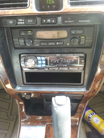

I have the Pioneer AVIC-Z130BT that tilts up from the bottom and I love it. It's a full, touch screen navigation, DVD compatible unit. Tilted all the way up, it's perfect...even in park.
Inspiration...

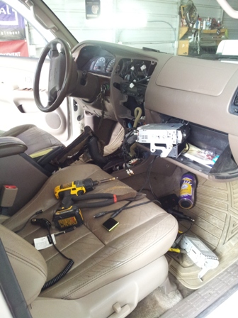

Did mine today. Thanks for the info. Seems like we like the Alpine's
Blue
PS- Stock Unit and Amp are for sale.
