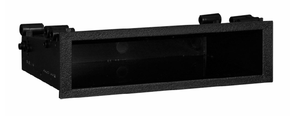

The 88-00-8000Metra pocket kit is a bit jenky, but it bolts up to the factory brackets with the stereo just fine.

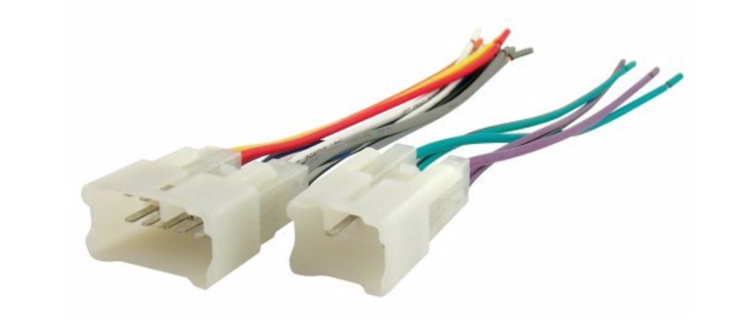

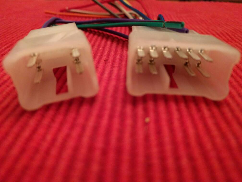

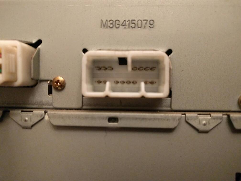

The Scosche harness on the other hand, not so much. My radio has a 15-pin connector that integrates with the factory amp. I intend to keep the amp.
The Scosche harness is a 2-piece set that won't mate up to the 15-pin plug in the car.
So the factory radio went back in.
An additional search on Amazon revealed a Metra 70-8112 Radio Wiring Harness for Toyota Amp Integration 15 Pin - so I've ordered it. https://www.amazon.com/dp/B0002BEUBW/ref=cm_sw_r_other_apa_KVSOxb64KMJQ1
From the looks of it, that harness should hook right up, so in about a week I'll be rocking and rolling (literally) in aftermarket glory.
If you're installing an aftermarket deck, odds are you wont need that stock amp. Unless you bought a deck without internal amplification. If you pull out the amp, you'll find that your existing wiring harness should work with the harnesses that plug into the amp.

Thanks for the info. After reading this I went back out and pulled the amp - low and behold there are the two connectors!
I canceled the 15 pin harness (no great loss at only $5) and I will proceed to wire up the Scosche harness.

Metra Pocket 88-00-8000
Or you can install an EQ/blanking panel. https://www.amazon.com/dp/B00029X1KU/ref=cm_sw_r_cp_apa_Az0OxbR0D150S
Scosche harness TA02B
Assuming you're gonna bypass/remove the factory amp. https://www.amazon.com/dp/B00009UHKW/ref=cm_sw_r_cp_apa_ry0OxbR9C5CTQ

From the looks of your pics, the Metra pocket I got off Amazon is smaller, shallower and has less volume (due to thick plastic walls) than the one in your pics.
The cubby I got from BestBuy, also by Metra, looks like the one in your pics, but its brackets don't line up with the factory radio brackets, except at the rear, so I'd have to jury-rig it the front connection. I could probably just strap it to the radio body itself.
Since I tend to just stash junk in spaces like this, I'm ok with the smaller pocket although, a panel area for an AUX jack and USB input would be handy since my aftermarket stereo can take both, as well as Bluetooth.
