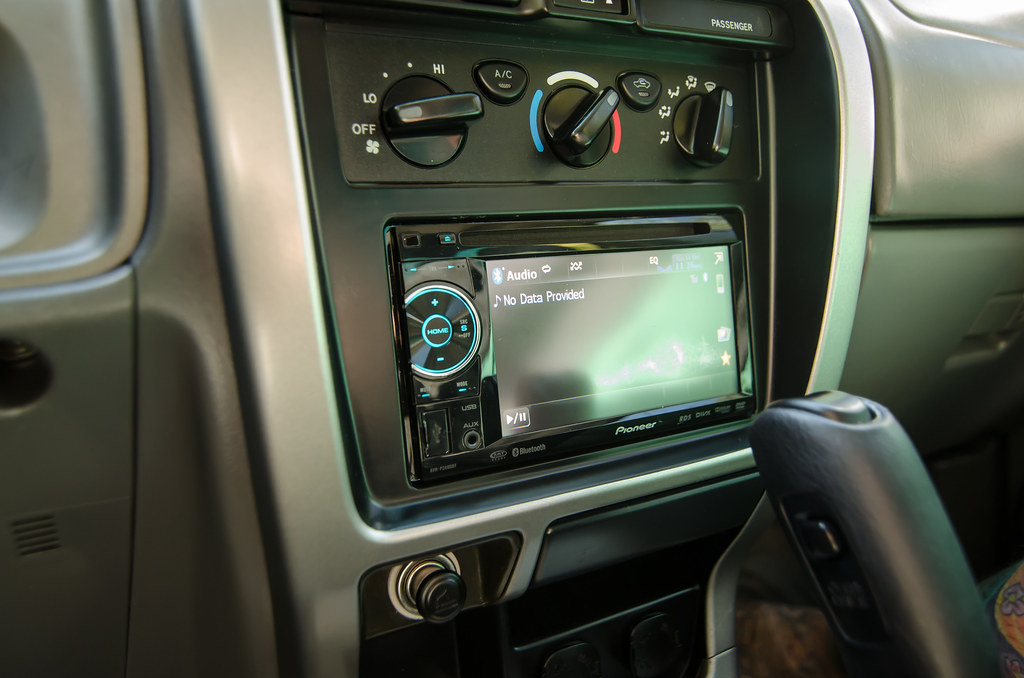

here's my install and i LOVE it.
[Review] Best Nexus 4 accessory ever! Pioneer Car Stereo (WITH DETAILED PICS) - xda-developers
best parts are the hidden glvoe box USB (32 GB stick plugged in right now)
..the $20 IR steering remote..
..and the really good mic for taking hands-free phone calls

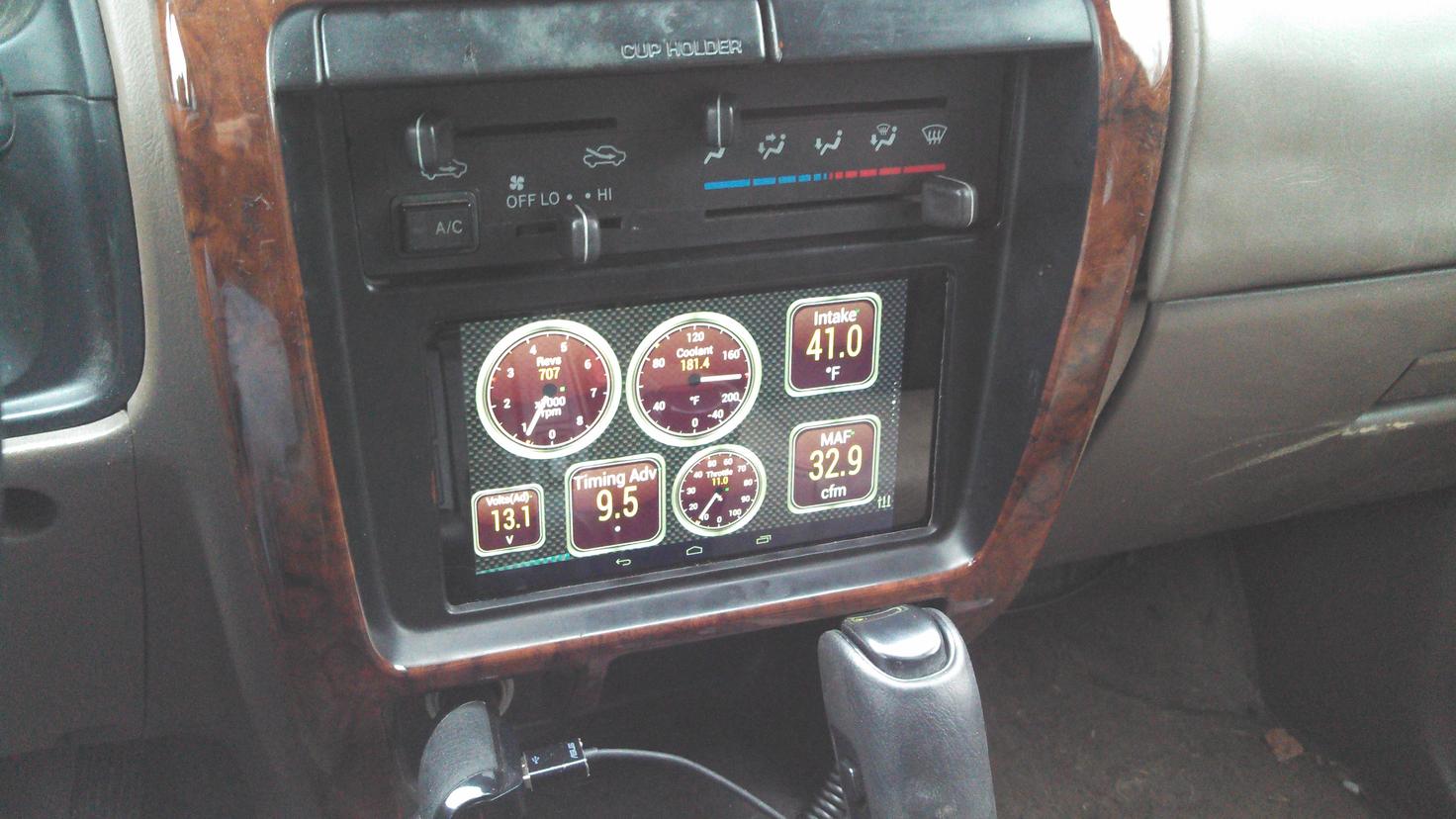

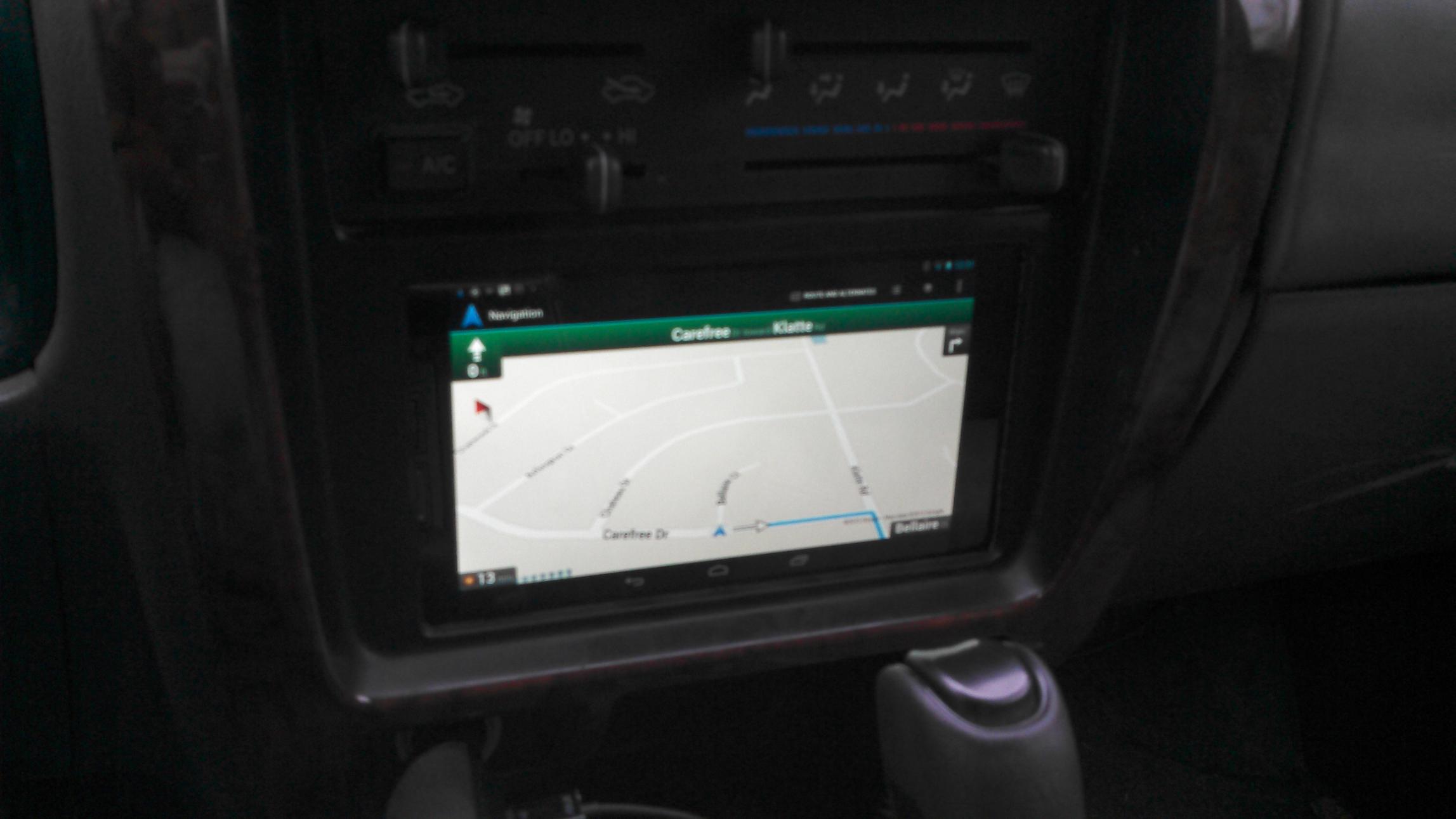

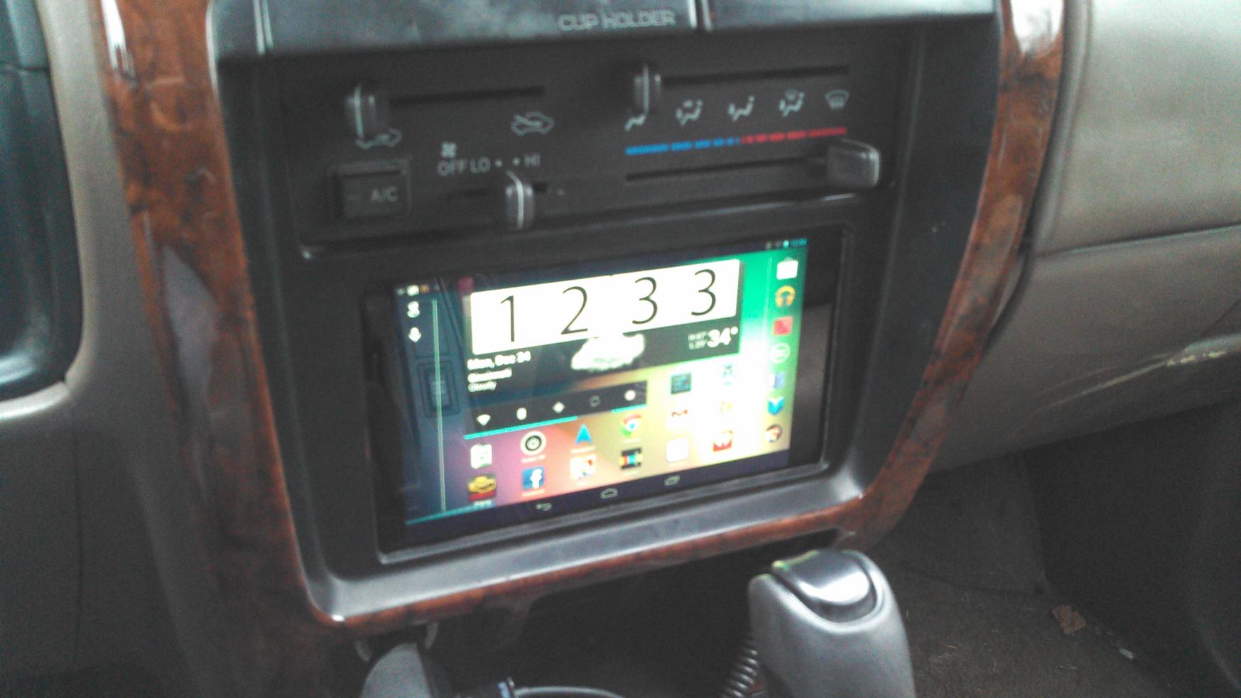

Better than a headunit :) Nexus 7 tablet.
that is nuts!!! i just bought my brother a nexus 7..is there an advantage to installing that over say an appradio and using ARliberator to mirror the phone screen onto the appradio?
do you have the 3G version so you can stream pandora and navigation? (you must based on this pic..)
did you just hardwire the power?
does it come on when you start the car?
what about music quality? does it function like a head unit to drive subs/amps/speakers?
ANSWER ME!! I MUST KNOW IF A $199 ANDROID TABLET is the holy grail of 2-DIN headunits.
Holy S .... Adam F how did you do that?
Post more pics please, especially how you mounted it and what audio out you are using.
