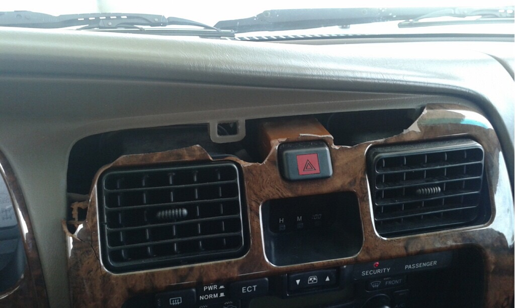

No problem. I'm sure I don't have to tell you, but be careful removing the bezel. 15 years of life in and out of the sun tends to make plastic brittle. This was the outcome of the dealership fixing the antenna on the 4Runner that I bought for my sister 3 weeks ago.
This seems to be more of an issue with the woodgrain parts. I have the black plastic and it's still very sturdy. I've had it in and out at least half a dozen times in the last two years.
I had never seen it before either. I don't know how many times I've had mine out over the years. This was the dealership we're talking about though. Just to show you how shitty the dealership was, they said they would only pay for 1/2 of the bezel...which was around $550. Had to fight them on it.
Damn.... that sucks. It would make me especially pissed knowing how easily that thing comes off. They must have had a gorilla doing the work.
Lol, I know right?!! They only tried to pull that crap because it was my sister who took it up there. They would've had a hard time pulling that crap with me.
Wait what?! They did the work and then said you have to pay for half the damages? Now there's a quick call to Toyota national filing a full on complaint. Let me guess, they tried to say age was a factor? Time to find a new dealership (or better yet a good independent Toyota mechanic).
