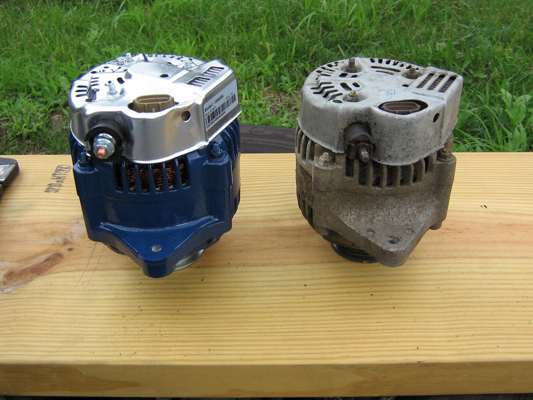

I ended up going with a Quality Power HO Alt. 160a
Bolts right in, no mods needed. (unless you want to paint it) :yo:
