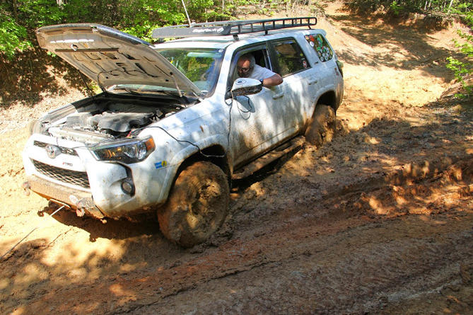

It's amazing what driving 1.5 miles of dirt road that rig traffic has ground down to 3" deep silt will do to coat a clean vehicle.
at least its not Carolina Red Clay. i have to got through that crap everyday haha:crybaby: sweet rig by the way. i got a trd pro and that hidden winch system you have is giving me some ideas:tongue:
True. I get that at Barnwell Mountain in Texas. :becky:

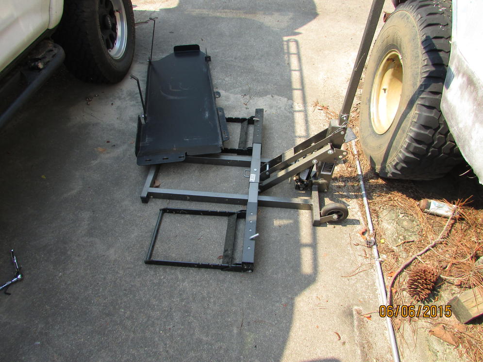

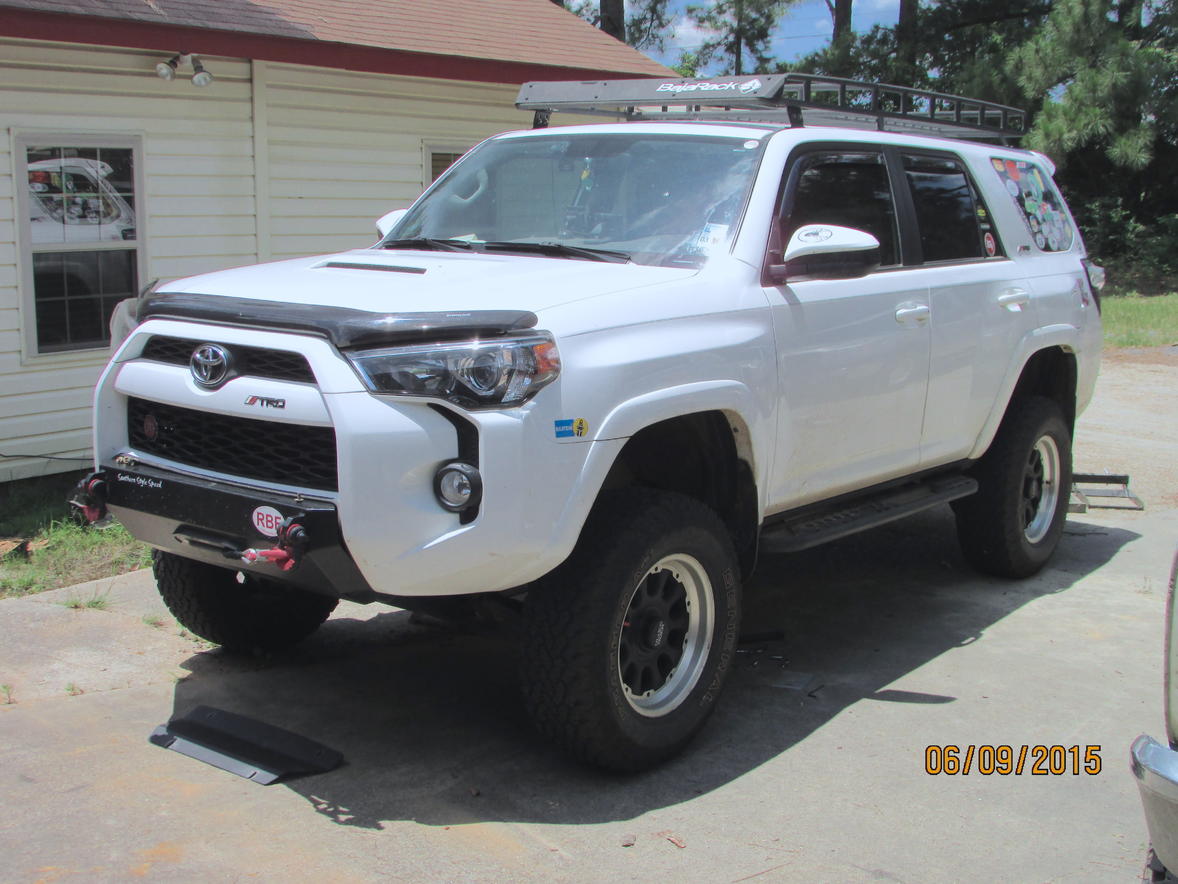

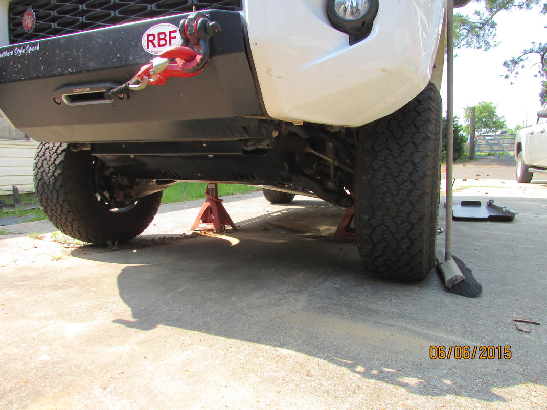

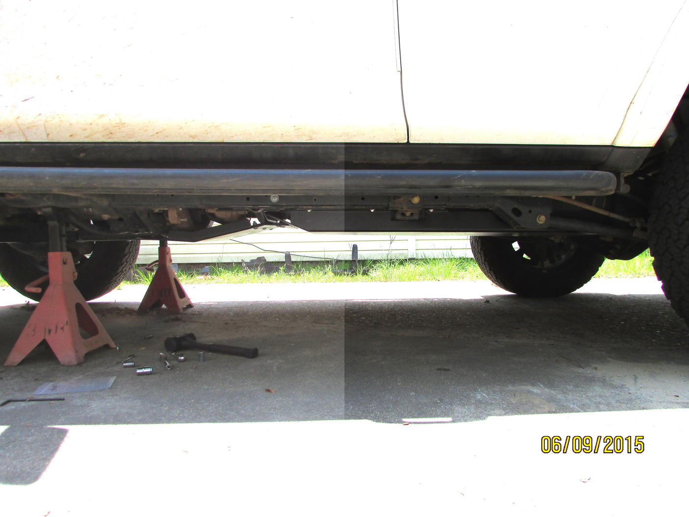

Almost exactly 1 month to the day after my trip I finally got around to installing the Budbuilt skid set [MENTION=102206]IAmTodd[/MENTION] so kindly sold me. The front 3 plates and crossmember were fairly straight forward. The front filler plate won't fit with the SSS bumper, but the gap is so small I'm not worried about it. Please note the "custom" stenciling on the jack stands. A left over from my roundy round racing days.....

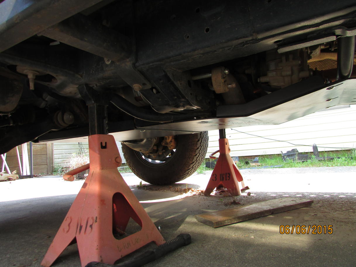

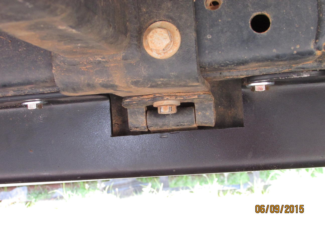

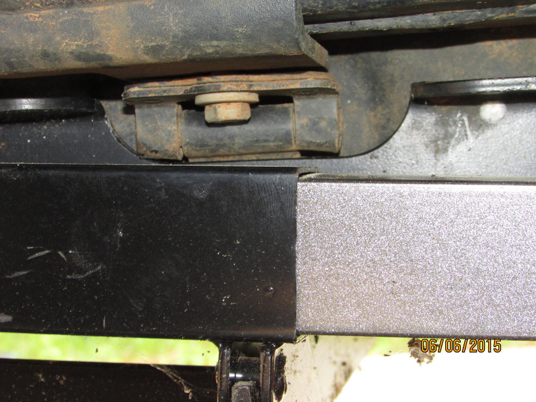

But when it came time to install the gas tank skid I ran into a problem. I did find a good use for the lawn mower jack we bought last year. But when I got it lifted and started on the bolts I found out it wouldn't clear the front gas tank strap bracket because of the previously installed Shrockworks sliders. I'm going to make some calls on Monday and see if I can find a business with a plasma cutter in my small town. If not, I'll have to get some cutting discs and do it the old fashioned way. I'm just going to deepen the notch another 3/4"
Glad to see you got them mounted and and that they're going to get some use! i recall there was a spacer that was to be used if the Shrockworks sliders were installed. Since I never installed them I'm not sure how it fits together.
That may explain the 2 flat brackets in the part box. I'll look into that also. There were also supposed to be 2 spacer plates where the allen bolts go in the cross member that I didn't get and Budbuilt didn't include with my order. So I need to talk to them again anyway. But thanks for chiming in. :cool:
Yup. The 2 flat brackets are spacers for the gas tank. But I think I'm still going to cut some. Even having those I think I'm still lacking 1/4" from getting it flush.
Got the gas tank skid in today. I had to trim another 1/2" or so out of the notch around the forward tank strap. Otherwise it was just time consuming as a one man job. The right trailing arm mount on the frame had some minor dings in it. I guess that will be next to armor.
I love this stance. It's a shame it will go away after I take the jack stands out of there........
