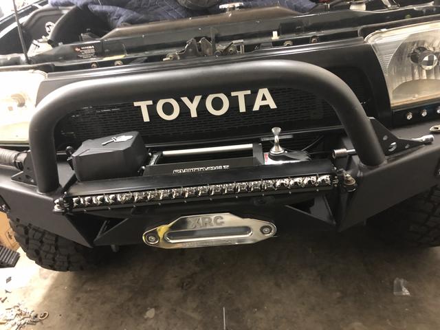

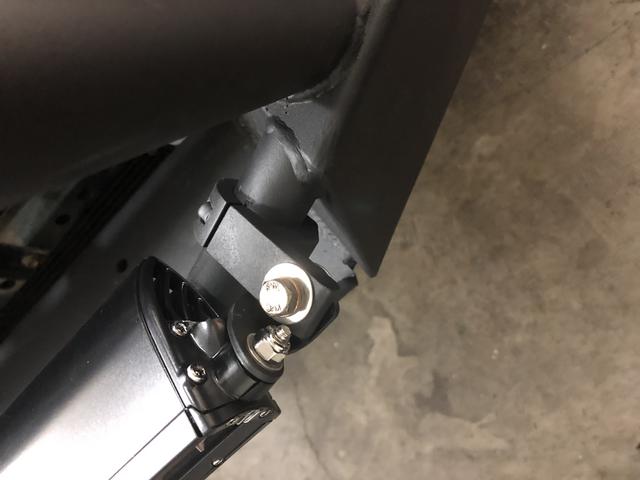

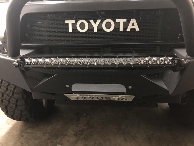

Remounted my 20” light bar, it was worth paying the 10$ for these mounts they are super sturdy. Got it right where I wanted it too. They supplied rubber to put between the bumper and the mount and I couldn’t get it to fit with the rubber but without it fit perfect.

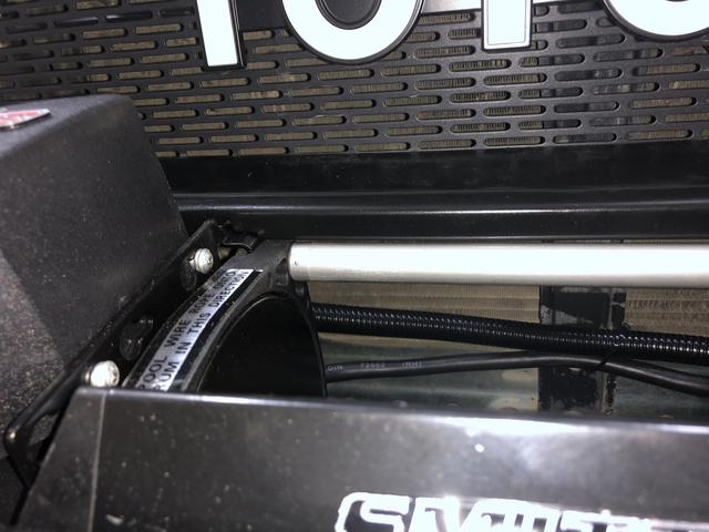

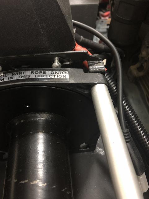

Right after I did this I decided to start installing my winch, of course the light bar was barely in the way so I had to rearrange the mount just a bit. Turned out good though. Still need to get the synthetic line wrapped in..
Had to clearance the mount for the control box on the winch a little..
Also had to clearance the grill just a tiny bit.
Looking really good! It's really coming-togther so nicely...
Did you have to remove the bumper or loosen it up a little or remove the grille in order to install the winch?
I seem to recall reading that we need to apply 1,000 lbs of tension when spooling the line. What method do you plan to use?

Thanks man! Just had to remove the grille.. like 15 times lol.. kept trimming a little then needing to trim a different spot, but in the end it fit together nicely.
Yea I read that too, not sure I’ll probably find a big tree somewhere near my house and throw my tree strap around it.

If it’s completely open on the top of the bumper then you should be able to, if it’s closed in at all you will probably have to remove the bumper. I’ll probably just do it on a flat section but have my wife slightly press the brakes while doing it and that should be good enough. I watch some of this guys videos Ronny Dahl on YouTube, really informative on recovery gear.

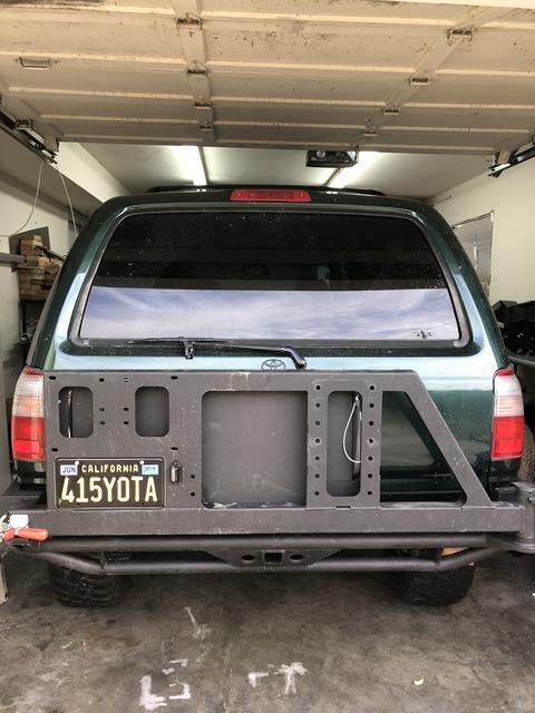

Got my custom plates picked up yesterday finally..

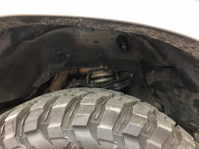

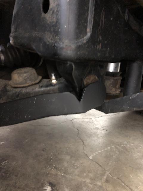

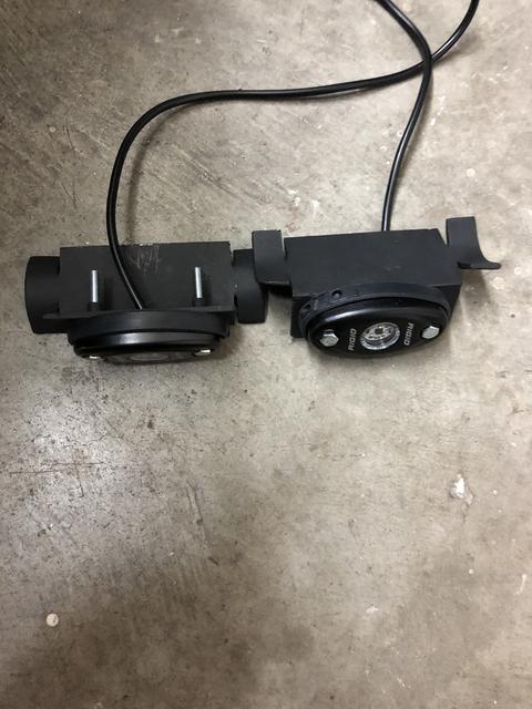

I also got my synthetic winch line wrapped on the winch w/ factor 55 (not under load), trimmed and reinstalled LCA skids, rivnutted my license plates, and started installing the rigid rock light kit..

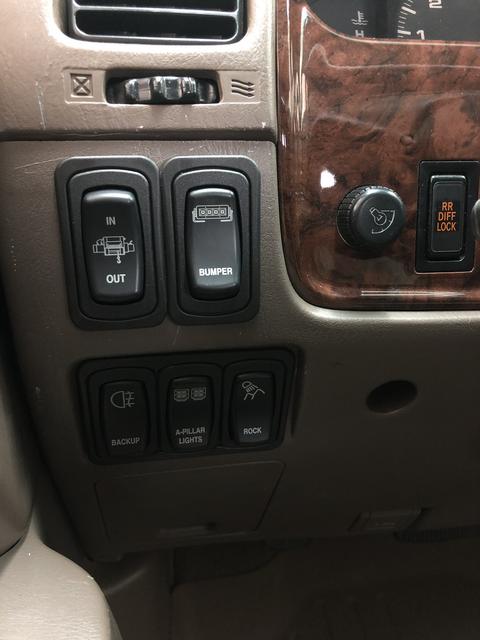

Kept pretty busy this weekend. Almost done with the rock lights, trimmed my LCA skids a bit more, made a light for my camping table, and installed a couple more switches in the dash.
Front rock lights
Middle rock lights
Rear rock lights (mounts to the support bar on rear bumper)
Switches

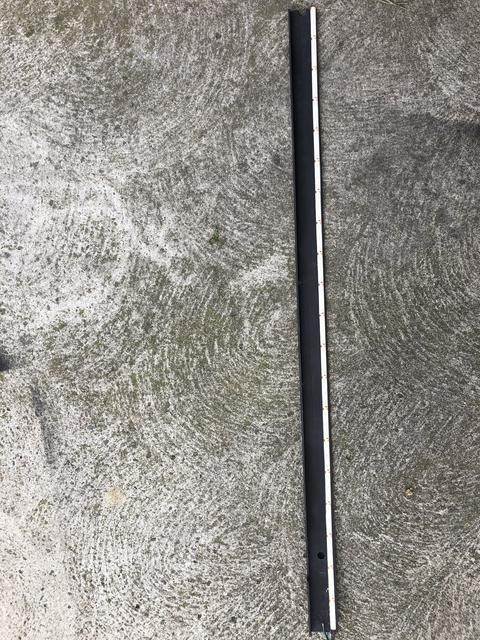

Notched the skids quite a bit they are still really close..

Learn something every day! Was not aware of the term "rock lights", but makes sense. Funny, on one of my FJ40s, I had actually cut holes through the floor for improved drainage and one for a piss hole. However, I now remember shining a flashlight through holes a couple times to better see the what was holding me/us up, or getting hit...
Like the lights and switches! Also, surprised "415YOTA" was still available.

e-brake in neutral and you can do it by yourself. You will need to get some number of wraps on the drum with minimal force on the line first.

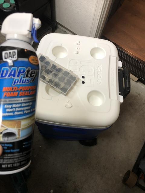

Oh yea I did some sic cooler mods too! Lol.. figured since the top was hollow a bit of spray foam insulation might help keep ice for an extra day or two.. going to use these solid grommets to cover the holes. Didn’t want to spend a bunch on a yeti when in reality I want an ARB fridge/freezer so I’m using this temporarily..

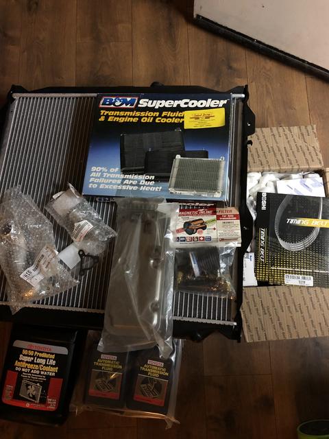

Been collecting parts for the trans cooler/radiator/timing belt/trans filter etc.. now I just need to get around to doing it. I’ll probably wait to do it after I move at the end of February, I’ll have a decently larger garage.

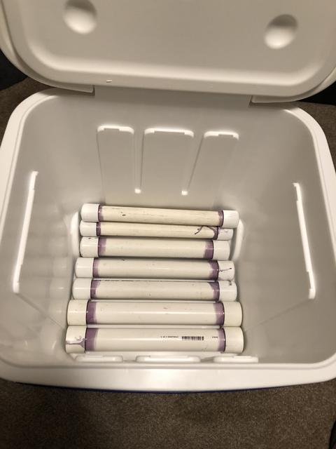

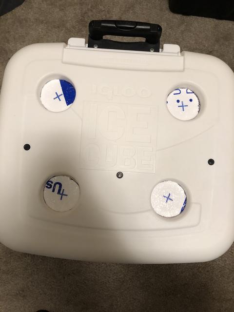

More cooler mods lol.. Filled the pvc tubes with a salt water solution that will stay colder longer than regular water. Then I’ll stack ice packs on top of those. Also put pieces of foam board into the cup holders because I could see light through the lid of the cooler..

Salt water, huh? Makes sense. Learn something every day...
