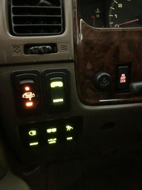

Been running wires for the past week, I’m remembering why I don’t like wiring lol.. anyways saw a video on YouTube today that I thought was pretty interesting, I guess the elocker button comes with a bulb installed but no wiring!! Ha! So I’m going to wire it up to turn on when I turn the headlights on with the rest of my switches..

I want to say the Tacoma uses the light, but am not certain about that. It was easy enough to do, I added the pins that I needed to the connector from a washer on/off/momentary dash switch I'd nabbed out of a 2nd gen at the junkyard, they're small pins. Hopefully you get more wire than I did.
insert pins from wherever you found some:
Nice! Thanks for the pics. I have a ton of pins from the rear hatch I replaced, just pulled two with 3’ tails. Also the aftermarket alarm that i ripped out left a connector from the dimmer switch that I’ll use to light my switches, worked out perfectly.
It does. The switch has the Tacoma (amber/red) back lighting, so I guess Toyota didn't want to make a second part number with the 4Runner (light green) color to it...
I think its weird that plug is there behind the dash, even on my 2WD 4Runner, along with the plugs for the Locker ECU...
-Charlie
Probably would’ve cost more money to design/produce a new wiring harness to save a small amount on materials lol.
Actually I’m kind of glad it’s amber cause I couldn’t get my winch switch with green had to get amber, so at least there will not just be one amber switch on my dash haha.

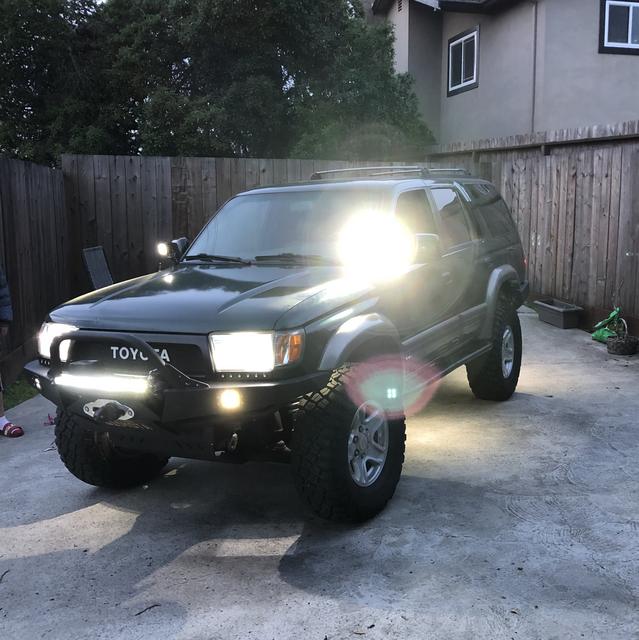

Wow it feels good to be done with the majority of the lights.. Still have to do under the hood lights, rear/backup lights, and a light for the table on the cbi swingout.
It was a lot of work but I took my time and I’m pretty happy with how it came out. The top light in the switches come on when you turn the switch on, the bottom light comes on with the dash lights.

Very nice. Congratulations! Not looking forward to that project one bit. Happy for you that you got it done.
What's next up for you, those other lights you mentioned, the winch?
Haha thx. Yea those other lights and timing belt/trans cooler/radiator/trans filter. The winch switch is all wired up too, I still have to wrap the line better though.. Will probably be getting an awning sometime soon.

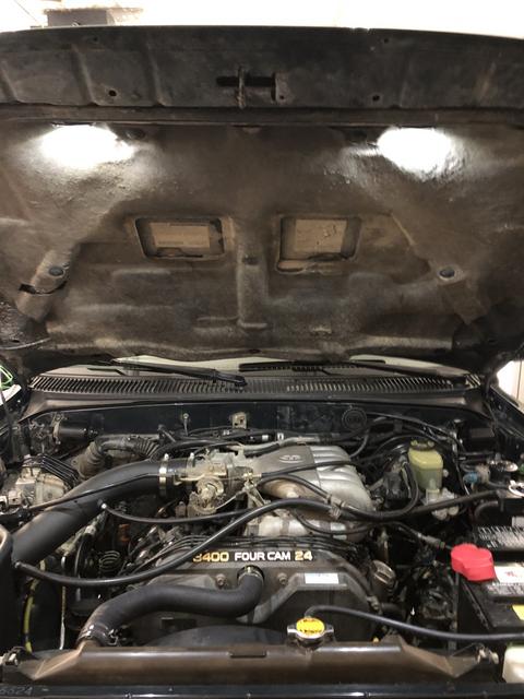

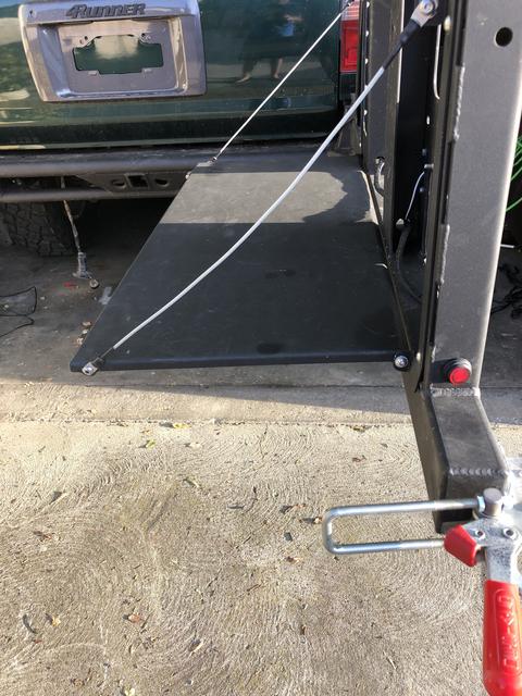

Well now I’m really almost done with all the wiring, got my hood lights 99% wired up and my camp table lights wired.. Also almost forgot about my license plate light! Going to have to look at new trailer wire harnesses because I don’t think mine is oem and I can’t figure out which wires to tap into..

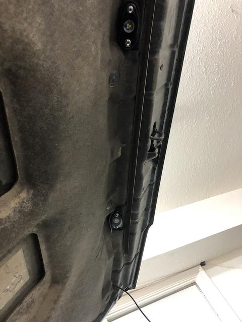

Very nice. Apologies if I missed it, but what lights did you use in the engine bay?
Thanks much. Got them in the cart (saved for later). Not bad for four. Do the two lights up the engine bay well?
Ah, these are those "rock lights"...
They are surprisingly really bright, definitely will use it all the time when working in the engine bay. Was worried they would hit the top of the radiator but they fit perfectly.
